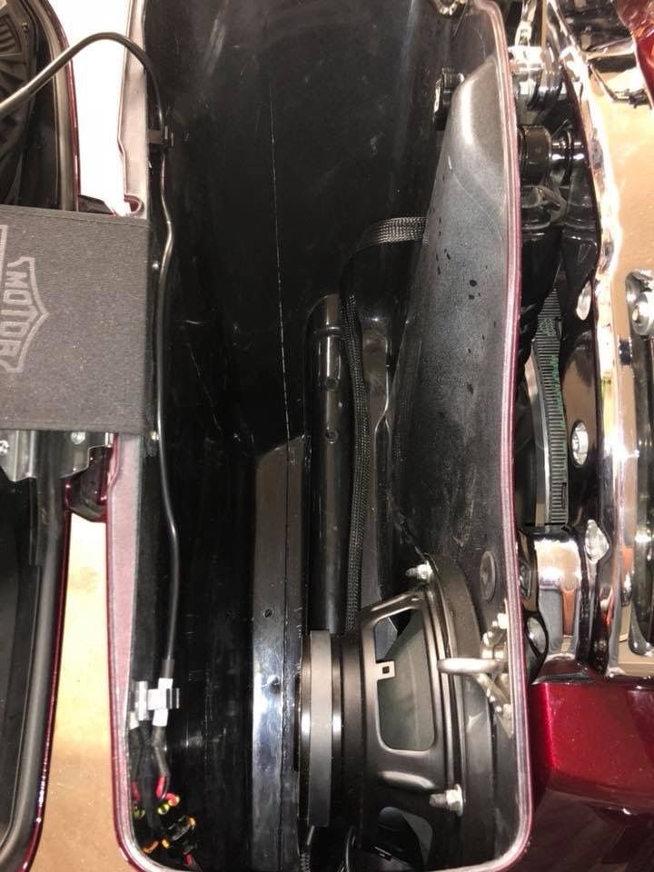

Hers my 8s at a little over half volume. A little echoey as I had the garage door closed
use ear buds

sounds great, nice install,

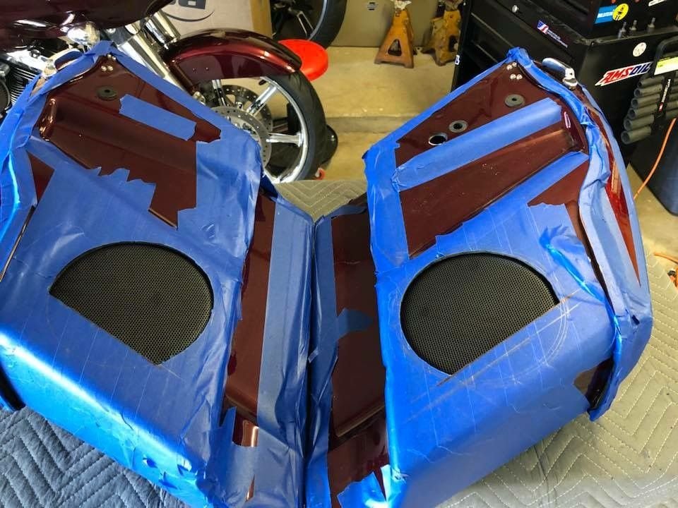

IMO the best way to do it for sound quality, and ease of install is to mount from the outside and seal it. This is an 8" setup we did a month or so ago.

Lucky,
Awesome work man looks great. Is that box a specific cubic foot for the speaker that was used or did you make it as big as possible and to just clear the 6x9 in the lid when closed?

Originally Posted by screaminyz
Lucky,
That one was made specific for the 8" Speaker.
