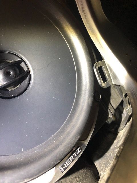

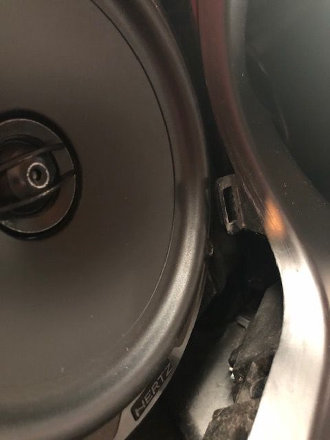

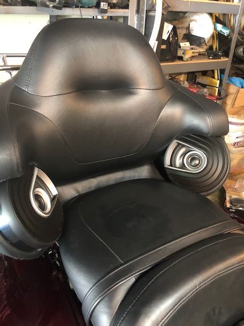

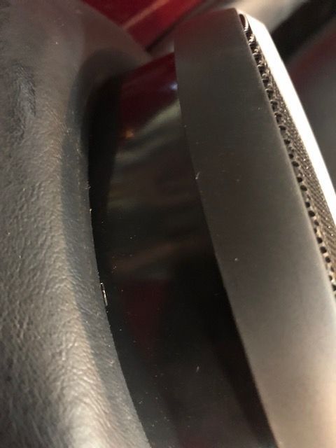

Just installed the speakers, used spacers in the tour pack and removed the rubber around the magnets on the hertz in the fairing. I’m a little concerned with how close the grill mount bracket is to the speaker but it seams to clear. Hope to start under the fairing tomorrow. [img]webkit-fake-url://5d2f50e2-6fa3-4754-9f74-7fca5c605a57/imagejpeg[/img][img]webkit-fake-url://f4133e37-033a-4700-95c4-799aaacdce28/imagejpeg[/img]G[img]webkit-fake-url://4f345c9e-6c11-4eaa-aece-b1e8b8e1469c/imagejpeg[/img][img]webkit-fake-url://83a397e9-227f-4577-807a-83f8c3aa3edb/imagejpeg[/img]m

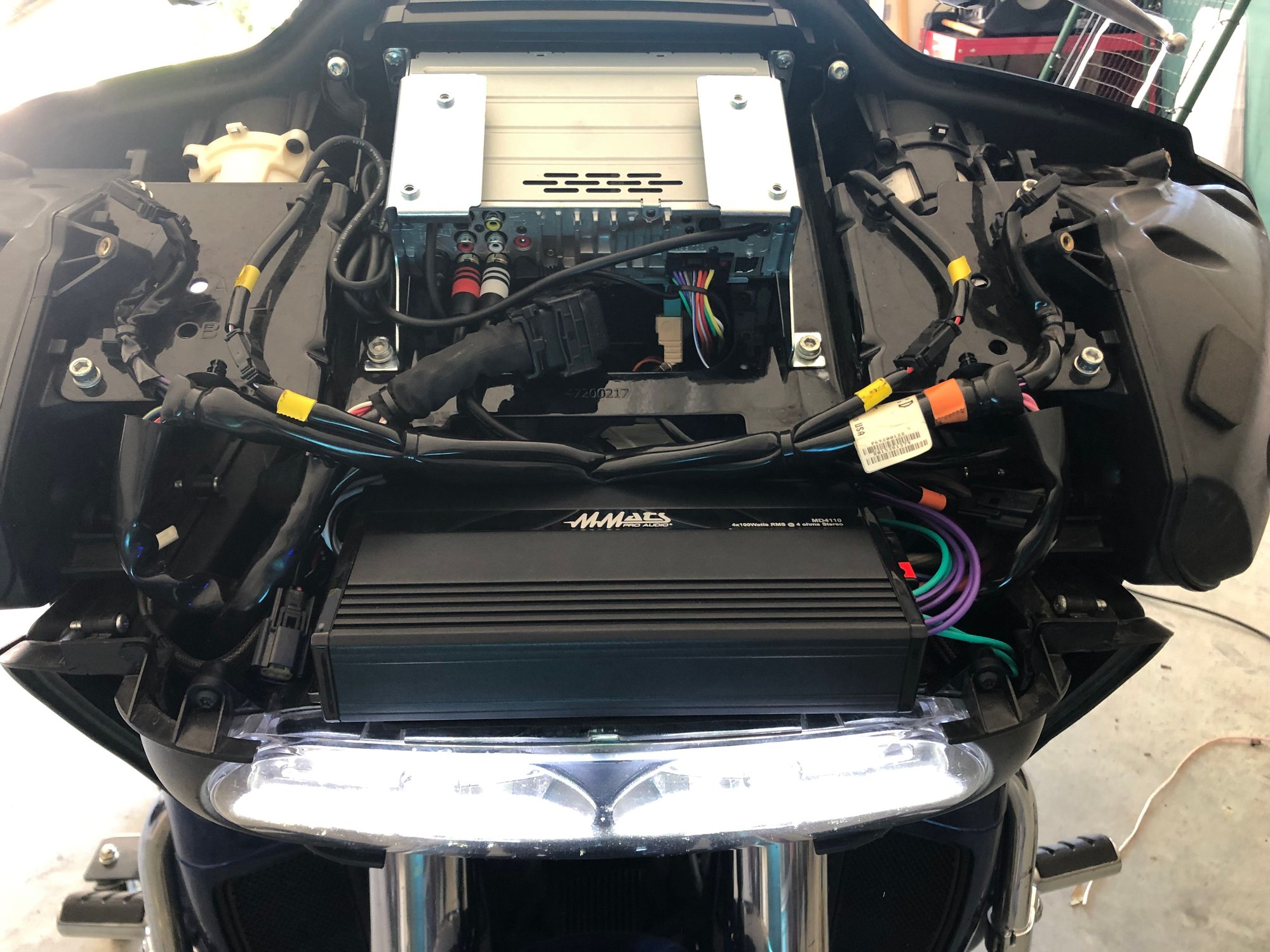

Just removed the fairing and head light, so question is for my amp mount. Do I have to remove the head unit.? And then drill and mount to the head unit bracket or do I need a separate amp tray

The Biketronics breakout harness basically allows you to use your stock speaker wire if to the rear. The LLs go between your head unit and amp. I did not need an amp mount fo the MMats amp. You can probably get it on top of the headlight. You may have to shave the tabs of the top.

eggwhite93
thanks for the information and picture, did you use a hook and loop type fastener?

Yes I did.
