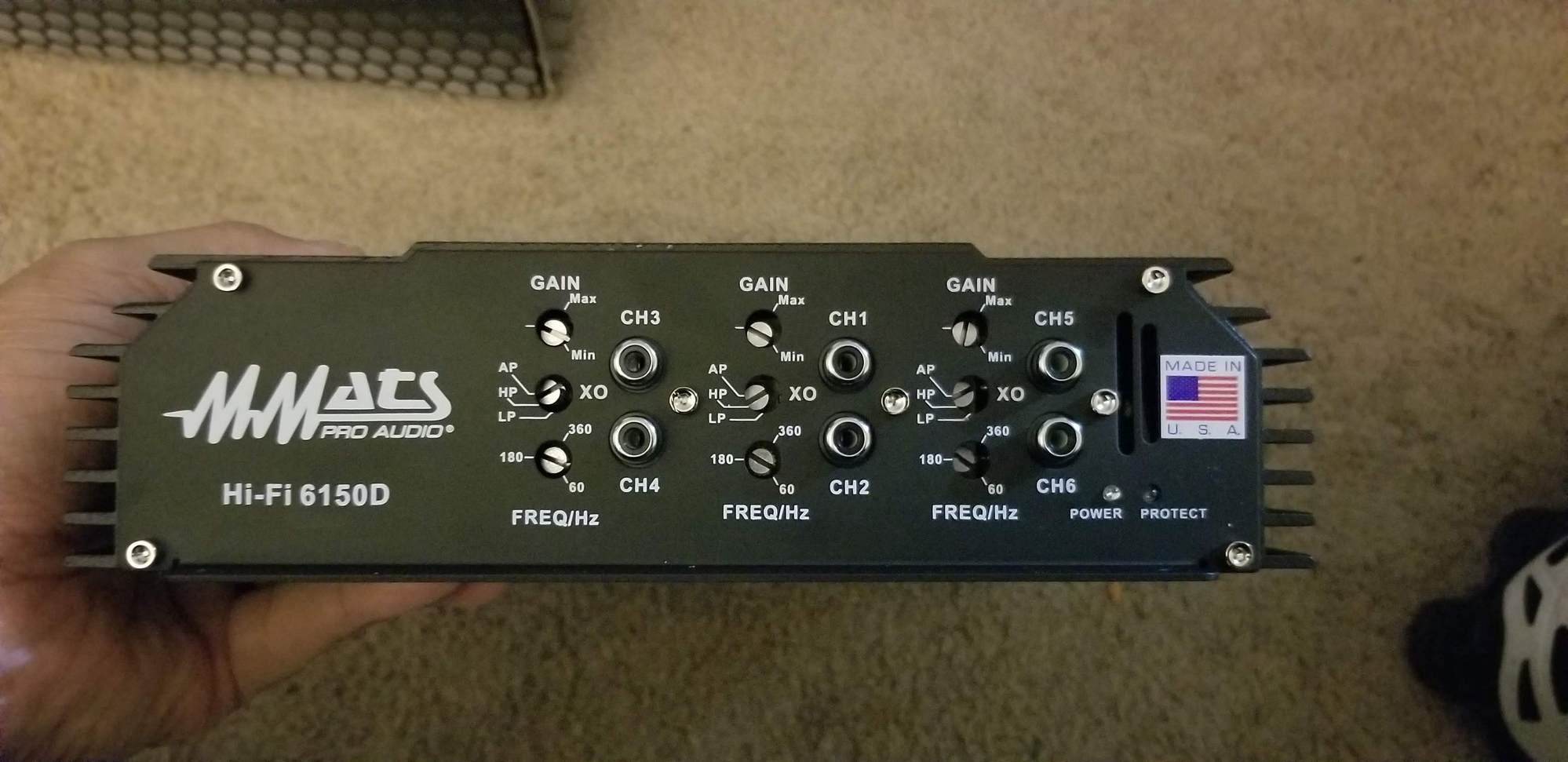

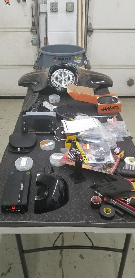

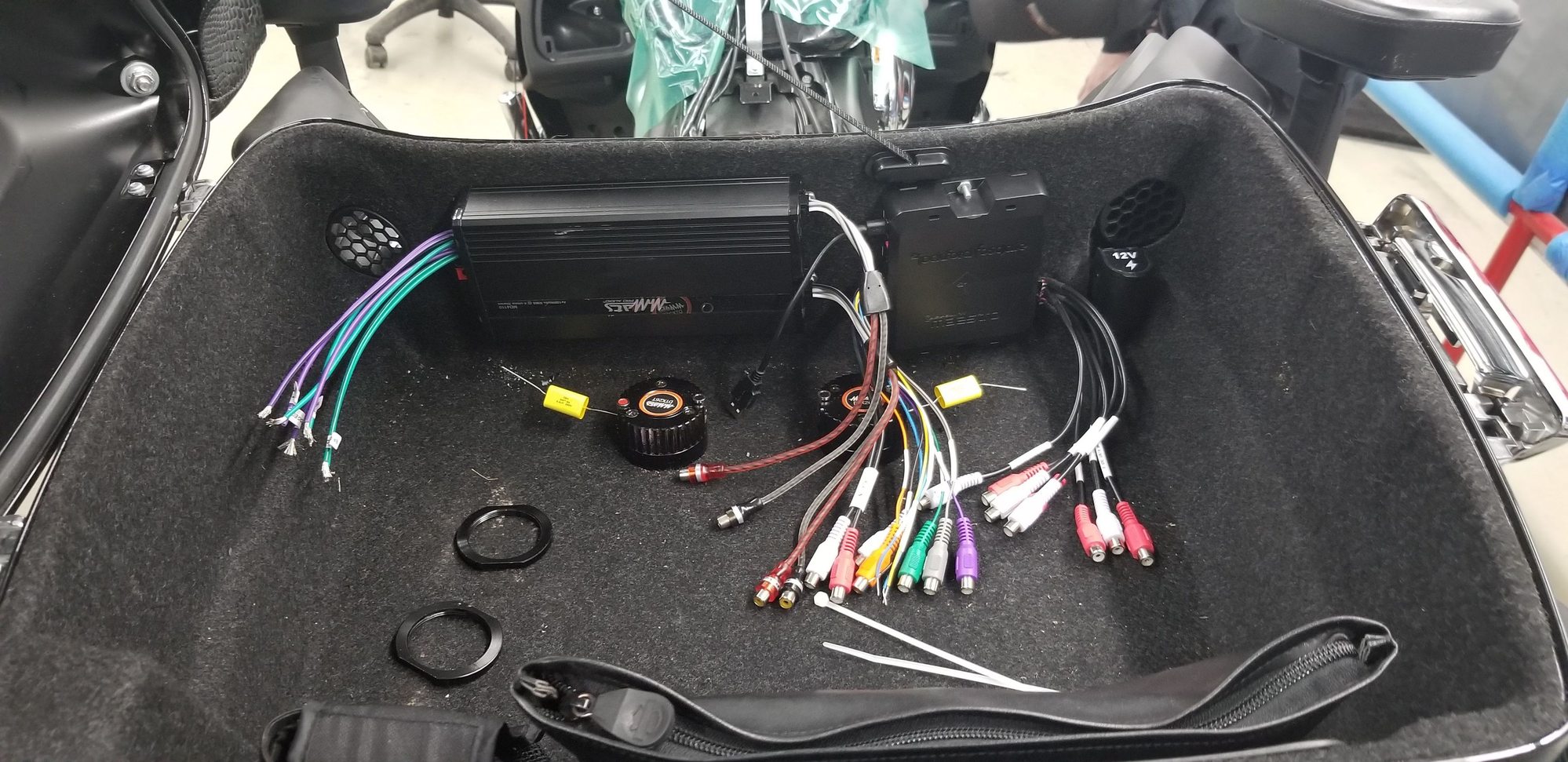

Just getting started on winter project..kinda of an extension of a couple of previous installs.. still a mess so be kind..lol.. upgrading to Sony 5000- shimmy cover
Fosgate DSR Beyma tweets, the rest will be MMats 6.5 PA fairing 6.5 coax lower and TP. 801s in both bags 3 amps 2 4110 and 1 6150..upgraded to a Stinger 675cca batt

That's is going to be a dynomite build drummer! I am interested in how you like the 6150...is that it mounted in your TP. I saw a picture of one in one of Haze's bikes and it stuck up over the lip of the TP! If not in your TP then where are you mounting it?

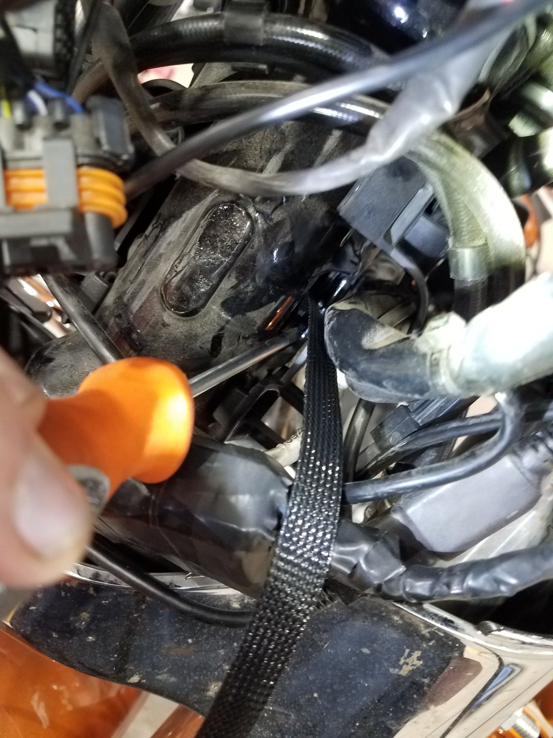

Found a wire tunnel through the frame.
Went through the frame on the clutch side at the neck bearing.
Pointing at the hole.
Exit on brake side right by the battery.
Enough room i ran 4 sets of 12 gauge speaker wire through it.

thanks Mike
Excuse my primitive art skills but this is where 6150 is going
relocate 4110 to side...i will try 2 4110s in fairing but so far its a no go unless i start cutting or eliminating something

Awesome find Juice. I'm going to ASSume that's a Rushmore thing. Sure would be nice if that existed on my '07, but I don't remember seeing anything like that under the seat.

Not sure, I have a 16. But, the last major frame change was in 09 I thought. But, on my 09 I remember there being a zerk fitting for grease and this one does not have a zerk fitting?
