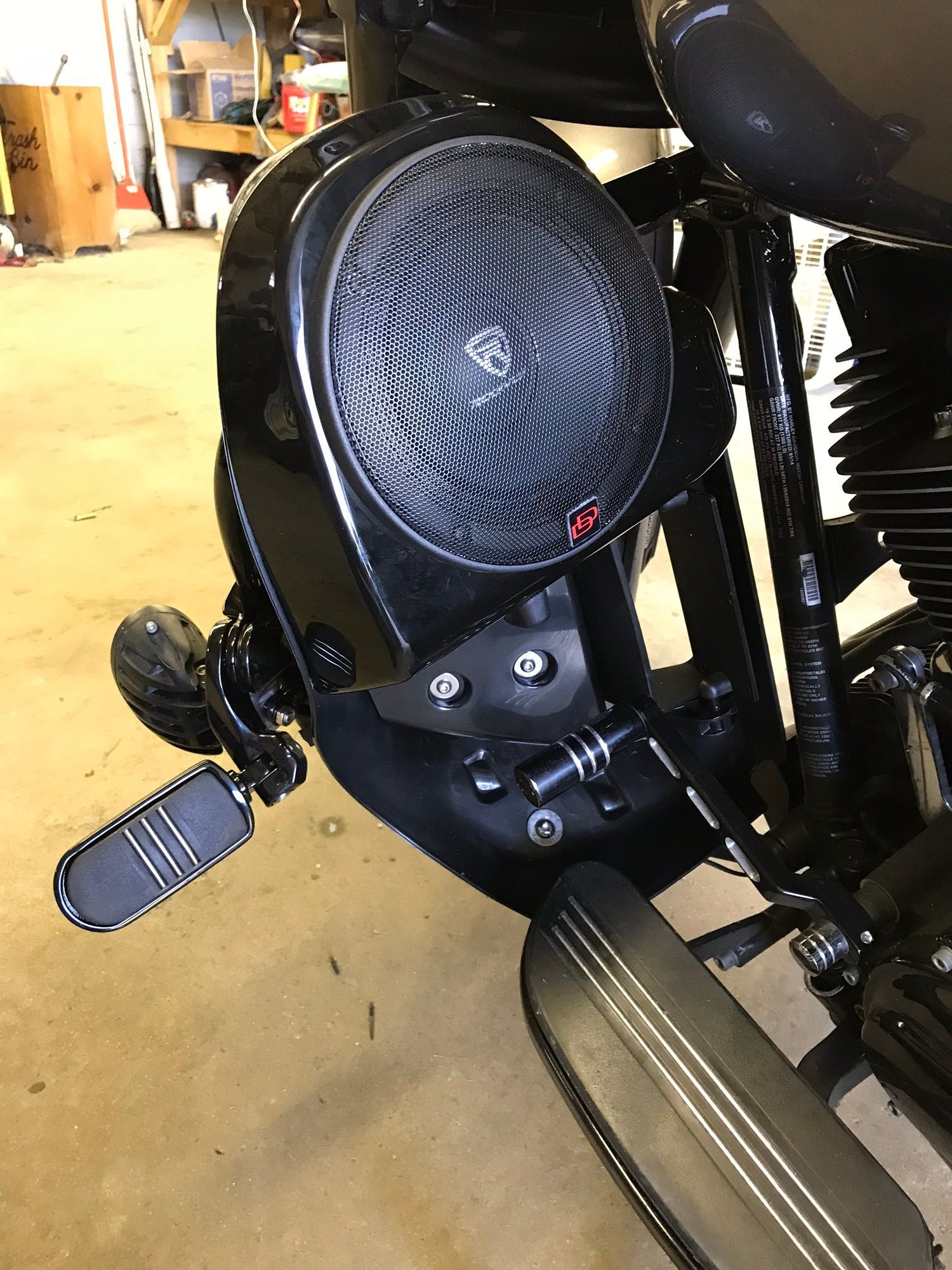

So o finally got the lower speakers installed...no screwdrivers though anything. It looks like crap, I think I need to use the half inch spacer to allow for a better fitment. I also ordered a 1 inch spacer for the 8s, hoping it will keep from shave the latch mechanism.

I kinda like the look, unique, aggressive. I think black screws will finish it off very nicely.
The problem is that one side sits about a 1/2 higher than the other, because the grill is just slightly bigger than the hole

I have Hertz SPL in my lowers and I also needed a half inch spacer. Mine needed to be inverted to clear though, due to the terminals. I think it looks good. Black screws though.

With a 1/2” spacer you should be able to use standard grills.

My grills with my old speakers and my new Mmats were way too big, but I was able to install JL audio grills. Required some filing to the outside to decrease the outer diameter enough to countersink them in the lowers. No spacer required.

I have a black paint marker enroute to color the screws. I really like the look of the grills, and I bought the same ones for my 8s. I think it will look sharp. I never realized how hard it was for me to find #8 screws in black at my local Home Depot. I'm hoping the 1" spacer on the 8s keeps me from shaving the inside of the bags.
