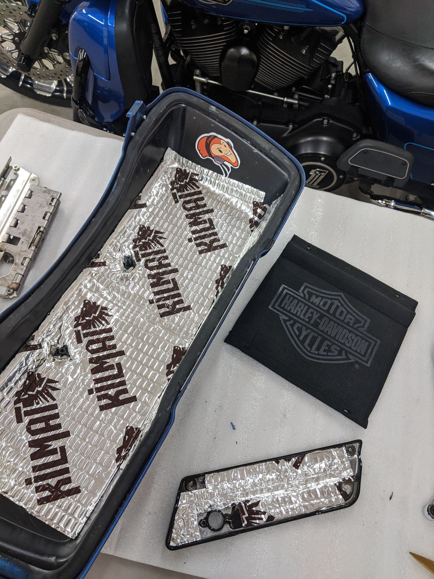

I've not heard heard the new ones but I've got the PRV forte 10s in my bags and powered by PRV A1MH nano 2ohm. I picked that amp off of specs but I feel like they'll be able to handle more. Sound deadening will be key for best sound I had to go back and put some in the latches after I had done the bags.
