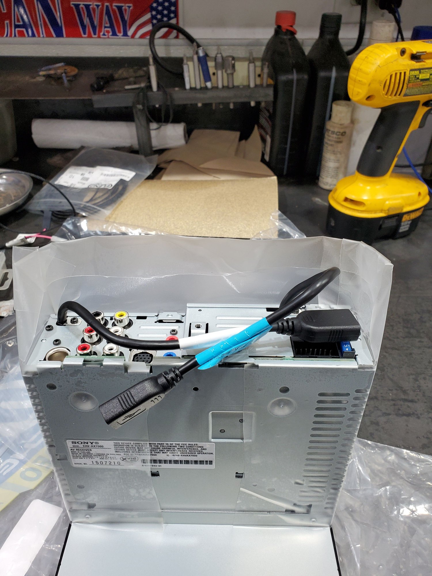

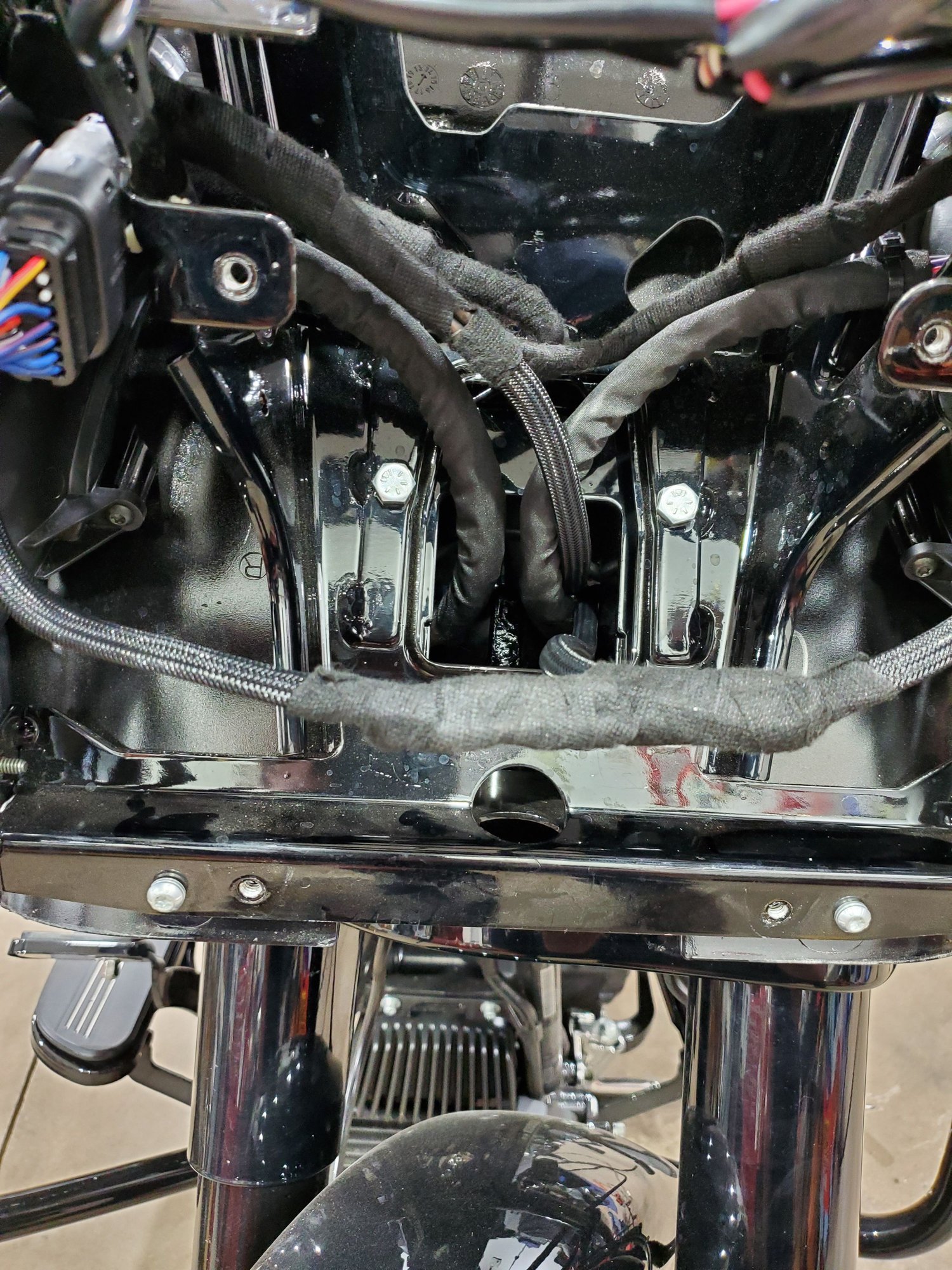

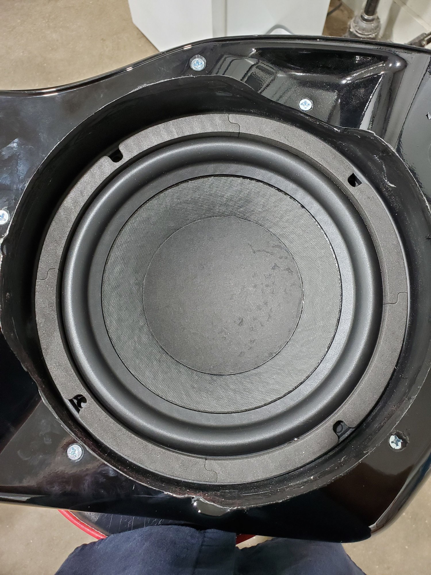

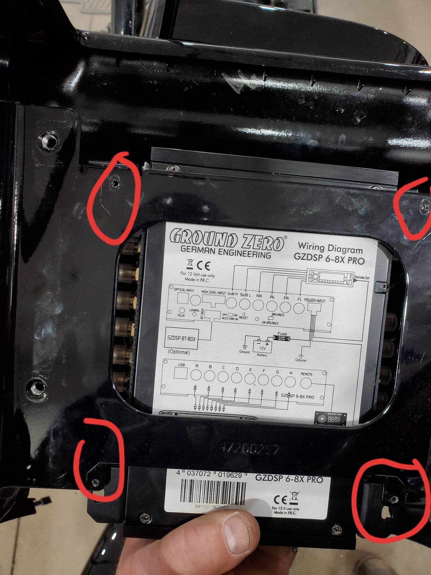

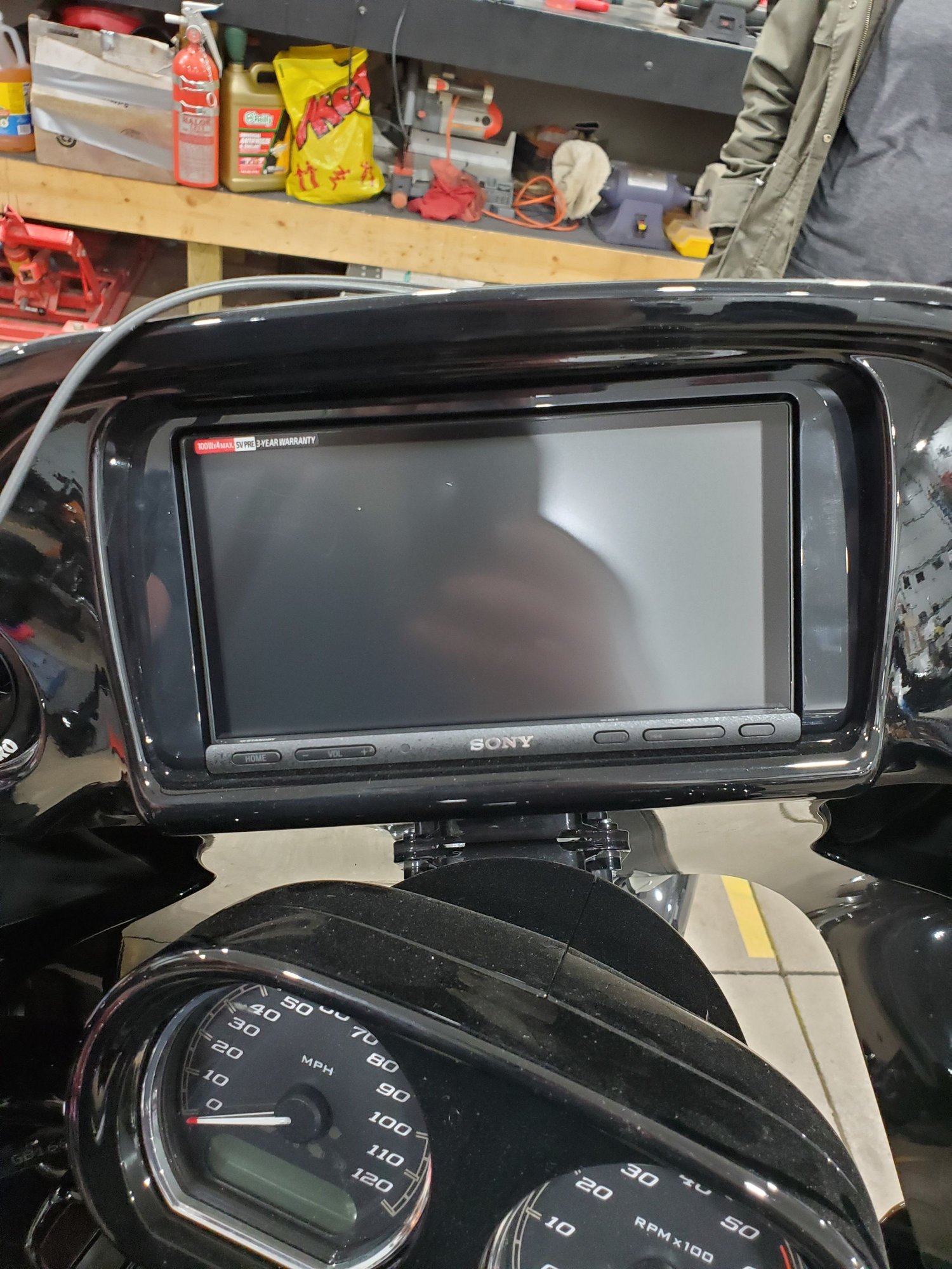

Some more work on the RGS.
The Big GZ DSP! Had to modify the mounts a bit.
Drilled the holes in the radio tray to mount the DSP under the radio.
Opened up the pods just a little bit for the RS140's to drop right in.
Cleaned up the wiring, Horns and Fairing speakers wired in parallel.
Jefe Rings for the RS350's
Wooden dowel to help brace the bags! To small to seal.
Plus, get rid of the stock Radio. XAV AX 7000 dropped right in
A little bit of contact paper to help keep water out of the unit.
I leave a little excess to work as an awning and let water run past the connection area.
The horns are on parallel on 1 channel, the fairing is wired parallel on another .
Juice
