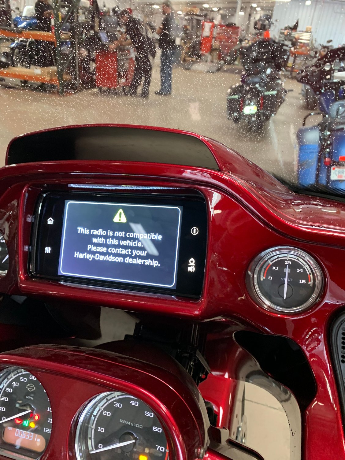

STOP..........take it straight back before it does this, that exactly how my started
Had to put mine on a 2019 bike and update the software
