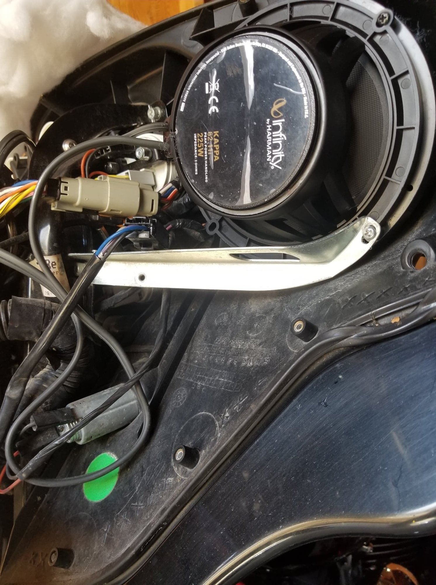

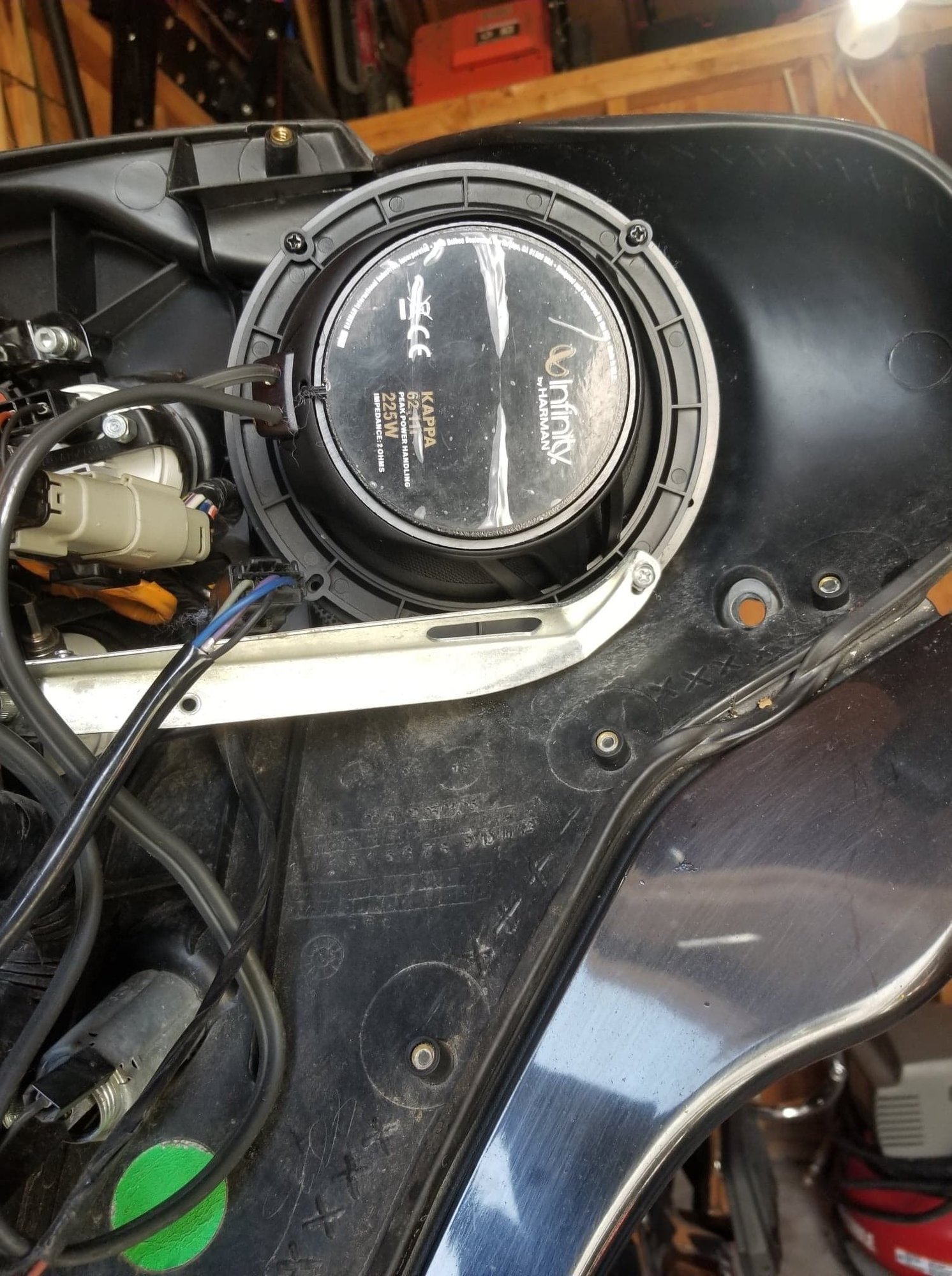

First question - I had to remove the horizontal fairing support brackets in order to install the Metra speaker adapters. The bracket does not line up properly now to reinstall them. From my searches it seems like these are necessary items to keep installed in the fairing but nothing really goes over the best way to get them in there now. Should I just bend them to make them fit? Will that not weaken them or prevent them from providing the necessary support?

I have a ‘10 and recall those brackets pretty much lining back up with the lower outside hole of the adapter not really any bending required.
are you sure the adapters are oriented correctly?
as far as the speakers, that amp is 140 x 4 @ 4ohms . Give each speaker its own channel.

I'll obviously have to re look at it but it sure didn't seem to line up so easily last night.

Exactly which Metra speaker adapters are you using? Model #?

You should have no problems with those. Make sure they're oriented correctly. No mounting hole on the lower inside on each adapter.
