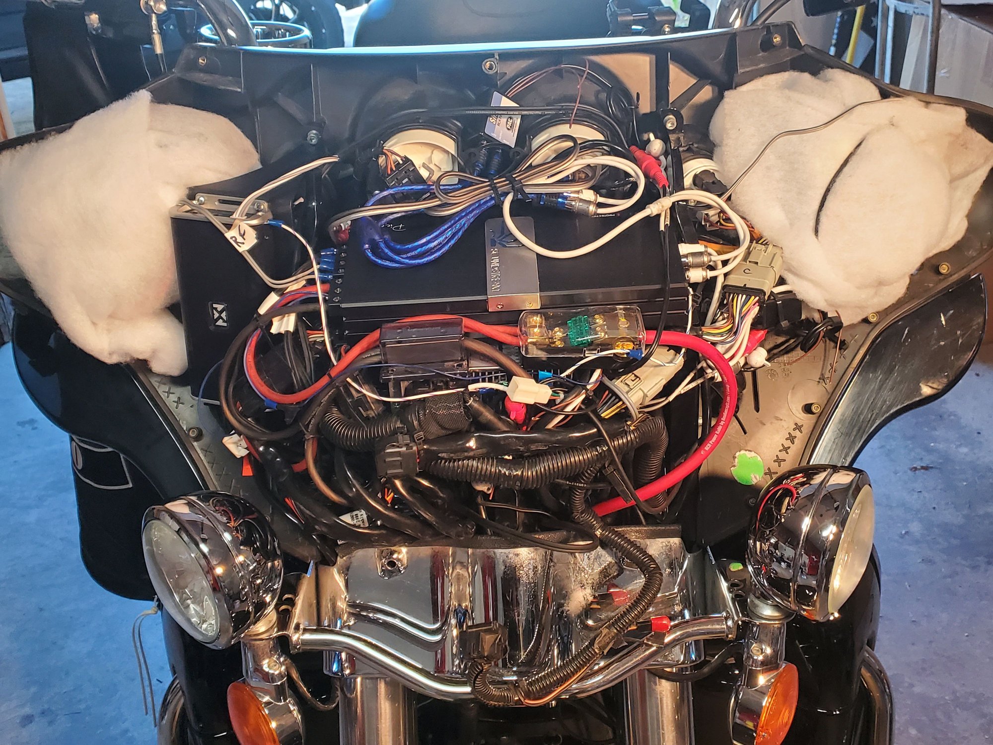

what is the maximum size amp will fit in the 07/13 bat wing or what size is the amp you have in mounted without doing a lot of mods.

I got the Pn4 1000d to fit. You won't get more than maybe another half inch total to fit on the sides and in the pic you can see I put my distribution blocks in front of it with no fitment issues. That's all mounted on top of the Aquatic Av HU which is essentially stock size. Threw a nvx vadm2 on a hogtunes bracket on the brakeside. Didn't have to "mod" anything. I did have to reroute wires.
Excuse my disorganization.

Good pic and clarification i know my taramp 800x4 2ohm will fit if I decide to move one out the saddle bag. How does that amp handle the heat in the fairing?and that cloth over the speakers you made a simi baffle for them.

Ill let others comment about heat. I have not used it long enough to be able to answer that. That being said I did not have any issues during the time I have used it. The cloth is polyfill and is just to help create a fuller sound by mimicking more airspace. Not too little not too much. Theres a lot of threads covering that part but I think most people who use it stick to about three layers covering the back of the speakers.

The PN4.1000d ran in my fairing for over a year with tons of crap tied to it and never got more than slightly warm. I have it in my clutch side bag now with no airflow pushing 6x9s and 6.5s and it still don't get more than slightly warm even when pushed.
It really is a good amp for the money. The only things I don't like are it scrambles FM reception and I found that when I started pushing 6x9s really hard with it the current draw went through the roof. It just wasn't made for a motorcycle electrical system. Most folks will never encounter the current draw issue though I am thoroughly pounding it so I can't blame it for what I paid.
For a while when I had it in my fairing I was pushing six 6.5s with it and had no issues at all.
