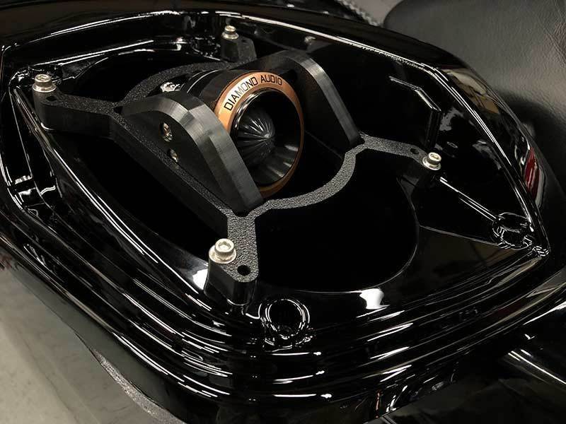

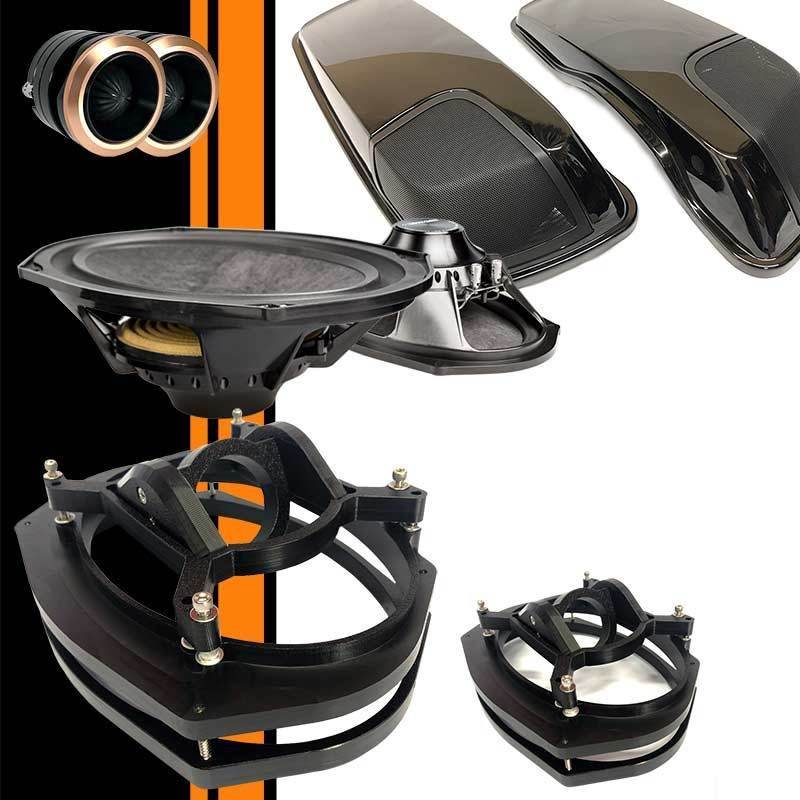

Nice bike! Do you have a pic of those horn mounts in the lid with the grills off?

These?
Thanks, but no I don't. This is the kit that I used.

Originally Posted by teedoff65
These?
Those are for the pre-14 bags I believe. Mine has the 14 bag style.

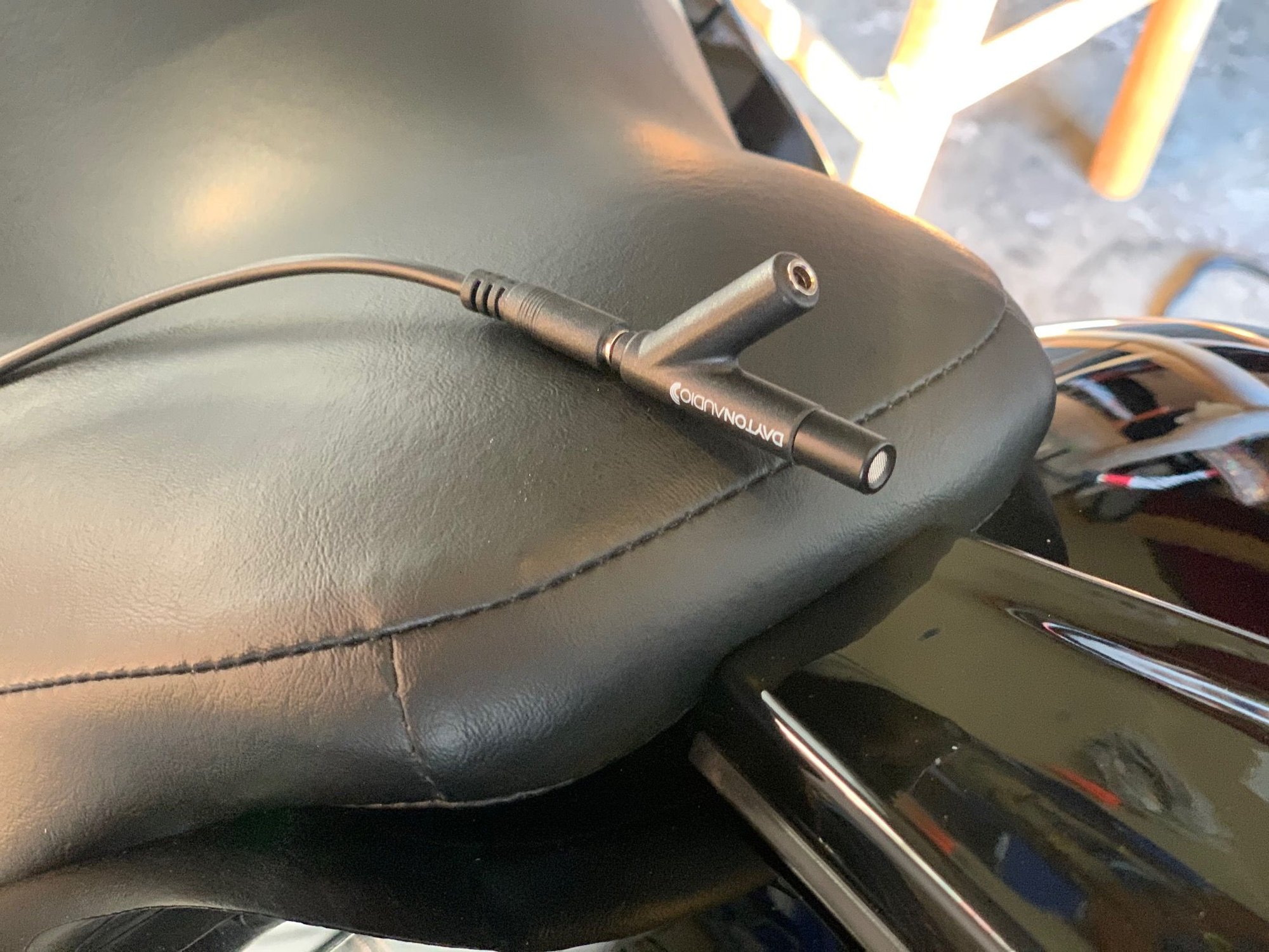

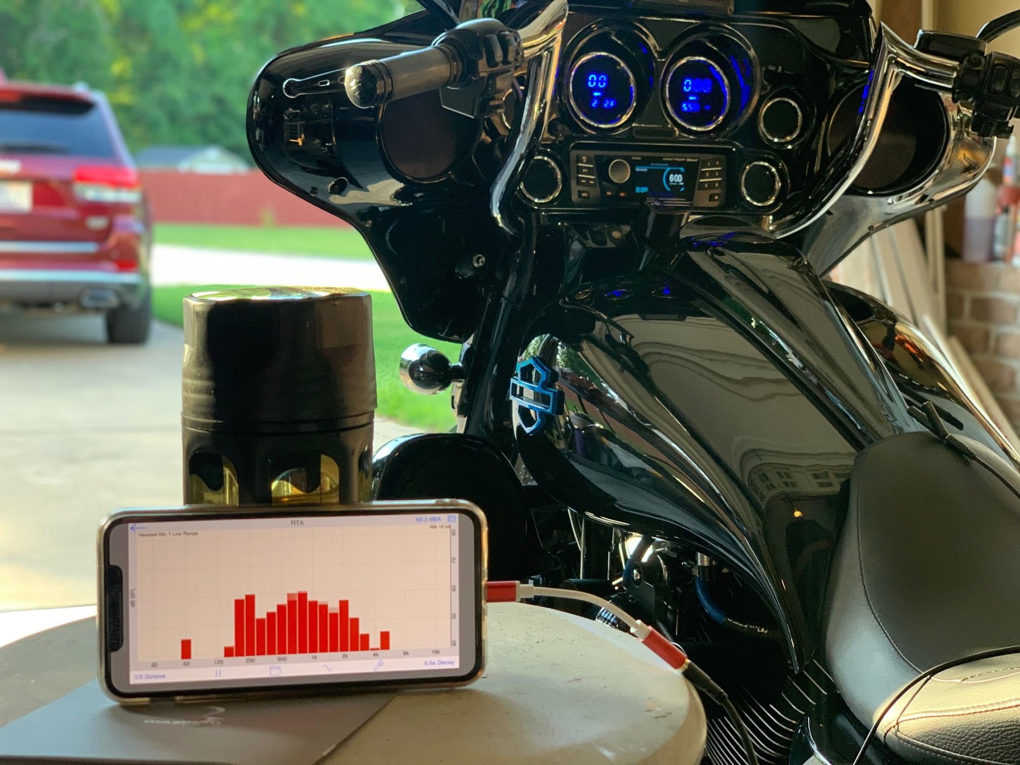

Right now I have the two fairing 7.1 speakers set to all pass and the two 6.5 lower fairings as well. I have a mic setup on my wife's phone so I can run my Real Time Analyzer app while playing pink noise so I can get this system dialed in.
