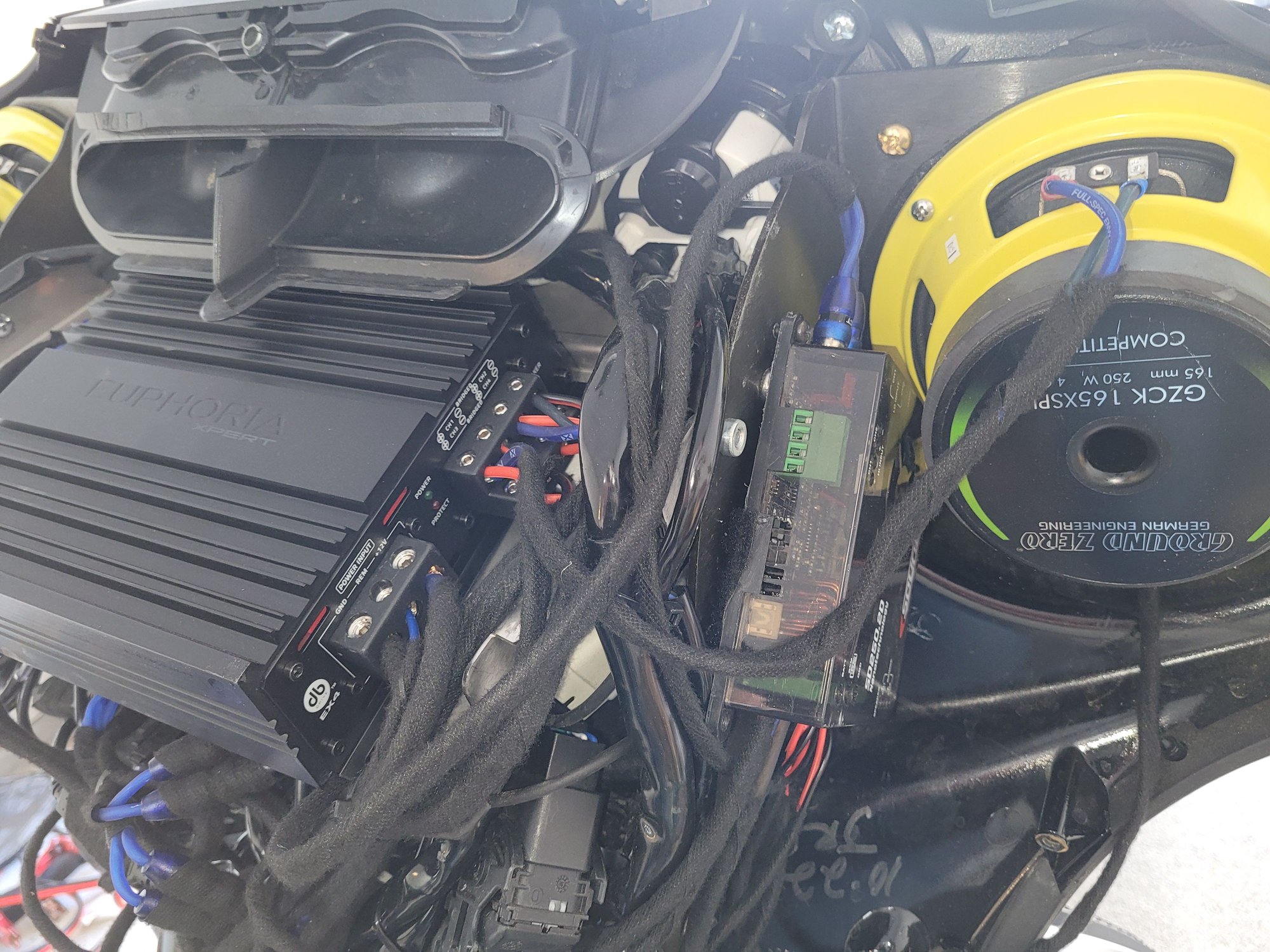

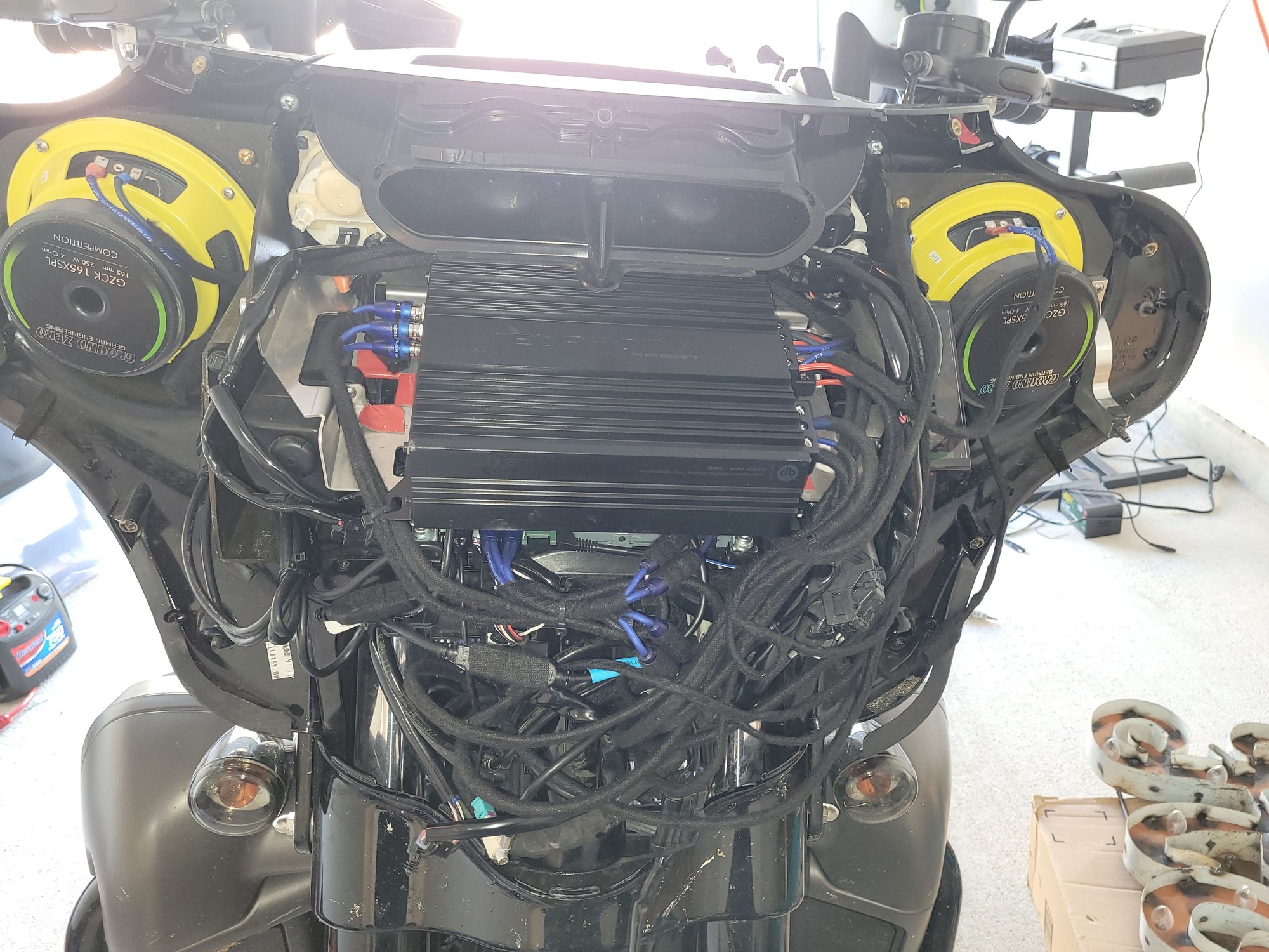

Here are the photos again of the current look. If anyone has suggestions on the best dsp wiring method, I'm happy to take the tips.

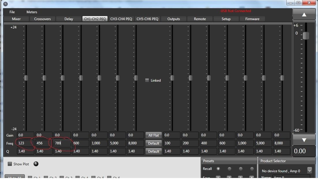

The DSI2 has a 10 band EQ. 10 band in a band pass actually give you a good bit of control.
The acr gives you 7 EQ sliders. Again in band pass you change all the frequencies to what you want. Just type what Fz you want to change.

There is no voltage setting. You can however control the volume for each channel independently. Then you have a separate mast volume. The "Q" setting is just how many other frequencies are being adjusted too. It will make it a sharp spike to pin point/target a specific Fz or if you widen it it will affect souring Fz's.
