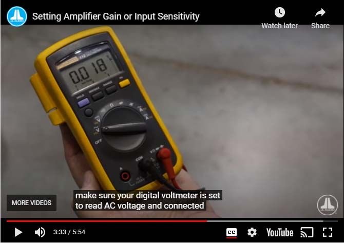

1. The video discusses and demonstrates setting the amplifier gain to optimize amplifier performance & minimize or eliminate clipping and distortion in the signal. Makes no mention of speaker specifications / limitations. Would you go above the optimal amplifier gain setting to align to the speaker target value or would you only use the speaker target value setting if it was below the optimal amplifier gain setting?
2. I have a DSR-1 installed w/ 2-channel input from the HU splitting to 6 outputs to two SD800.4 amplifiers. The video advises balancing volume between speakers by backing-down one or more gains of the louder amps. If the amplifier gains are set to optimal settings (based on #1 above) do I use the DSR1 trim-levels to balance volumes or is there more to it?

Hmm, I've always just set the gains by ear at 3/4, but I watched this video and was surprised to hear them say at the 3:30 mark to set the meter to AC. I thought all automotive amps output DC? I need more coffee I think.
