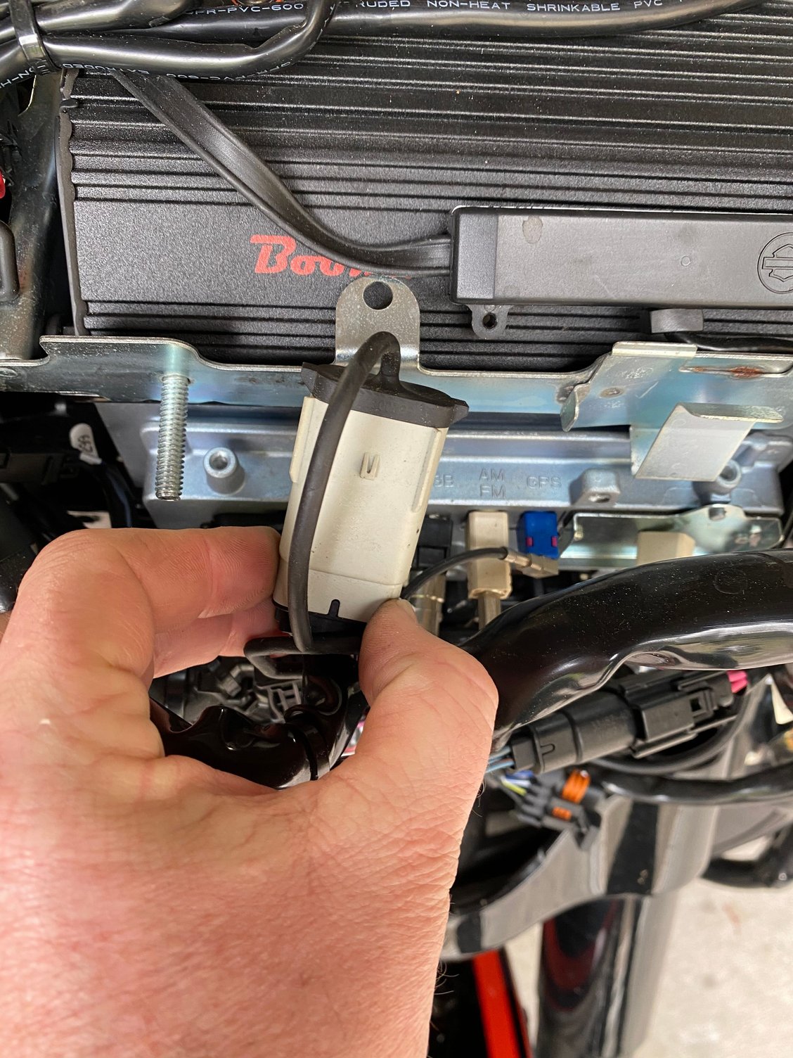

Question What is this for?
Was doing some research inside the front fairing, wondering how I can add a set of tour pack speakers and found this plug. I posted this in the Rushmore section, but they were right that I should've posted it here first. Someone did mention they thought it was to add CB?

I believe that is where you would plug in the WHIM (wireless headset integration module) if you were to go that route.

Correct. That is for the WHIM module. If have a GTS HU you can make a jumper for that and get CarPlay

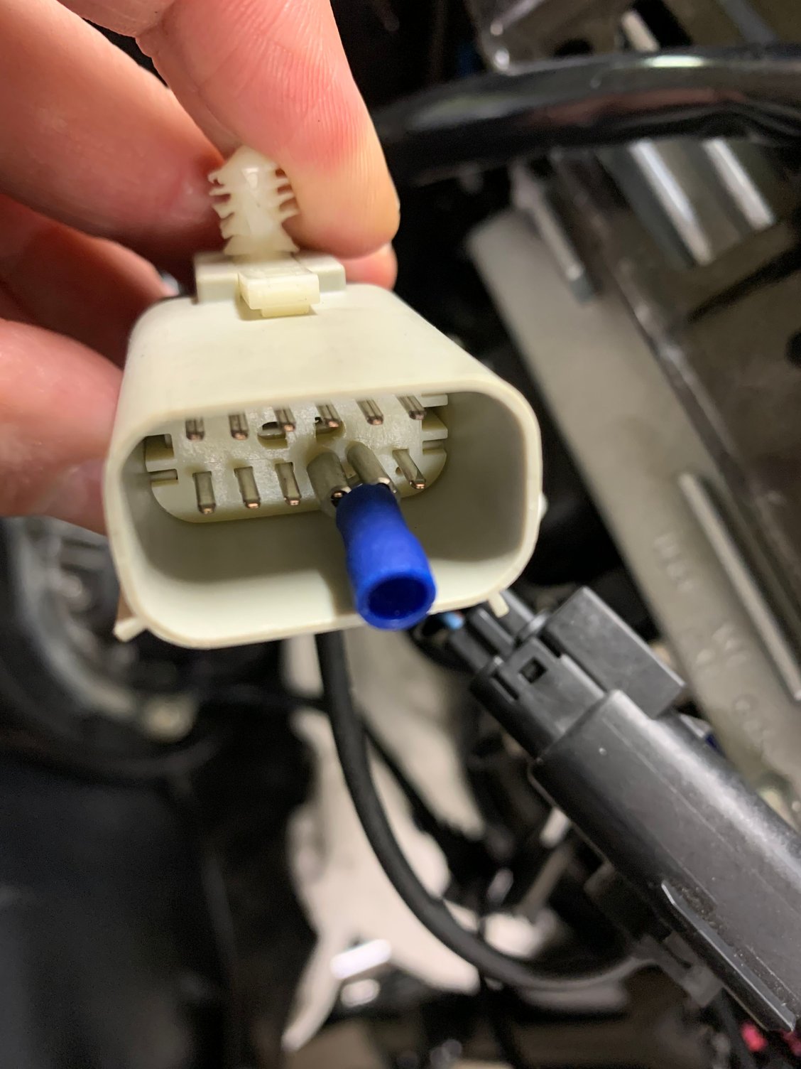

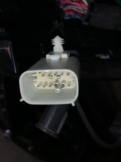

Need to jump these 2 terminals

Default Tried but it does not work out. Tips?

Does jumping this prevent you from using a wired headset? Any cons to doing this? I don't use wireless but it would be nice to use CarPlay anytime whether or not a headset is plugged in.

Let me know if this jumping works for you. I tried it but did not manage to get Carplay working yet...

I have read that using the jumper your headset will no longer work.
