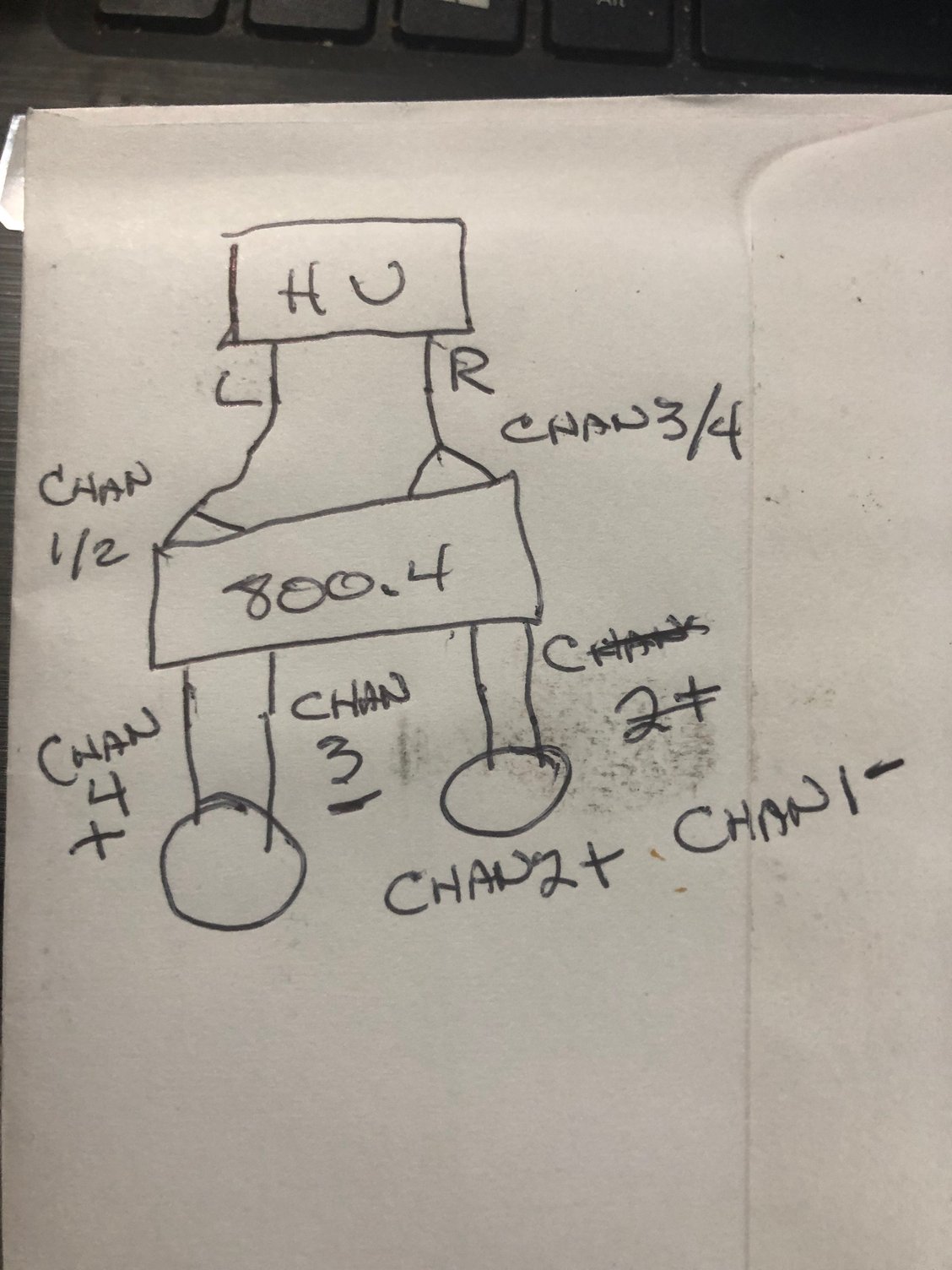

This is how to wire it and retain stereo. Excuse my caveman drawing but you get the jest.

No need to invest too much into researching bridged wiring on the 800.4 as it's written right on the speaker output panel.
Also, if ur planning on bridging and paralleling, have a peek at the specs as I don't think that amp is 2 ohm stable when bridging. Only 4 ohm thus u would have to parallel 8 ohm speakers, not 4 ohm speakers. Not sure what model u have but think the EVOX 800.4 is 4 ohm stable. .

That is correct. Only 1 set of 4 ohm speaker or 2 sets of 8 ohm speakers parallel can be bridged off a 800.4.
