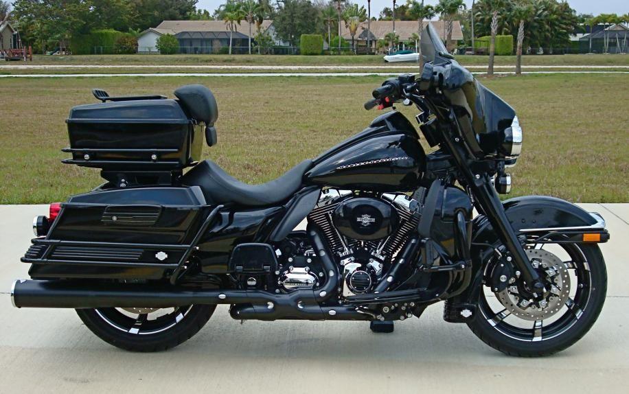

I've been out of the game for quite some time, especially the audio game. Years ago I ran a Hawg Wired System in a few bikes but that was on Road Glides and an EG Classic, pre 2010. Now with the Boom GTS system etc which I am not familiar with, invariably there have been countless changes and a lot of options available to upgrade. WIthin the next few months I'm either going to pick up a new Street Glide Special 2021 leftover or a new 2022. Regardless, a major upgrade to tunes is going to be a must. I am going to do a solo setup on the bike, my girlfriend is going to pickup a new Ultra Tri Glide. Pic below for reference on what I going to end up with. It goes without saying I am going to need an amp in the fairing and new speakers. I am going to add a detachable chopped tour pak as well. I'd like to end up with a 4 speaker setup. I am not opposed to adding pods to the tour pak or speakers in the lids on the bags. Volume is a big one for me as well as clarity since I am going to do some power plant mods and slip ons.Years worth of experience has taught me to do it once and do it right, AKA buy once and cry once vs tossing coin out the window.
