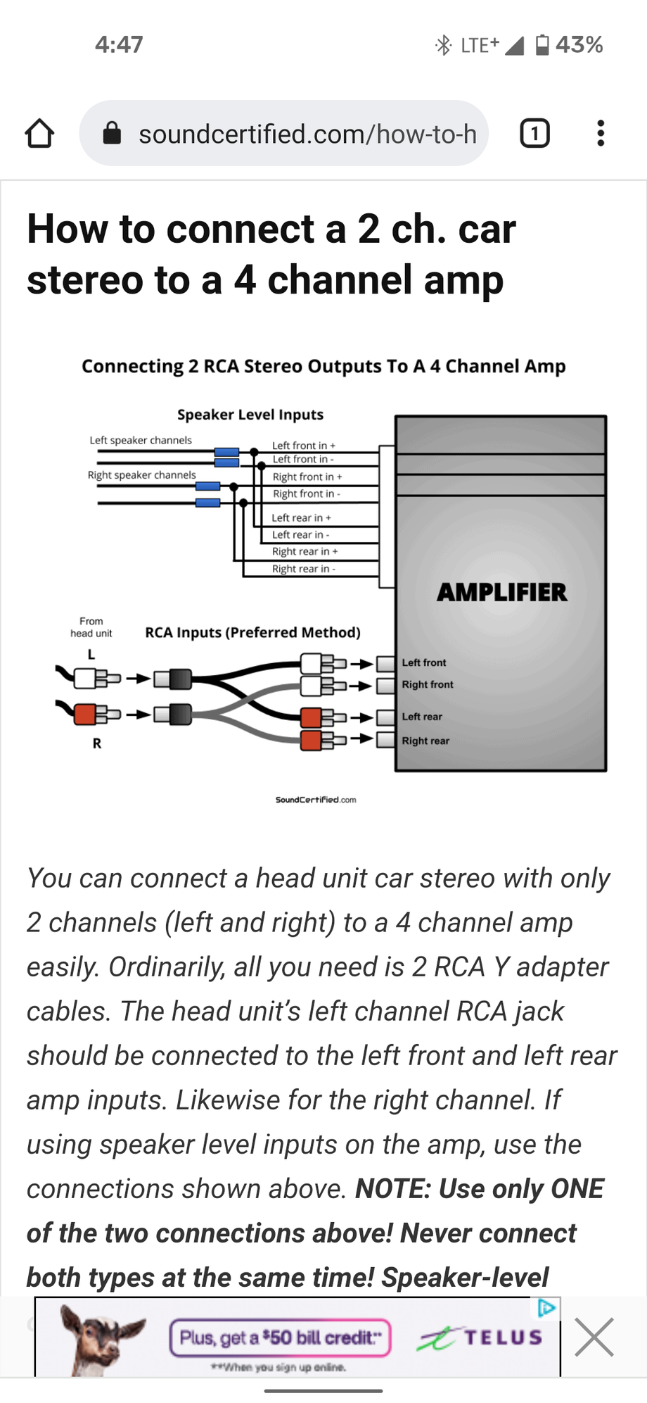

So with the decision to run 2x400.4 EVOX, my next question is how do I send the RCA signal to all 4ch? I can only send 1 set to the front and one to the rear. But the amp doesn't have an "out"...only input.

A good quality Y splitter

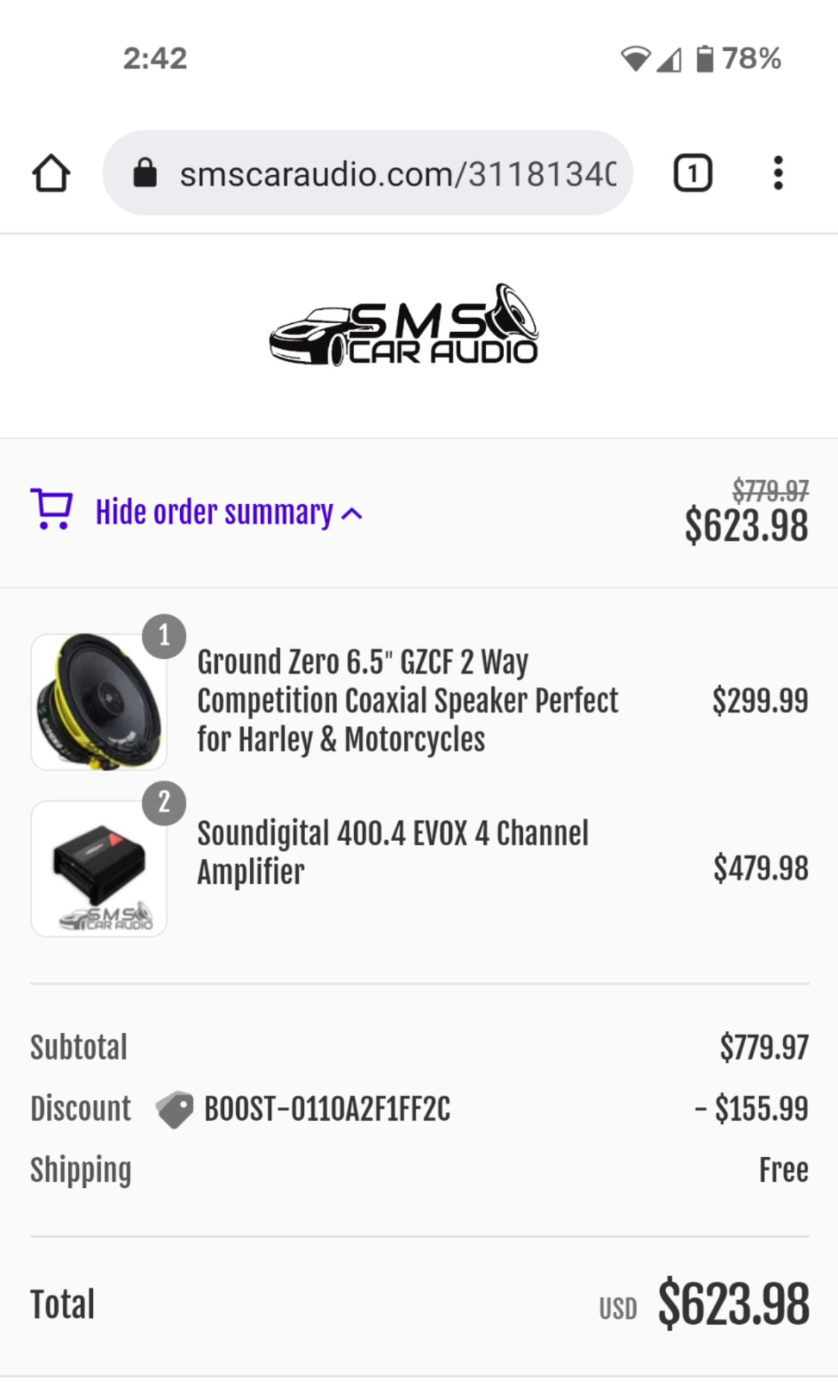

I was going to wait for a possible black Friday sale but SMS car audio provided me an offer I could not refuse...pulled the trigger!

I don't see your Hertz SX165 listed on your order. If you haven't grabbed them yet, you should be able to order them up through Visions here in Canada. Never hurts to ak them if they have a good guy price, it might help you save a few bucks.

I have 4 of those coming from Ebay..should be here tomorrow. Looks like 2 will be up for sale in the classifieds this week 😉
