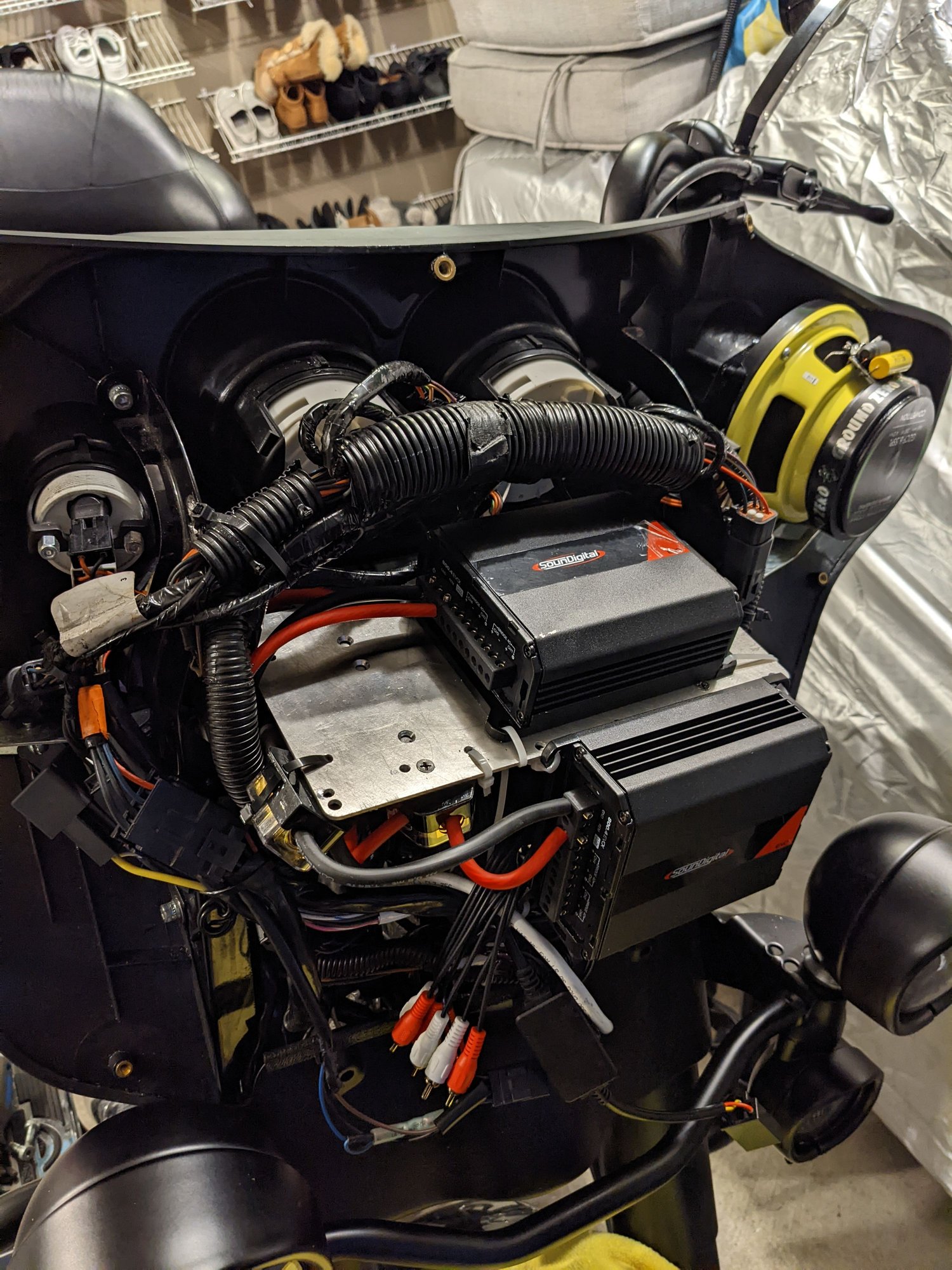

Anything I should be aware of? I'm going to be running 2 800.4evox off the front/rear channel using RCA Y splitters. I wanted to use the deck's xover but could only find the settings for the Front channel. I have 2 GZ YB to the front channel & 4 SX 165 Neo's to the back channel.

Amps are in...speakers are connected and I have confirmed amps turn on and noise comes out!
The "hiss" is quite present...even with gains all the way down 🤔. I bridged the GZ and I was listening to them at very low volume for about 30 mins or so and the amp for the GZ was getting warm...not hot but definitely warm...suprised given I was hardly driving them.
Hooked up the trickle charger and will fire up the bike tomorrow & set gains with the O-Scope and report back...have the Kenwood set to HP with 80hz for the GZ & 100hz to the SX 165 Neo's - amp set to FP.
