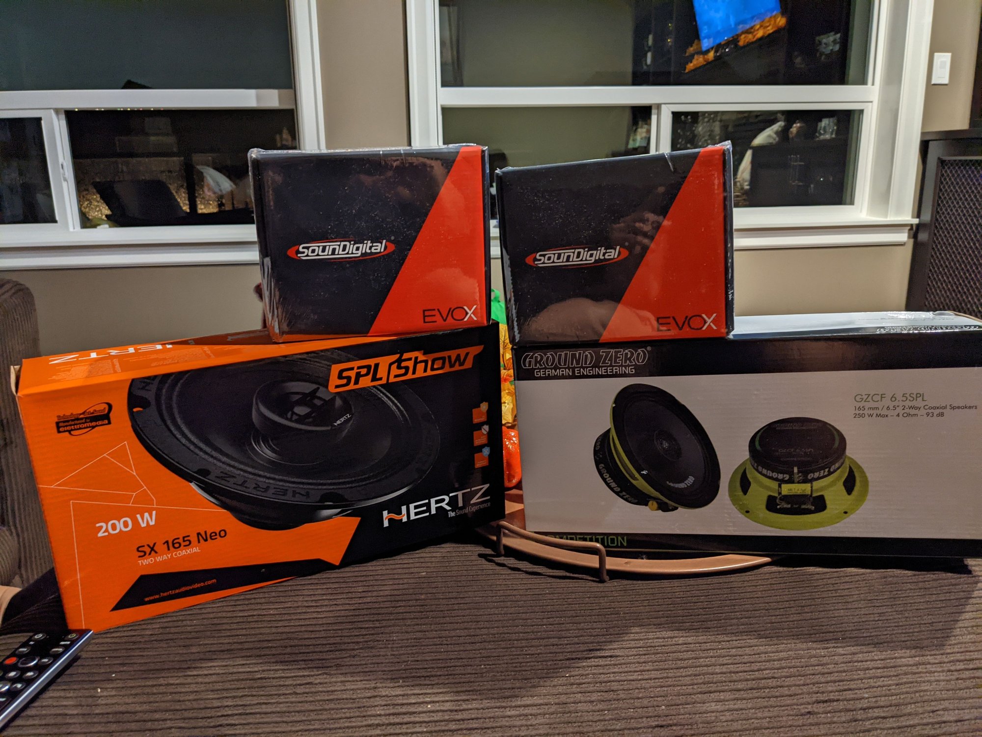

Got em!! Will be selling a set 😎

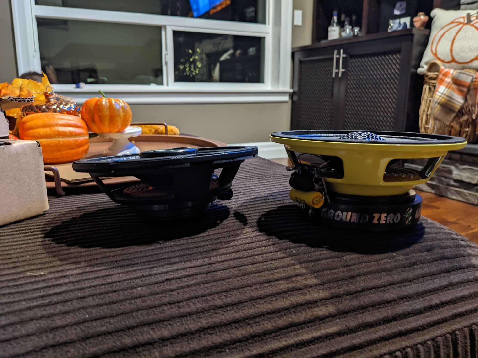

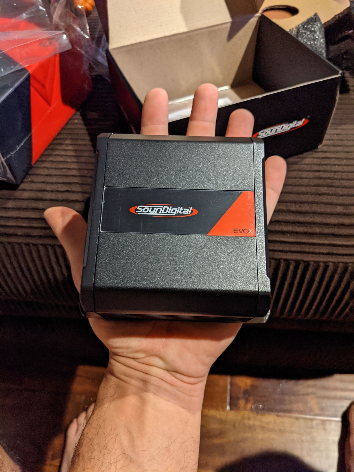

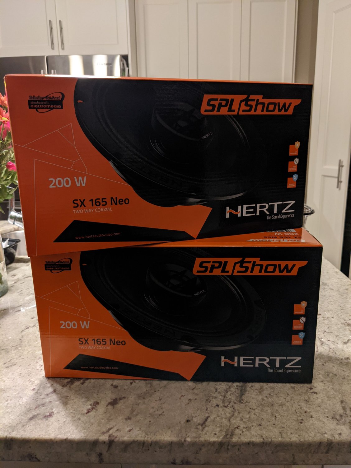

Ok...got it all! Cannot believe just how small these 400.4's are...little monsters!
