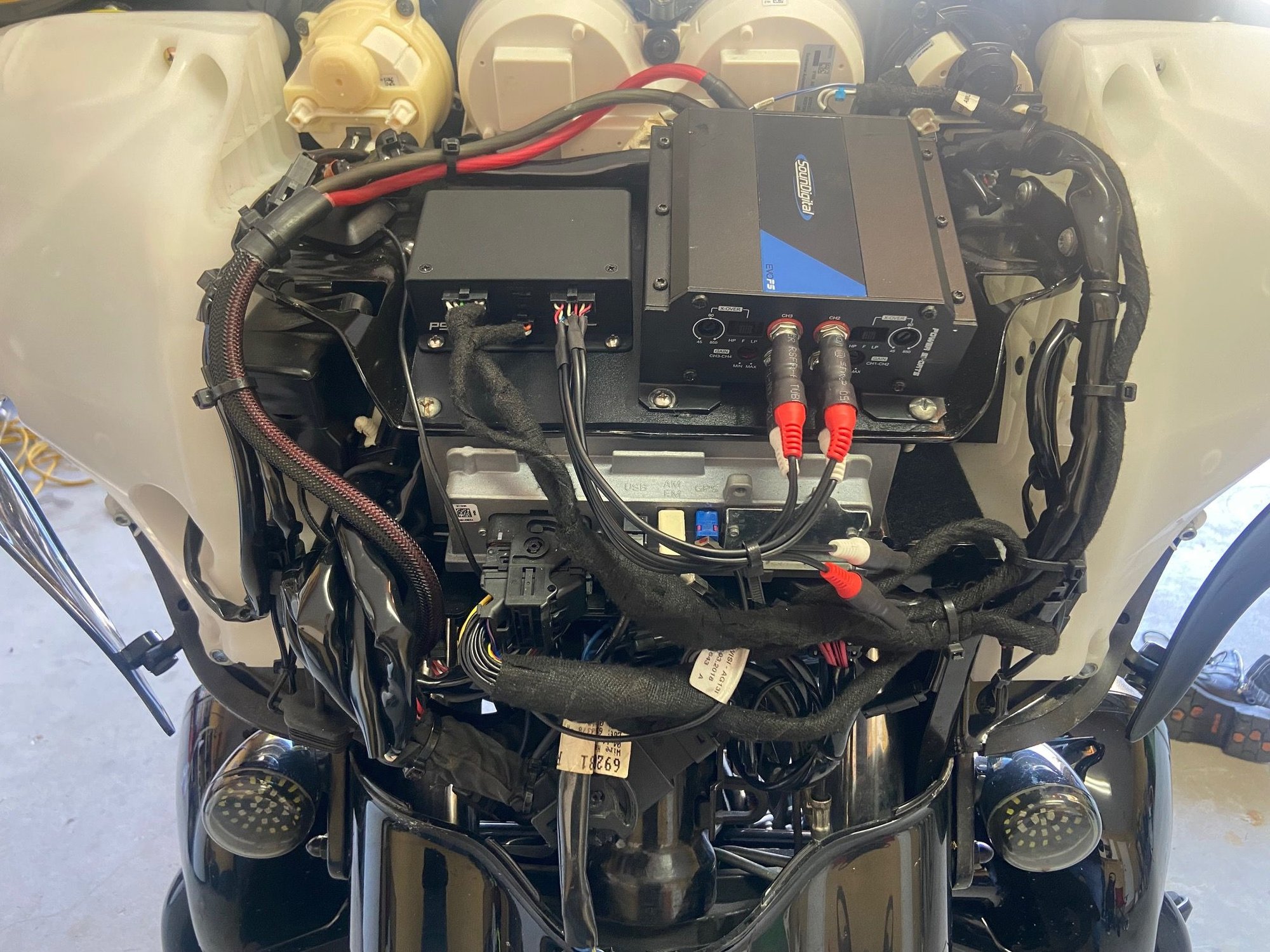

I disagree, I originally put in 2 Ground Zero Yellow Basket Coaxials with a Soundigital 800.4 EVOPS and no dsp in my 2018 Street Glide with a GTS radio. The radio was flashed to 2 amp/ 8 speaker flash. Sounded ok, but I decided to put in a dsp (Arc Audio PSM). The system came alive, must better sound. It my opinion it was worth every penny. You can run it without a DSP, but I never will.
Eddie
All the install done by me. Parts from Chris Lowe (Garage Bagger Audio ), Carlos Ramirez ( NVS Audio) ,Installions Unlimted, and advice and tuning from Henry Torres Jr (Da Funk Shop).
