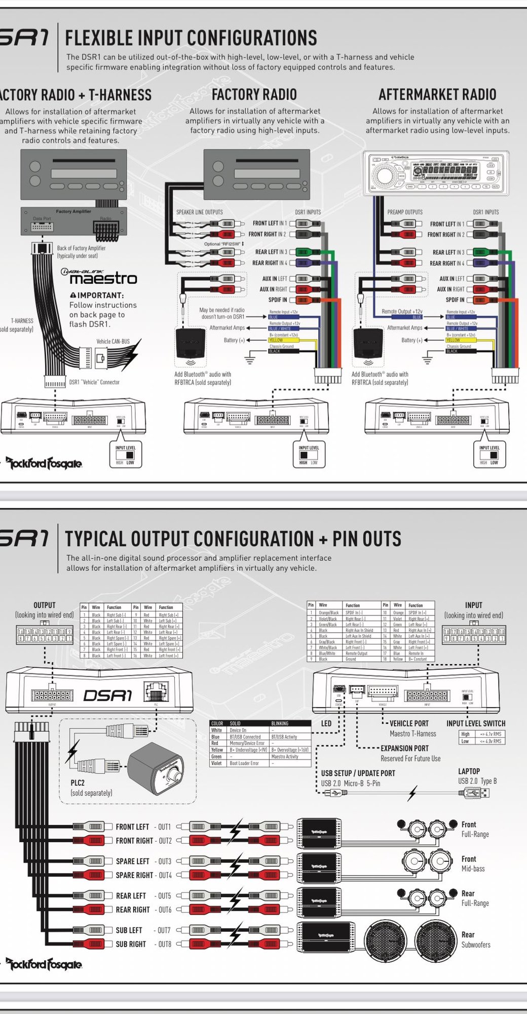

So I have the soundstream head unit with the 10 second amp turn on delay but I still have a noise.
rhe soundstream feeds high level in to Rockford DSR1 DSP then RCA to the amps.
my amps are two SounDigital 800.4 EvoX
I have a 0 Gauge upgraded frame ground to the bike and I pick up the ground for the amps there. 8 gauge wire.
positive is a 0 gauge off the battery that heads in to a fused distribution block then Two 8 gauge power feeds the battery to the amps.
I think I am pulling remote turn on from the DSP and I think that’s is my issue.
can anyone help?

Could be the ground but I had the same issues. Went back through the setup of the dsp and had my input as High Level speaker input when its low level rca. If its a faint hiss, its probably your amp and nothing much to do about it. If its loud and really noticed, check your input on the dsp. Easy mistake and easy fix
Also make sure your remote is connected to the correct blue wire from your headunit. Make sure its not the power antenna wire, with an aftermarket HU, but Im not familiar with a soundstream harness but it shows the remote wire not connected on a factory radio.
