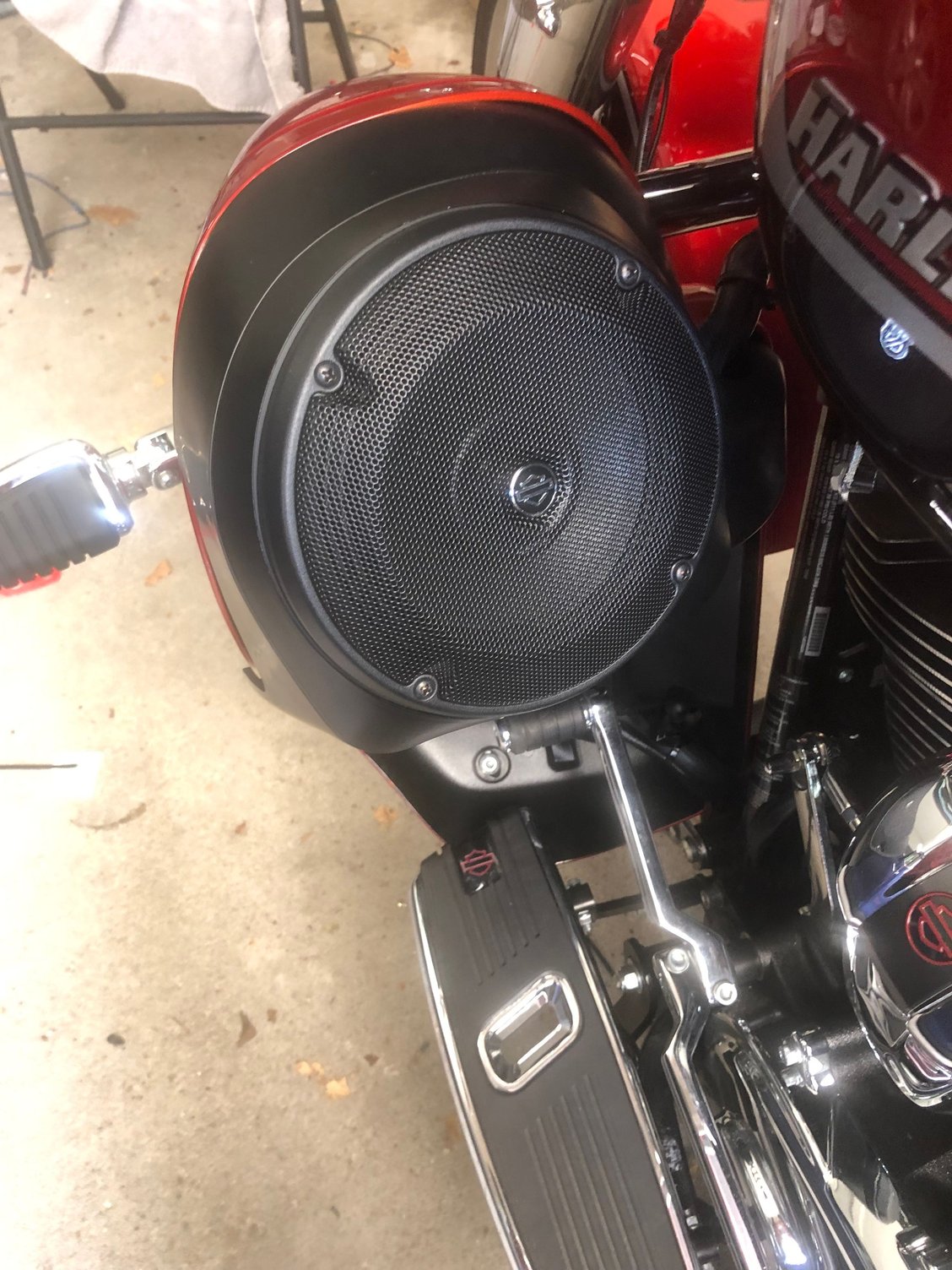

Old Jul 21, 2022 | 04:58 PM
travelingypsye's Avatar
travelingypsye
Joined: Dec 2017
Posts: 3,371
Likes: 689
From: indiana
Metra dual cool lower speaker adaptors with HD grills and sx165 neos in place. Looks stock.

From: Warner Robins, GA
What's the part number for those grills?
Old Jul 21, 2022 | 09:34 PM
travelingypsye
Joined: Dec 2017
Posts: 3,371
Likes: 689
From: indiana
"76000880 woofer grill" but they are hard to find. I bought the last pair that sturdyke had back before HD said no more online parts,

Do you keep the slider for the vent?
Old Jul 22, 2022 | 05:51 AM
travelingypsye
Joined: Dec 2017
Posts: 3,371
Likes: 689
From: indiana
yes sir
