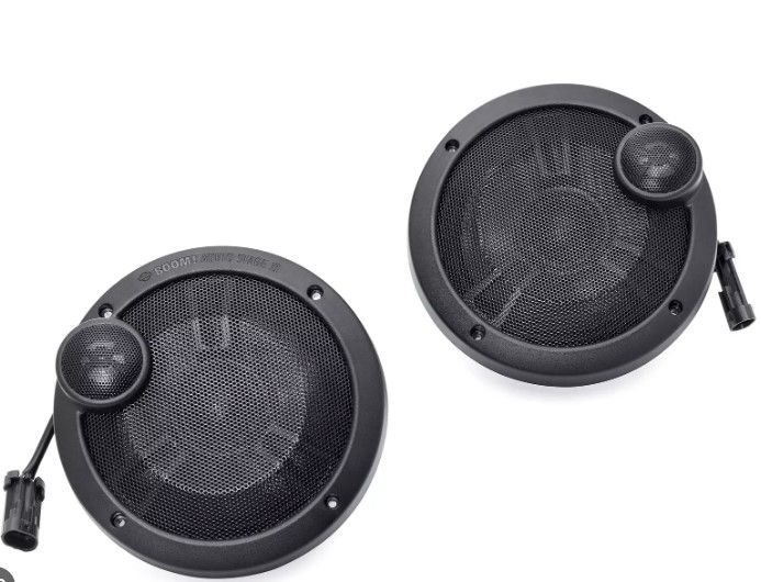

So what harness part number did you use to connect the rear output to the lower fairing speakers. I have the following speakers 76000952

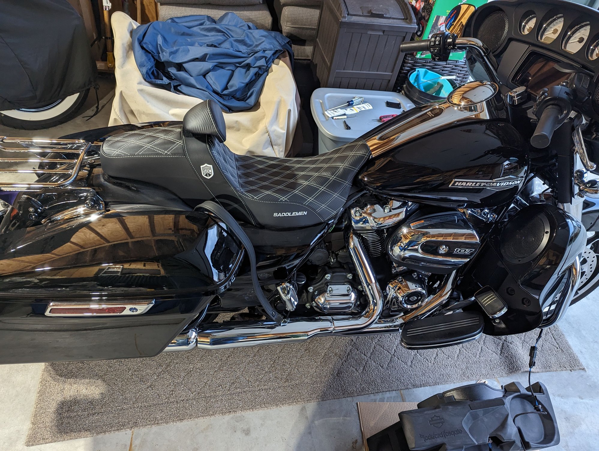

I used a Rockford harness that I bought off their website that connected to the clips from the amp, then I had to cut off the ends and run the wires to the speakers and then attach new female disconnects. Later on I did change them to the Y tap from the front speakers and used the rear outputs to go to the Rockford saddlebag subwoofer, so I have 2 6.5s on each front channel and then the 2 rear channels power 1 10in subwoofer. I've attached a photo from when I was testing the sub setup before I cut into my saddle bag.
