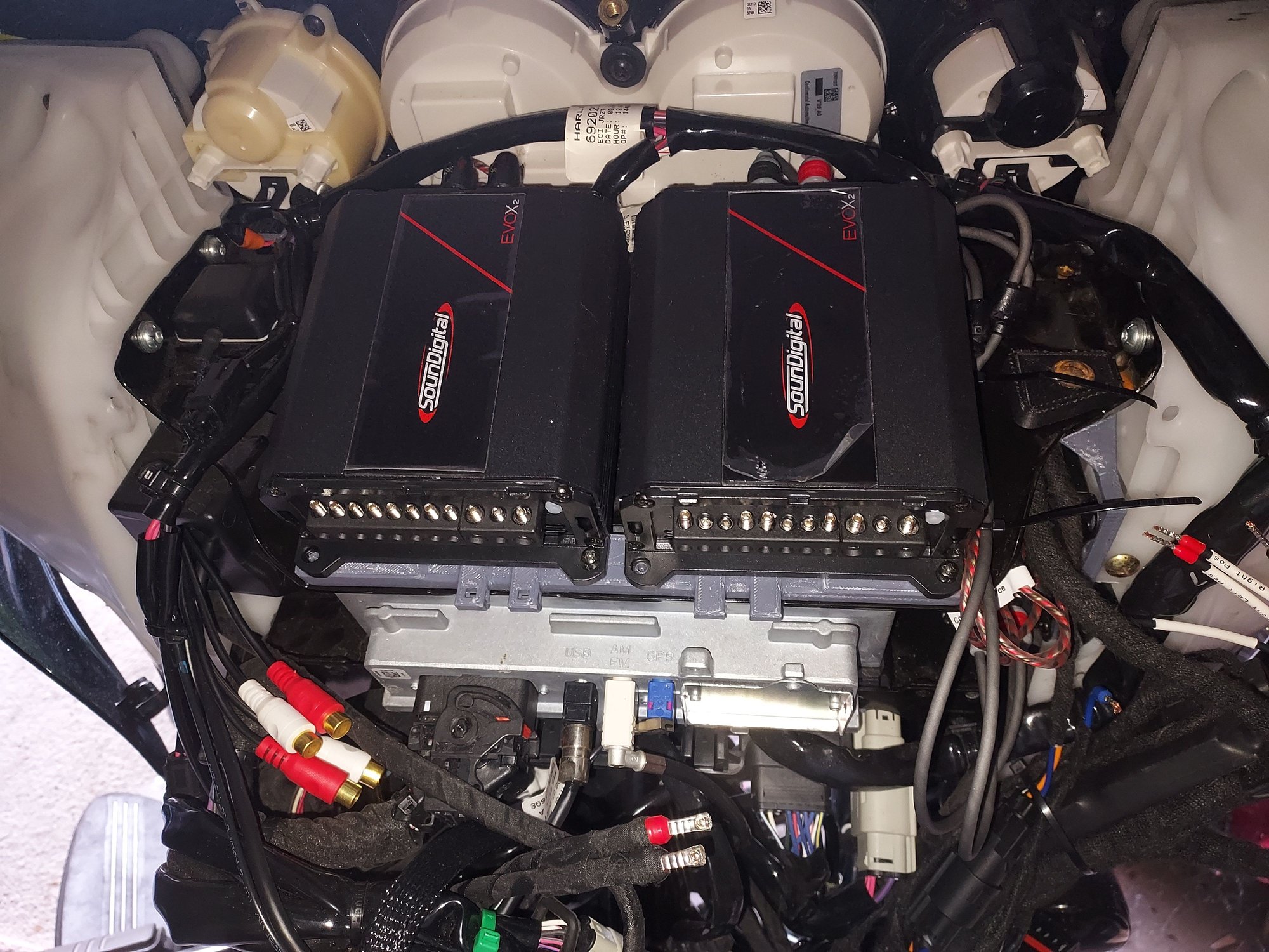

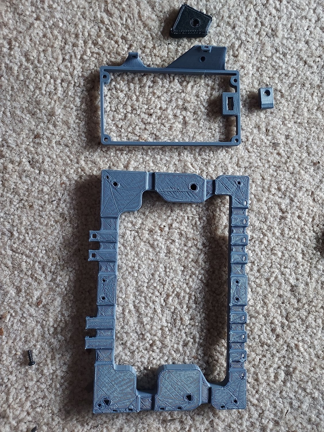

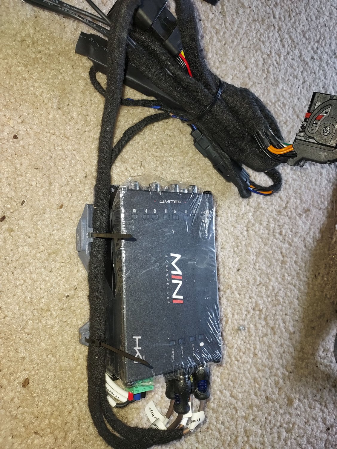

I'd be done if it wasn't for designing my own dsp and amp brackets and 3d printing them. My printer is going as I type this with what is hopefully the final design. Brackets drop in place due to some features I designed to work with the stamped steel factory bracket. It makes for easy bolting/screwing in place. Plus all the ziptie holes keep the cables routed nicely and they don't get pinched.
