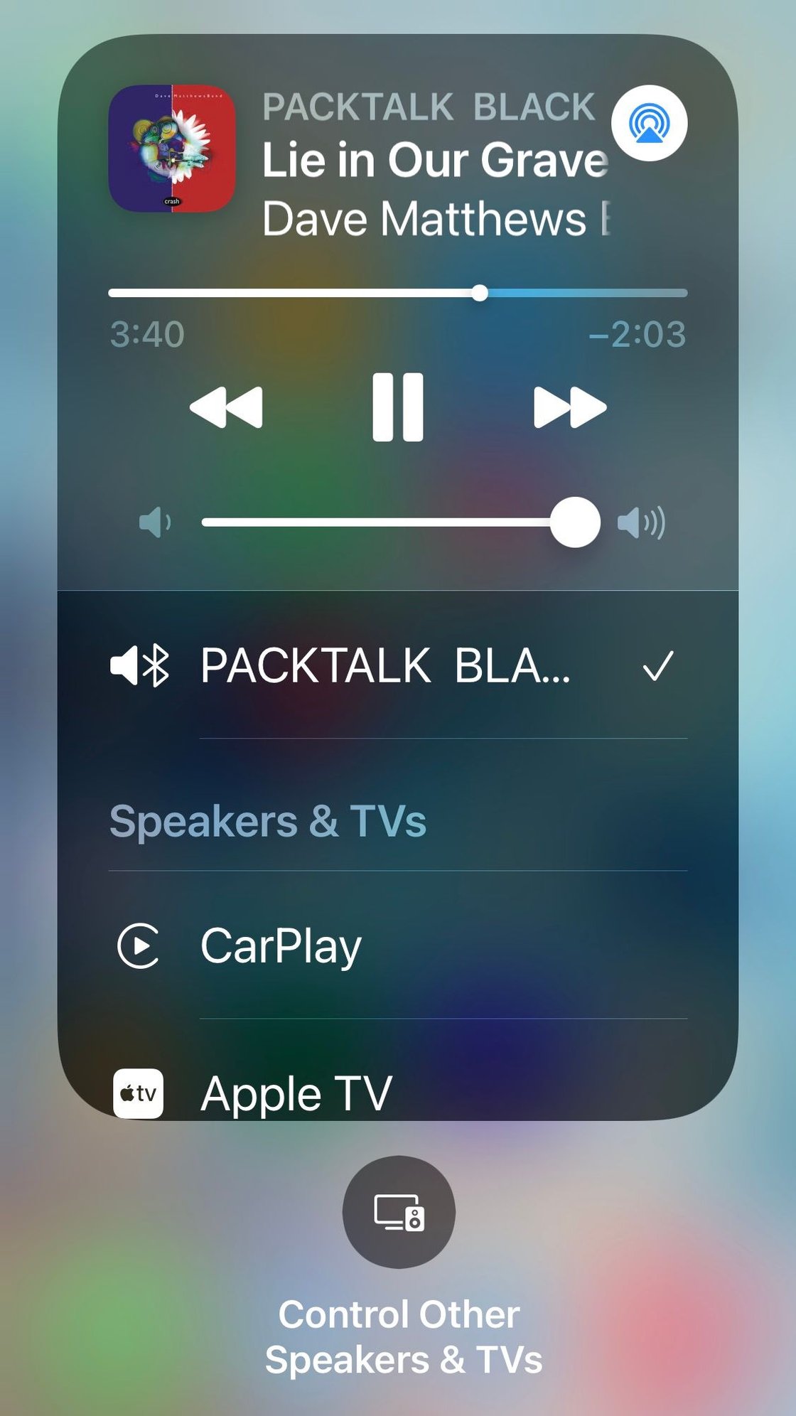

Not sure if you've figured it out yet or not?
I have a Cardo PackTalk, not a Sena, but I suspect it should work the same for you. I stream Spotify and can choose between the bike speakers or my helmet speakers.
Since you're using CarPlay, I assume your music is on your iPhone or streamed using it. When your music is playing, on your iPhone go to AirPlay and then choose where you want the music routed to.
In the pic below, my PackTalk is checked so music to my helmet. If I want it route to the bike, then I choose CarPlay. If you don't have the CarPlay adapter plugged in, it would say BOOM GTS.

You sir are amazing. That worked! Thank you!
