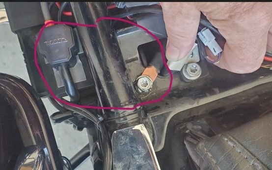

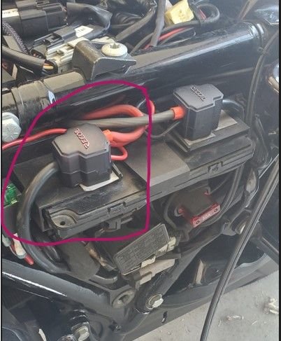

I install a distribution block I bought off Amazon
“RECOIL SDB14P 4-Way Mini Power Distribution Block, 1 X 4/8 Gauge in / 4 X 8/10 Gauge Out Power Distribution Ground Distributor Block for Car Audio Amplifier Splitter, 2 Pack”
I ran 4 gauge to the battery for the power and for the ground block I ran direct to the frame.
See images
So how do I prove power is good or that the problem IS power? Becomes the question and then is it ground or power????

it's been debated greatly on here, but the recommendation is to run the ground directly to the battery...

Ground to the battery! With the fairing off, run it for your 10 minutes with the fairing off and see if the Stinger is going in to overload (the LED changes color).

Ok, I added a ground from my ground block to the battery using 8 gauge OFC wire. meaning the ground block goes back to battery AND to the frame (best of both worlds I hope)
I don't have enough wire to go from the amp direct to battery as test "today" but I do have some coming and will be here tomorrow.

If you have a volt meter with long enough leads, do a voltage drop across the wires when the amp goes into reduced power or whatever is going on. High voltage across the positive or ground wires will let you know where to start looking.
Did you take the main fuse feeding the amp and make sure the connection was tight? I've seen cheap fuse blocks not keep a good grip on the fuse and cause high resistance. If it's bad enough it'll get hot
