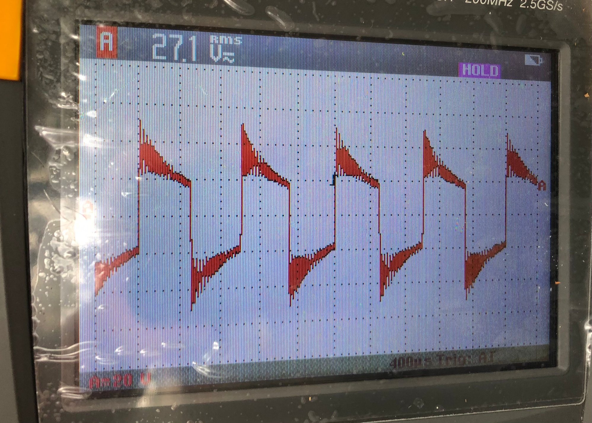

Just use an oscilloscope. It’ll take you from this
to this
