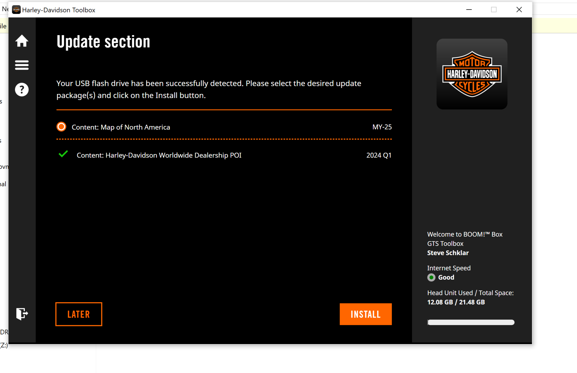

Choices:
1) new map for NA has circle with a dot in it. I take that to mean it is the one I am downloading .... COULD I BE IN ERRORé
2) DLR file (has green check mark by it
Will start over and try to get two green checks
thanks ..... stay tuned.

I was on the blower with MOCO and they asked for proof of purchase (invoice, copy of fingerprint, photo of "no map database/dealer database" messages my first grandchild's birth date. They have elevated the situation and .......... I wait.
There are two files listed on the Update do download: one is the MA-25, with a red dot, and the Dlr POI file that has a GREEN check mark beside it. MOCO says that file shouldn't be there and may be causing the issue in that I am only getting that file and not the 11GB map file.
Hope this is large enough to explain
I can't get the map file to show a green check mark and MOCO says this is causing an issue.
Now is the question: What can they do about it?????

That's what happened to me when I tried to download it the first time or two. I got customer service number phone and we reformatted the USB drive to fat32 and disabled all virus software. Then I had to get a new fingerprint off the bike.... at that point I went back into the update and refreshed the screen. Presto, the complete file was there and it installed successfully...
