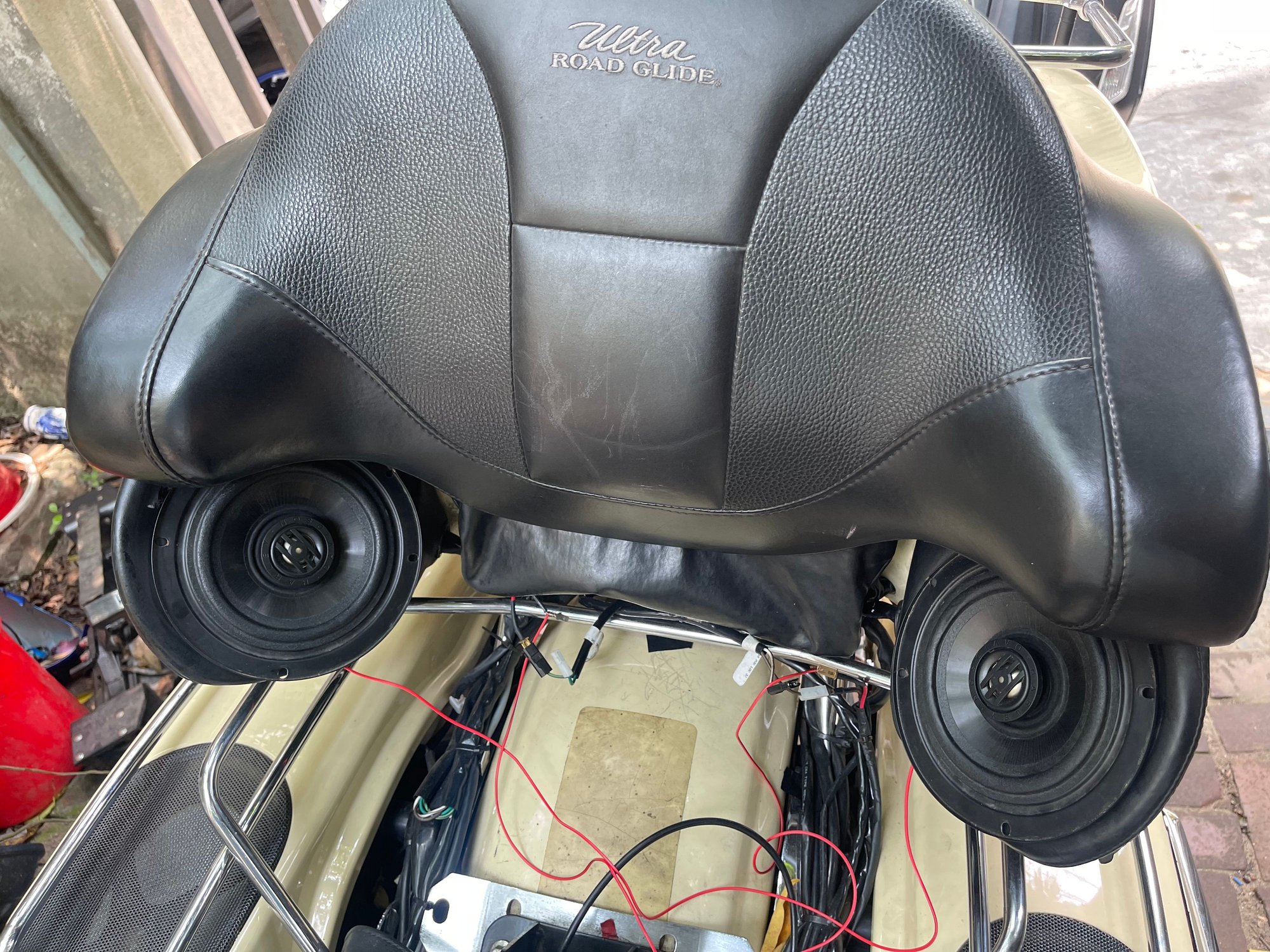

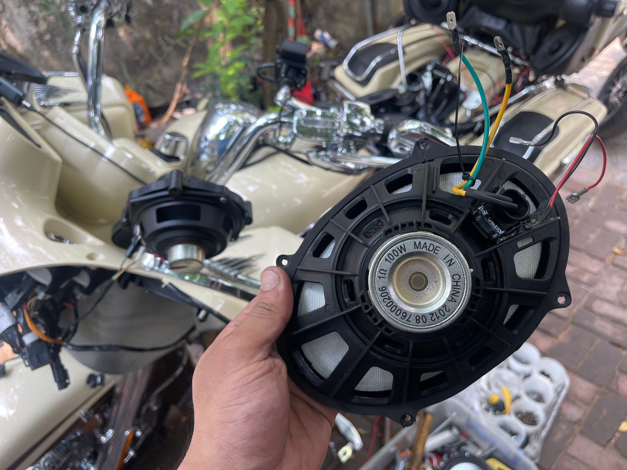

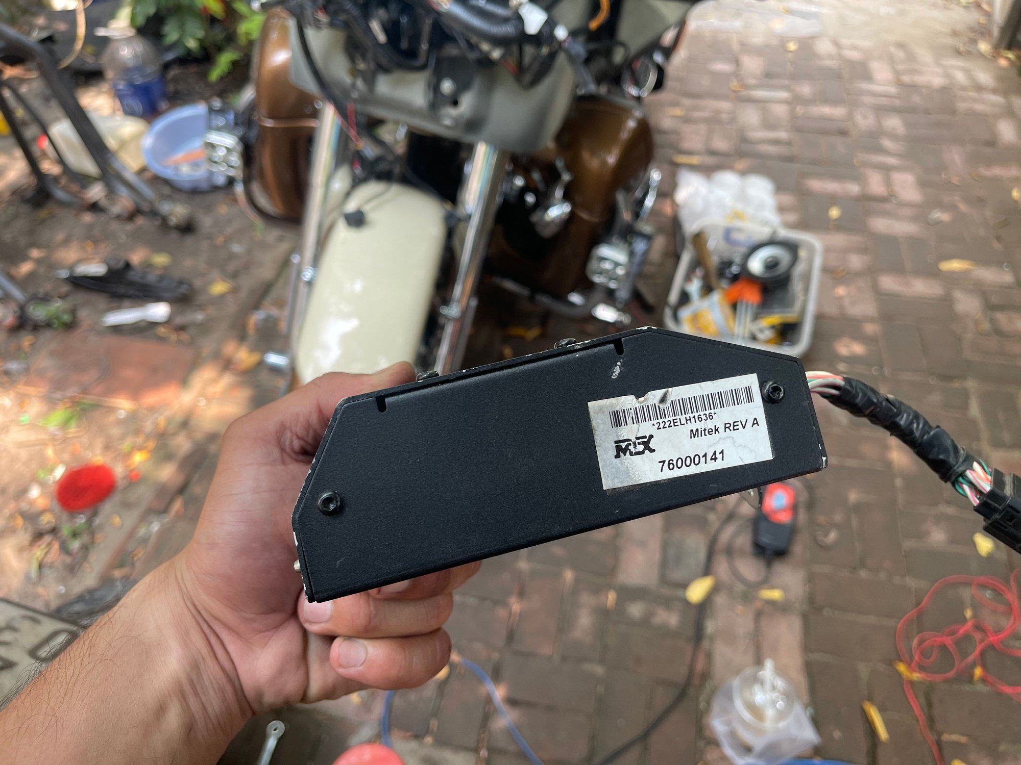

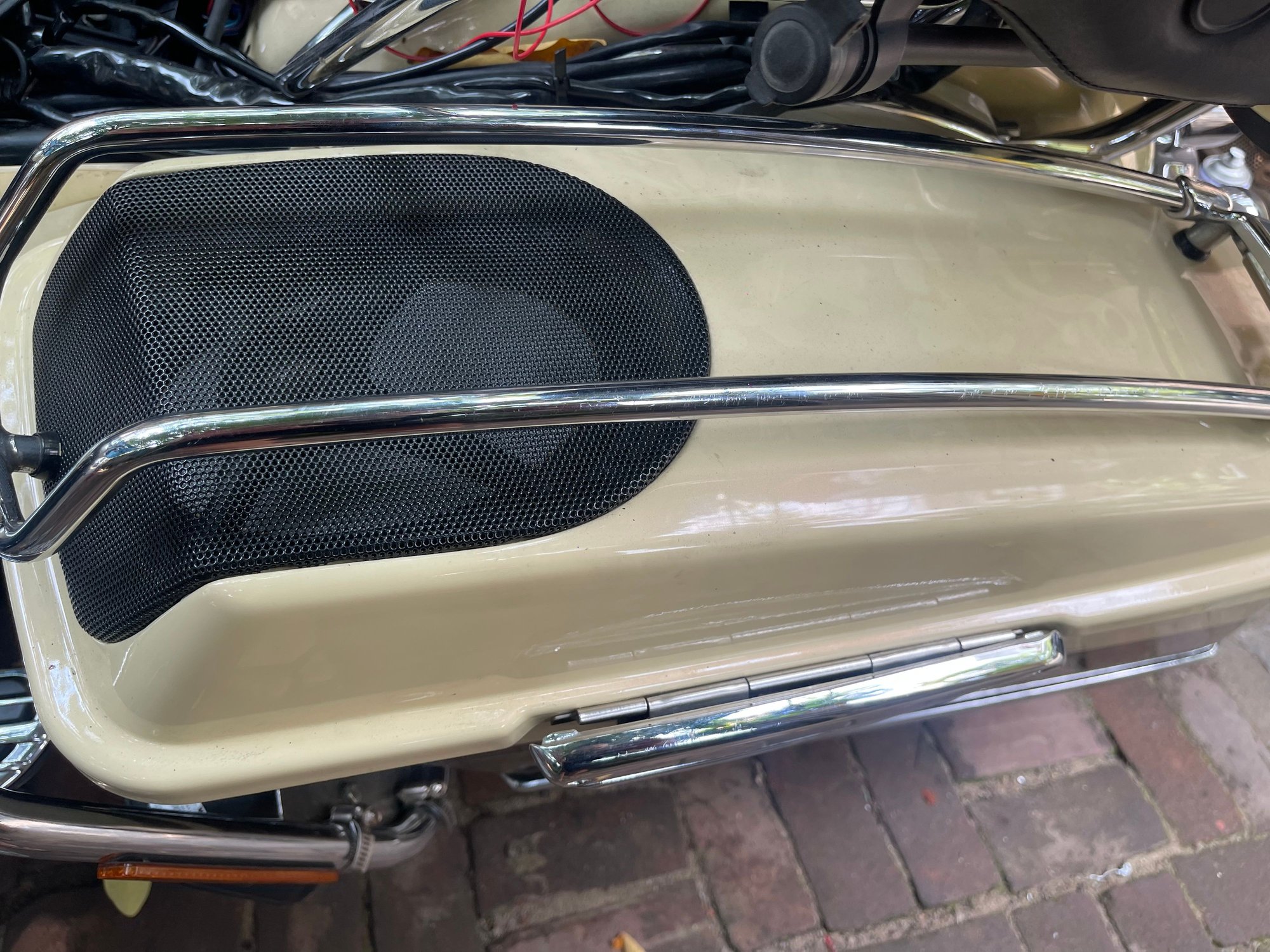

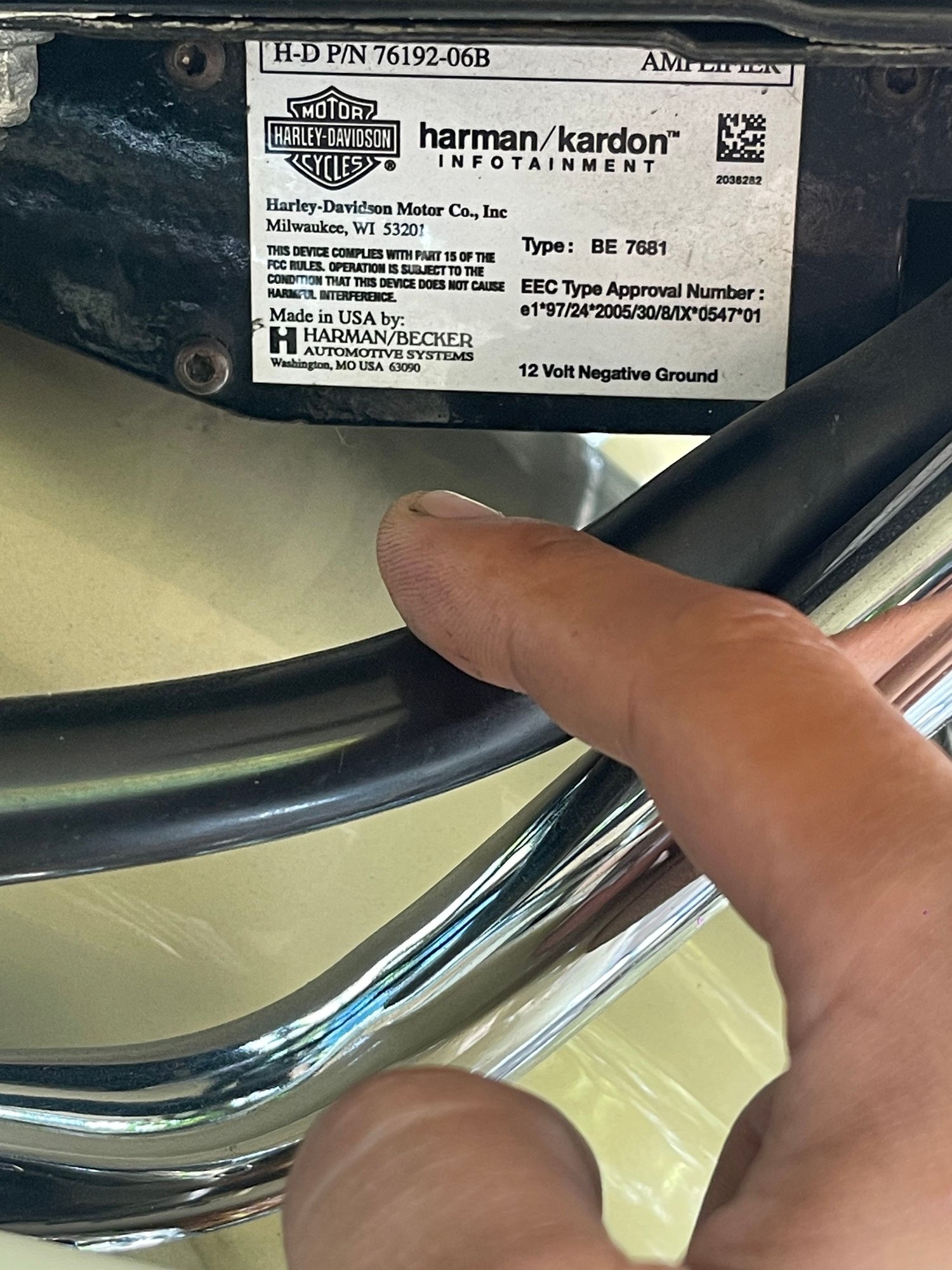

hi brother Carl
my bike is a utral road glide CVO, has a HK amp located under the tour pak, i bought an extended sound set with code 76000263 for the purpose of using 2 saddlebags, i followed the HD instructions but it seems like the speaker is unstable, overloaded, listening to noise, the speaker set I am using has 2 ohms in turn, 2 front 1ohms, 2 rear (tourpak) 2ohms, 2 saddlebags 1 ohms, thank you
