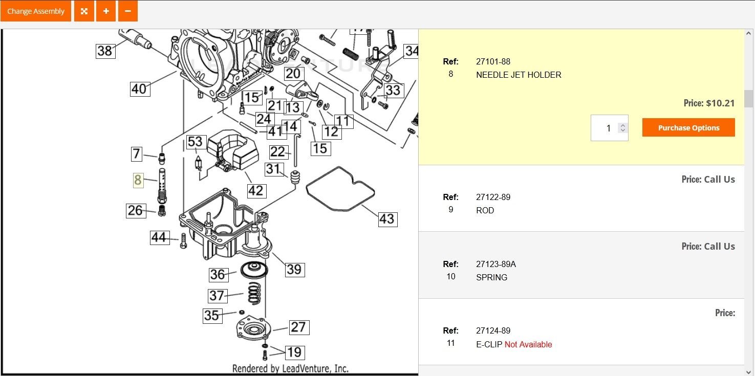

If it's carbureted and it's been sitting for a while, you may need to go through the carburetor and clean out some passages.
I've found the holes in the needle jet holder (number 8 in the exploded view) can get gunked up.
Cleaning them out had a profound effect on how the engine idles and runs. I've found that going in and physically cleaning out all of the small holes is the best way to do it. That miracle cure in a bottle just doesn't seem to get in there to remove the buildup. IMHO.
