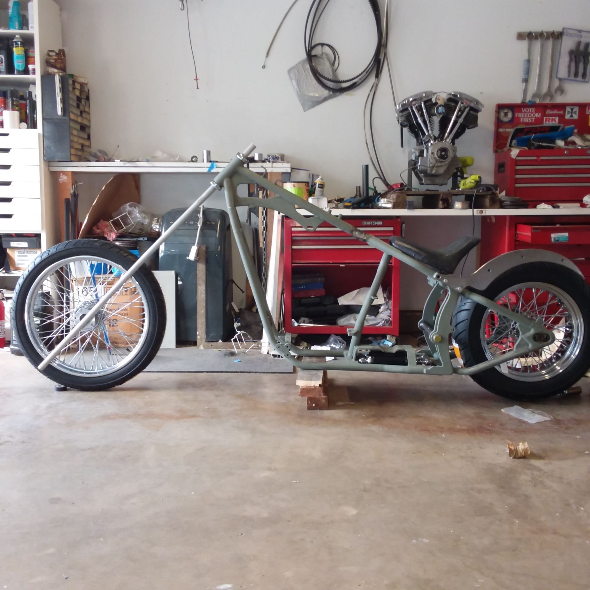

Well I managed to get a day off so I mocked up the swingarm to get a measurement
on what fork I need. Looks like a 12 over will do.

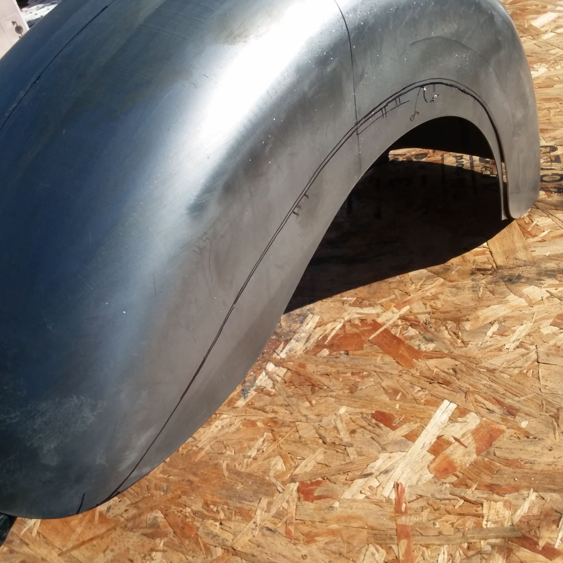

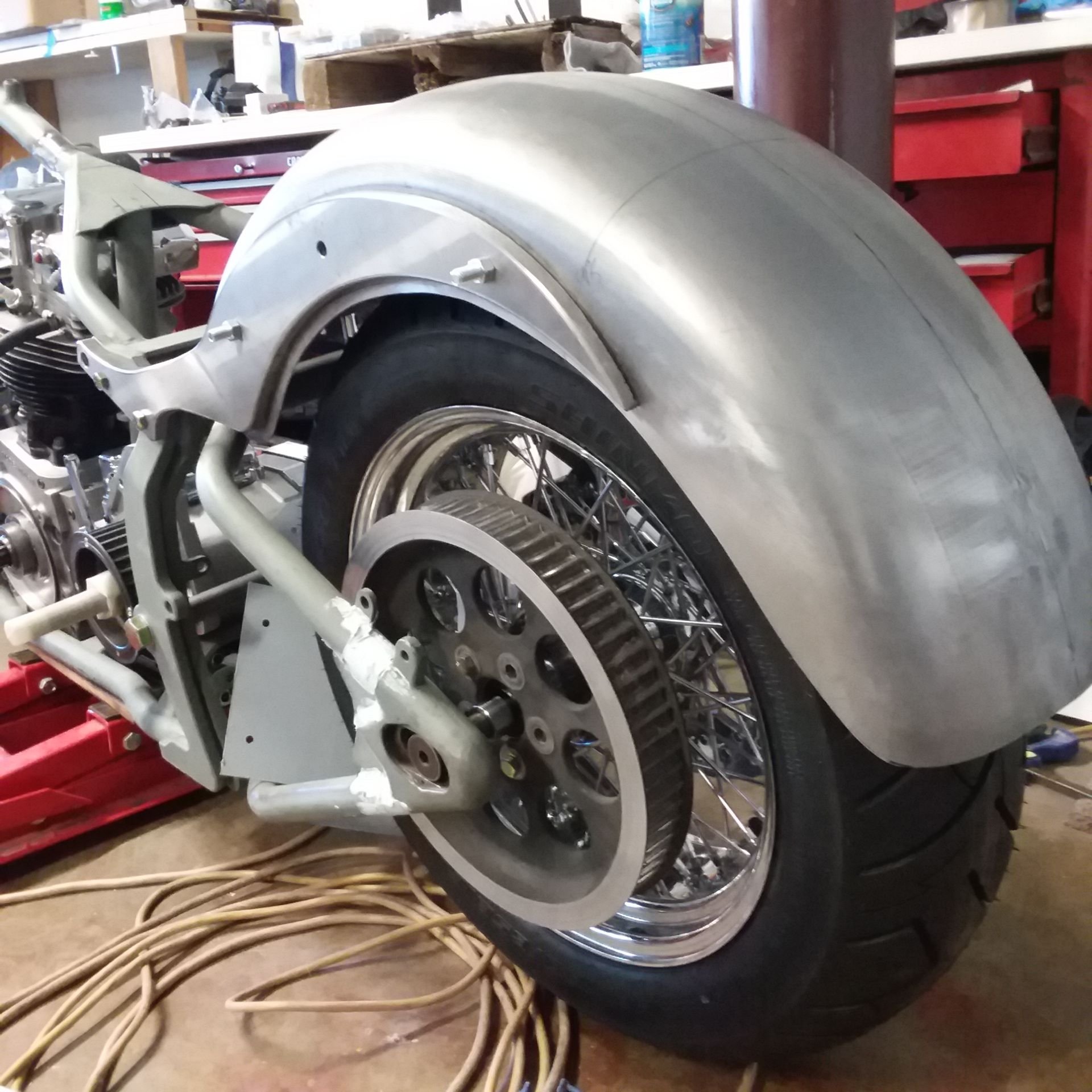

Had a little more time off so I mocked up the frame with the fork, motor and trany. Then I cut and fit the raw fender for it.
