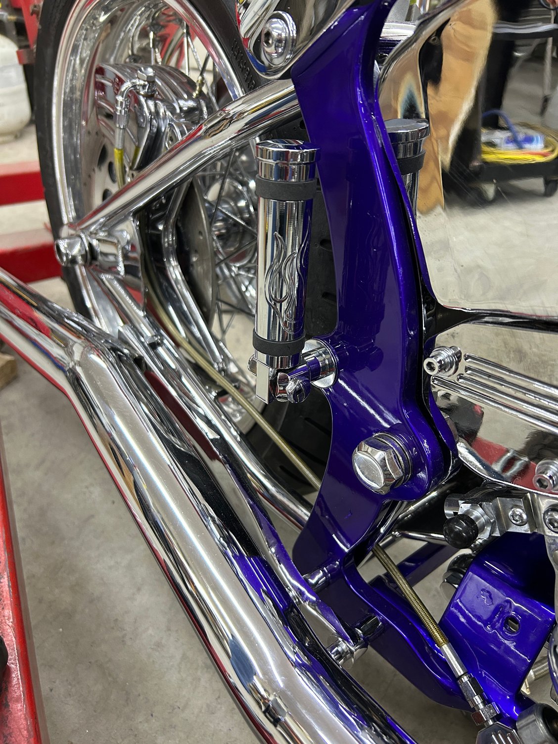

What brand are those rear shocks??
I belive they are Progressive or Pro 1

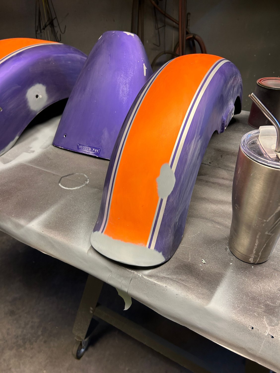

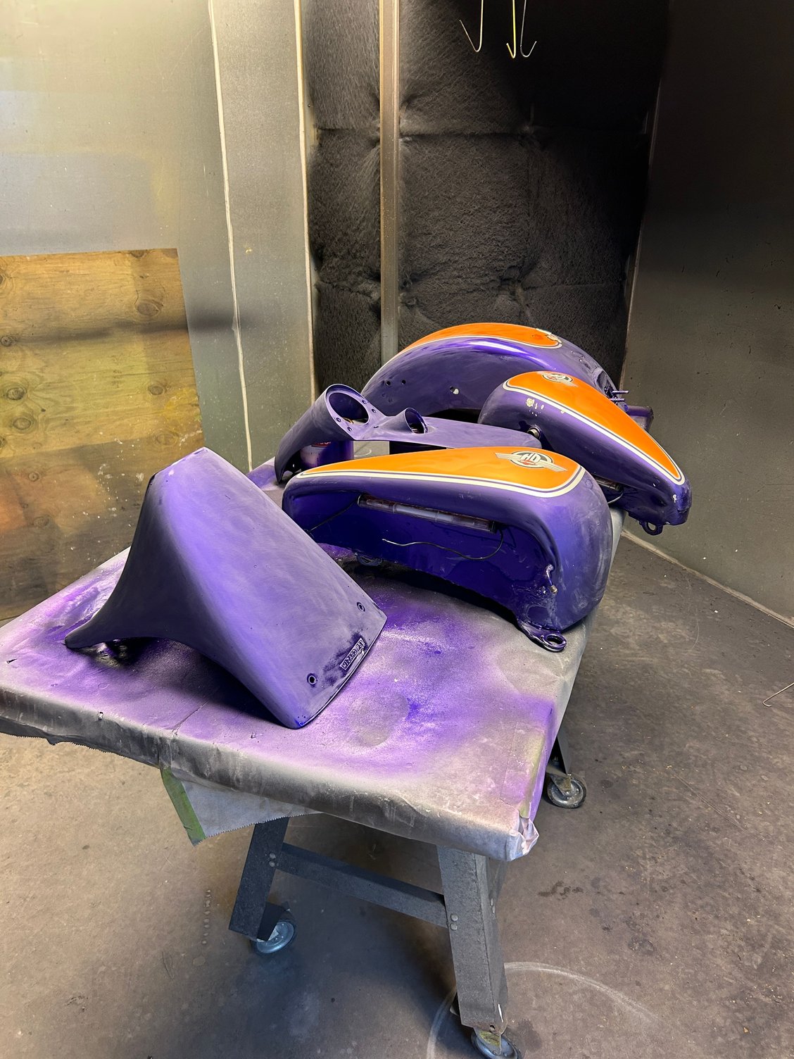

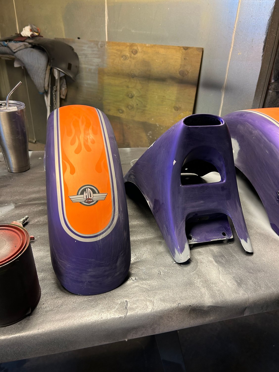

Well it goes slow and fast putting on parts
Had to strip the paint off the dash as it had to many deep scratches  in it
Fixing all the scrathes and chips and dents in the parts
more repair
more repair

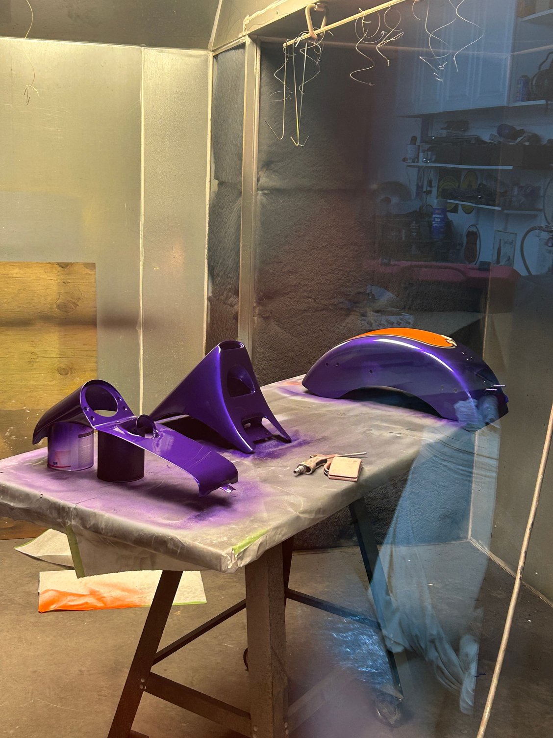

doing the touch up and painting the purple
Just a pain to fix all this stuff !

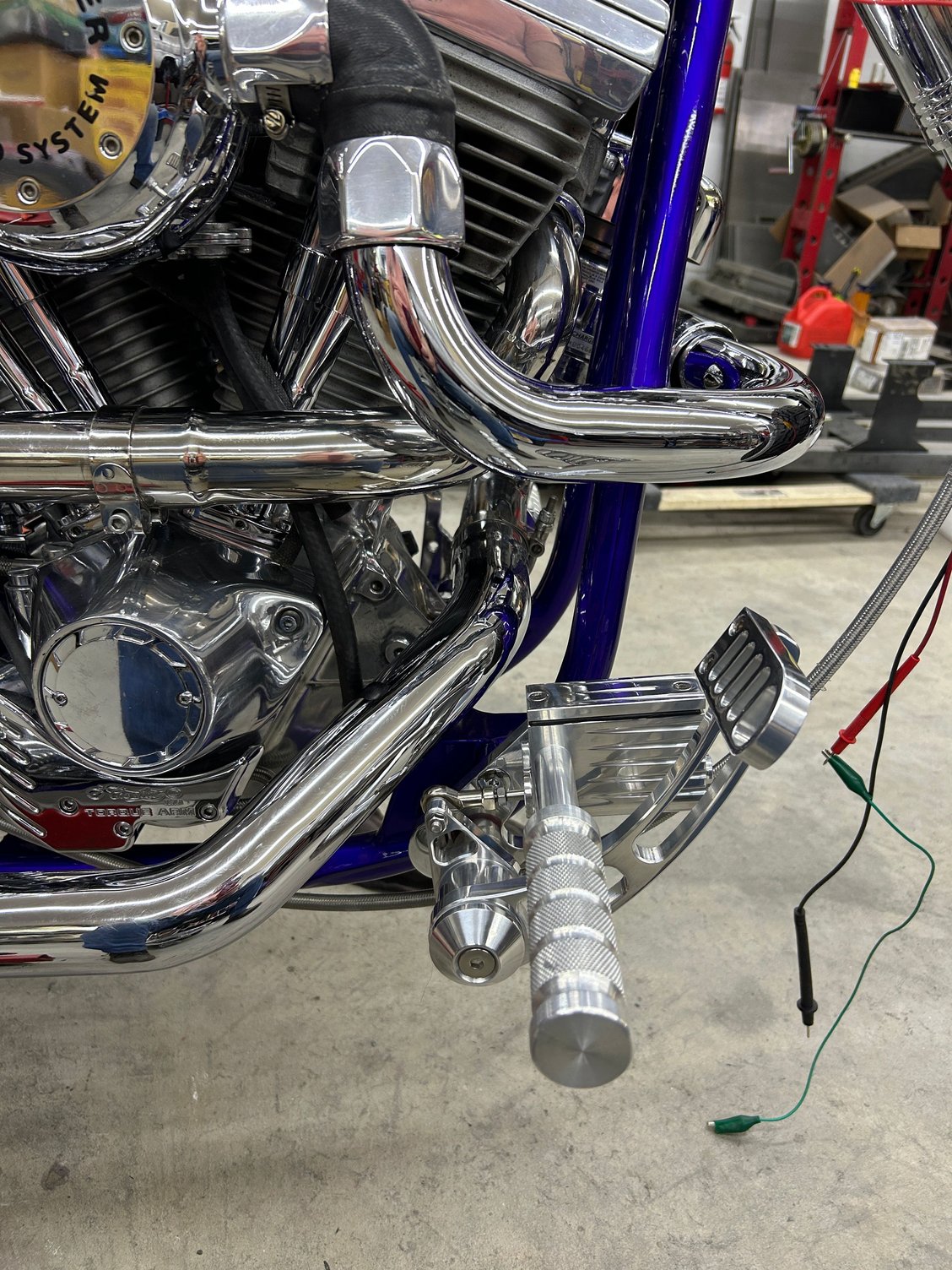

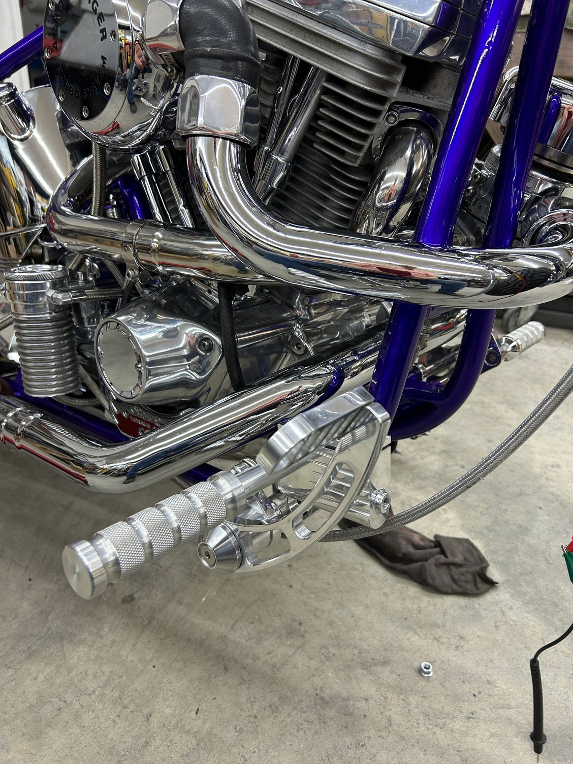

In between the touch up and drying of the paint was looking for the rear pegs but they seem to be missing as well as the front controls as the master cylinder and shifter missing with the brake cable and fittings ! Thought I got it all back but didn't .So ordered some new front controls w/master cylinder
Making sure they fit the controls
Making sure they fit the controls and you can see I polished the end of the foot peg and took off the lathe marts on the end of the foot peg as to the brake side as I didn't get to that one yet !
Took them boothof the forward foot controls off and polished them more as they really didnt have the finish as the rest of the aluminium parts
Took them both off, the forward foot controls off and polished them more as they really didn't have the finish as the rest of the aluminium parts as you can see the lathe spin marks on the end of the foot peg in this picture
Found these old Arlan Ness foot pegs  from about 30 years ago as they have been in the cabinet from one of my other builds that I didnt use
Found these old Arlen Ness foot pegs from about 30 years ago as they have been in the cabinet from one of my other builds that I didn't use
So they match the flames on the tank and front fender so what the hay why not ! They where free from the cabinet !!!LOL
Now just have to find another one of these fork caps from Arlan Ness as he made the forks ! Called them up and was told to send pics as they dont make them any more and they will look around and see if they can find me one ! Nice people up there !
Now just have to find another one of these fork caps from Arlen Ness as he made the forks ! Called them up and was told to send pics as they don't make them any more and they will look around and see if they can find me one ! Nice people up there !

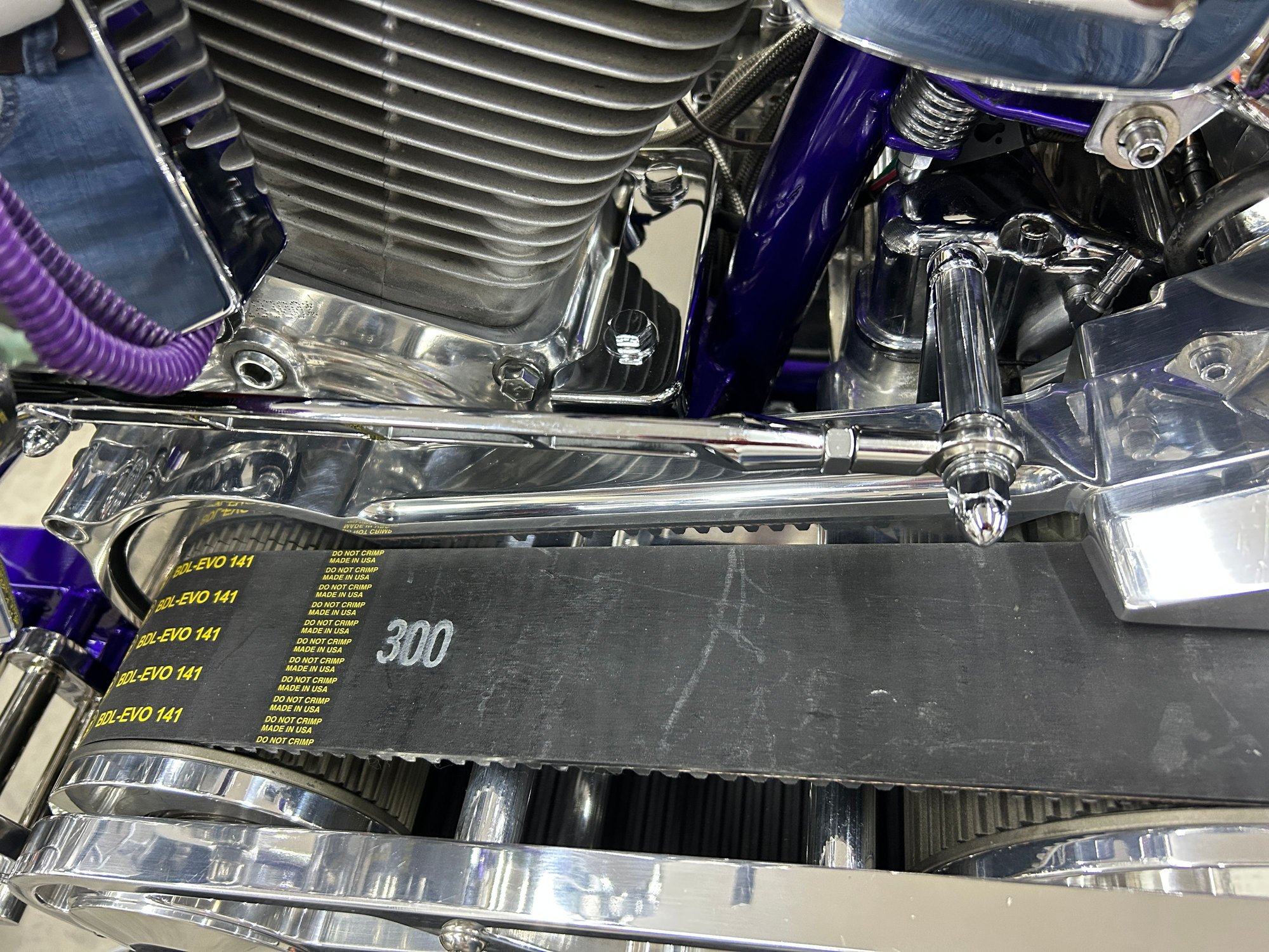

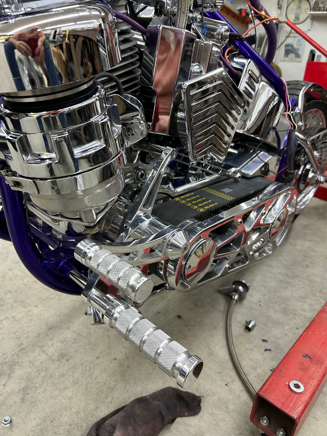

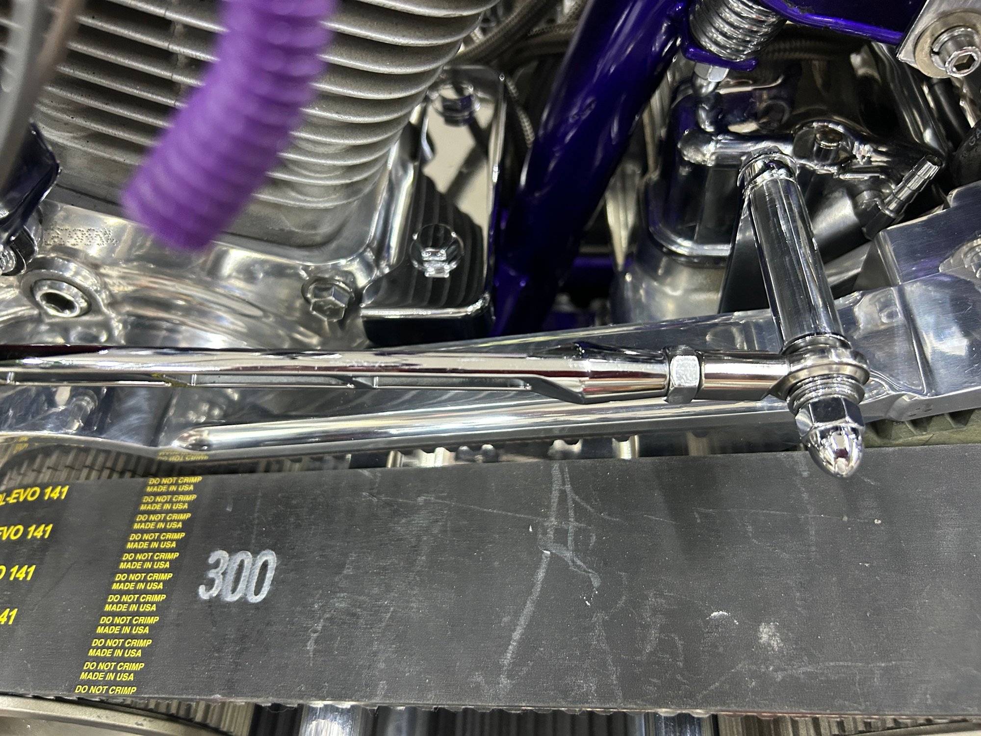

Well I thought I was doing good when I went to hook up the shifter forward controls as the shifter rod didn't match up to the transmission or the forward controls ! Well come to find out the bracket that bolts to the spline on the transmission was on backwards as I never took it off ! Guess the people that stole it messed with it. Also found out you can not slide the bracket off and turn it around as there no clearance to do it . So pull the belt drive off and the inner case .
so made some new spacers and took off a little material on the turn buckels as the forward controls are a little different  than the original ones that I didn't get back .
New spacer as the turbo hits the forward controls  so had to make spacers to clear it
Not much clearance as the rod runs under the horn and the fuel pump and other stuff
It works and time to put all the stuff back on

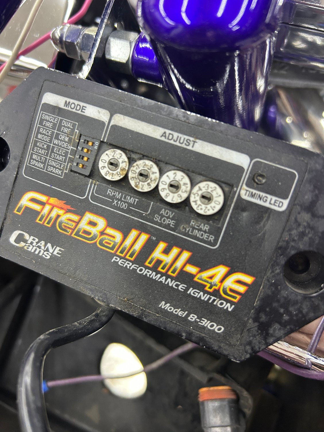

Didn't relieze that Crane Cams are out of business ! So wiring this back up has been a lot of researching wiring diagrams ! Not been a very production week  but it's done and back to painting  Saturday !

If you PM me your email I'll send you the correct pdf file for the Hi-4...

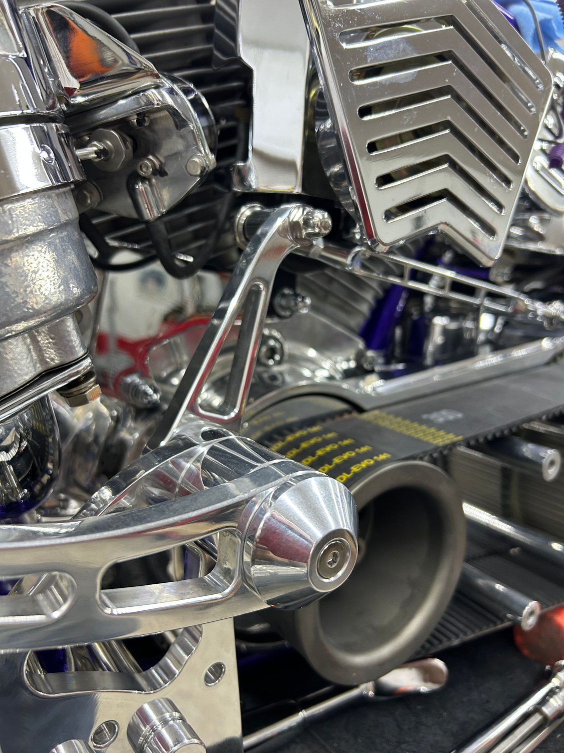

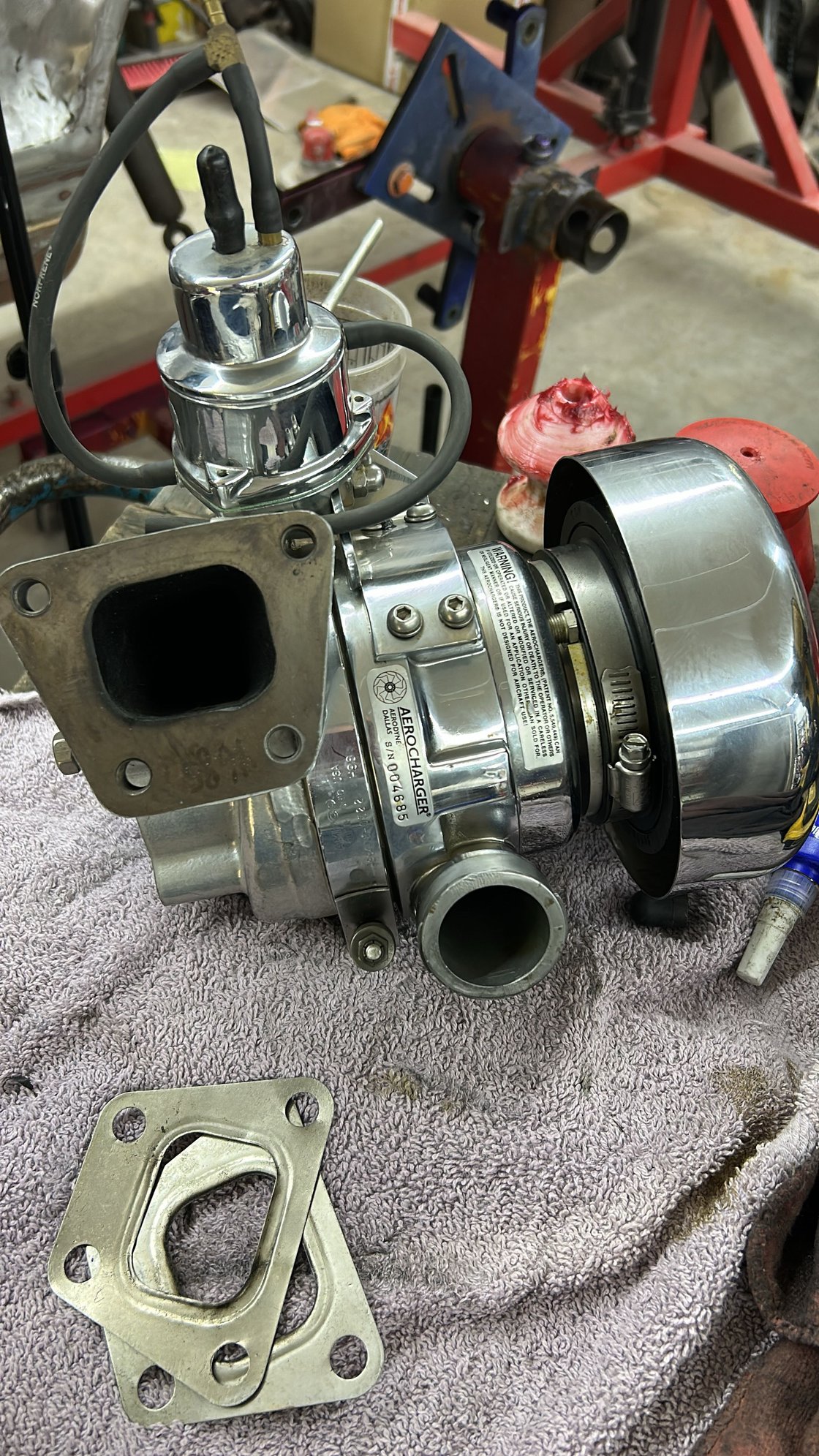

Just going to say that the turbo is cool ,but it has been a challege trying to remember stuff that I had to make for it to make it work ! I'm sure as It goes on I'll remeber at 2:00 am waking up thinking I remember that or I can make this to solve that problem ! Gee
Turbo pain !
Turbo pain !
Hard to see but you can see the spacers that I had to make to move the forward controls out  to clear the turbo  and not incuding the shifter rod on back pictures  as well as spacers for that too !

You did well with the spacers....
