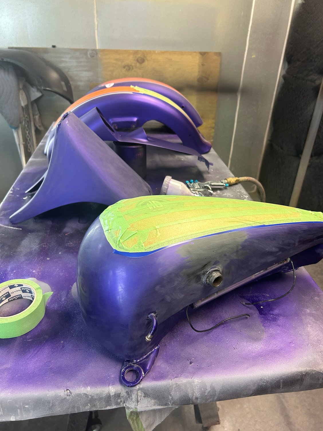

Well had to do more touch up as I saw some more scratches that I missed and tried to sand them out and went thru the paint ! Oh well **** happens !
retaping up as did a sand thru
Glad I still know how to paint with my roller !
Ready to clear tomorrow as have a little pearl orange to touch up on the front fender  and a small silver pinstripe .

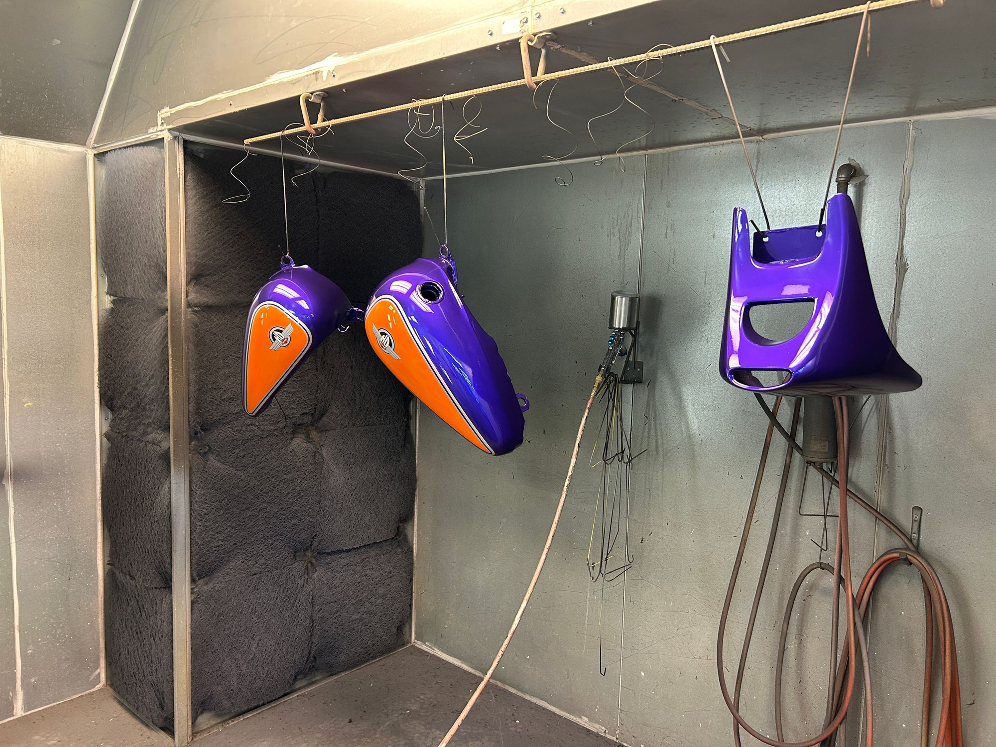

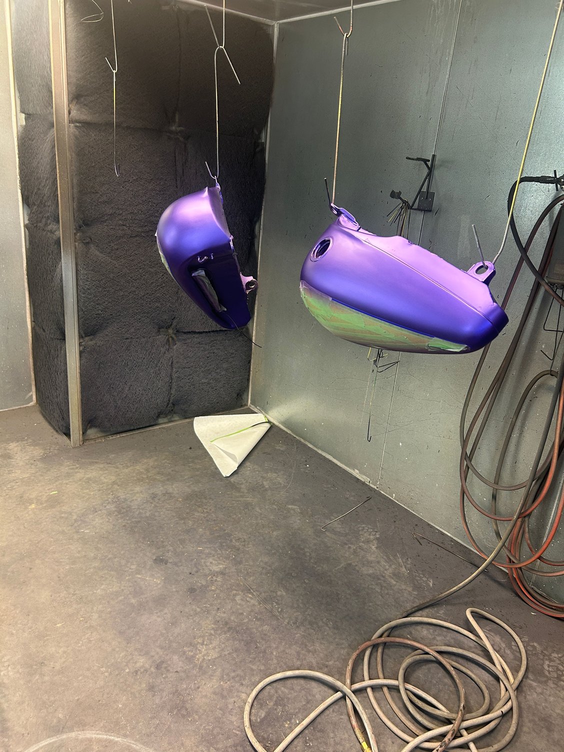

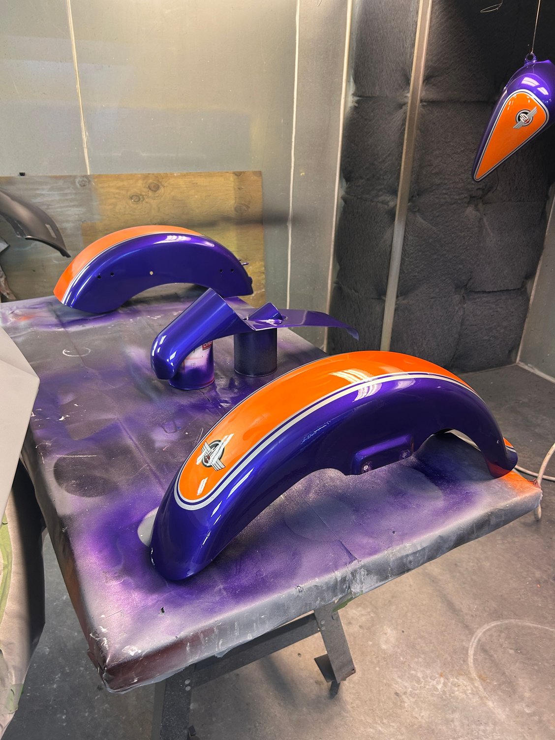

Well, got all the spots touched up and fixed scratches and chips, taken care of on the paint work one more time ! Had to fix numorus spots on every part as doing touch up on the purple pearl and the orange pearl and the ghost flames and of coarse the silver pinstriping and some of the art work on the Harley emblems and of coarse the Taz Turbo guy that I did on it years ago . But I'm really happy with getting it done as it's been over 30 years since it was stolen and getting my mind back to putting it back together makes me feel good ! So today finishing a couple spots on the front fender orange pearl and ready to clear by noon . About 3 hours of clear work and it's done ! Next week doing a little sanding and buffing and will be able to finish putting it together. Today was a good day as figured out the wiring that was cut and removed to finally get the high beam and low beam working and surprised my self that I did it !
look close and you can see the ghost flames as they start from the HD and go back
ghost flames also on the tank
Finally nice to see  the paint work done !
Touching up the purple pearl
Both tanks  touched up

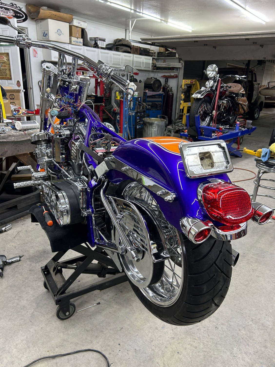

Well been a fun day wet sanding and buffing but got it done on the fenders and installed them with scraching them ! LOL
 front fender started out wet sanding  with 600 then to 800 then to 1500  then  buffing  3 stages
Rear fender  same thing wet sand with 600 then to 800 then to 1500 and buff 3 different compounds  wool pad then a yellow wool pad then a foam pad
fitting tail light gasket on

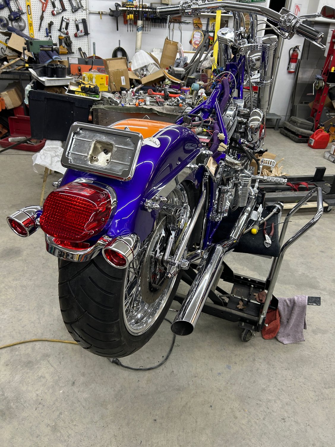

Put lights  and turn signal bar on but the day starting as I forgot to run the wires so take off the fender and run the wires thru the inside tubing in the fender !
Putting on the front fender
have to fix the wiring as the rear fender electrical plug is 2 inches short of plugging in so must have the terminal boards backwards up by where  the tanks between them .
tomorrow play with the wiring and fix it as had a fifty fifty chance if I put the terminal boards on right ! Oh well **** happens as the bike was in boxes when I got it back and memory 30 years ago isn't perfect but it's falling in place .

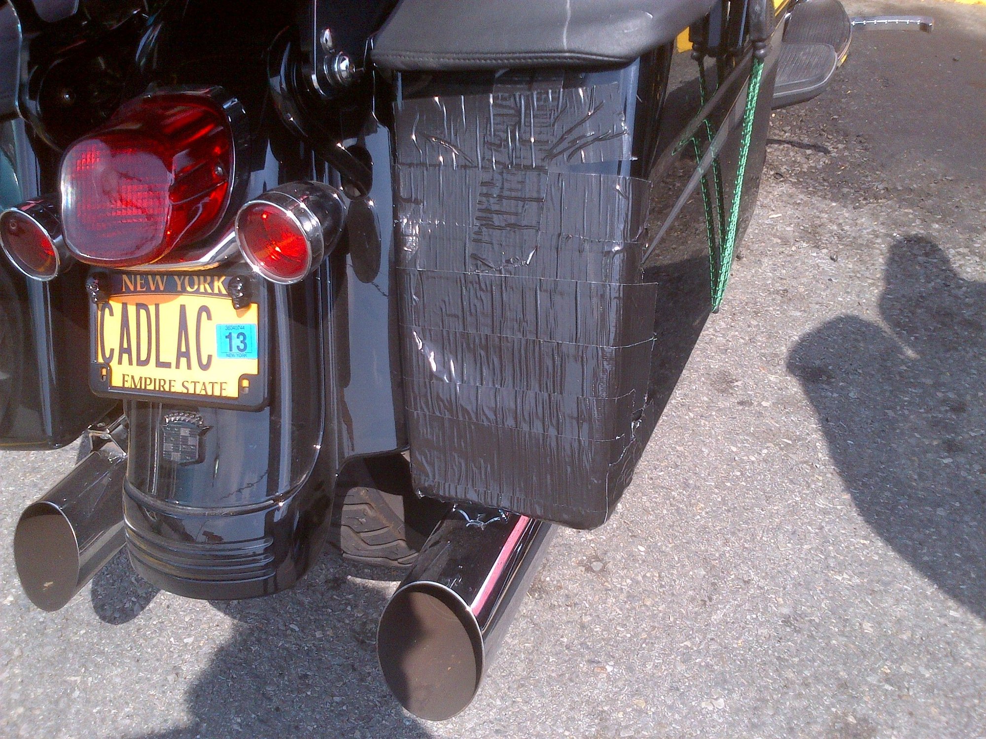

Bike looks great, very period. Quick suggestion, the turn signal bar you are using is for a factory bike that had a license plate below and therefore has the lights down to illuminate the plate. I am sure you didn't hook them up, but my point is it is bulky. If you find the similar light bar from a Road Glide which had the license plate above, the bar itself is smaller with no light. just a suggestion. I would assume it would bolt right up same as the one you have installed. Bad picture of the one on the back of my 2005 Road Glide.

^ Gotta be a story behind that saddlebag
