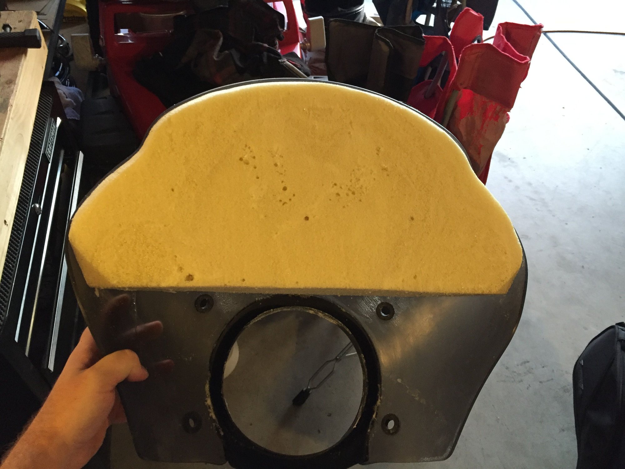

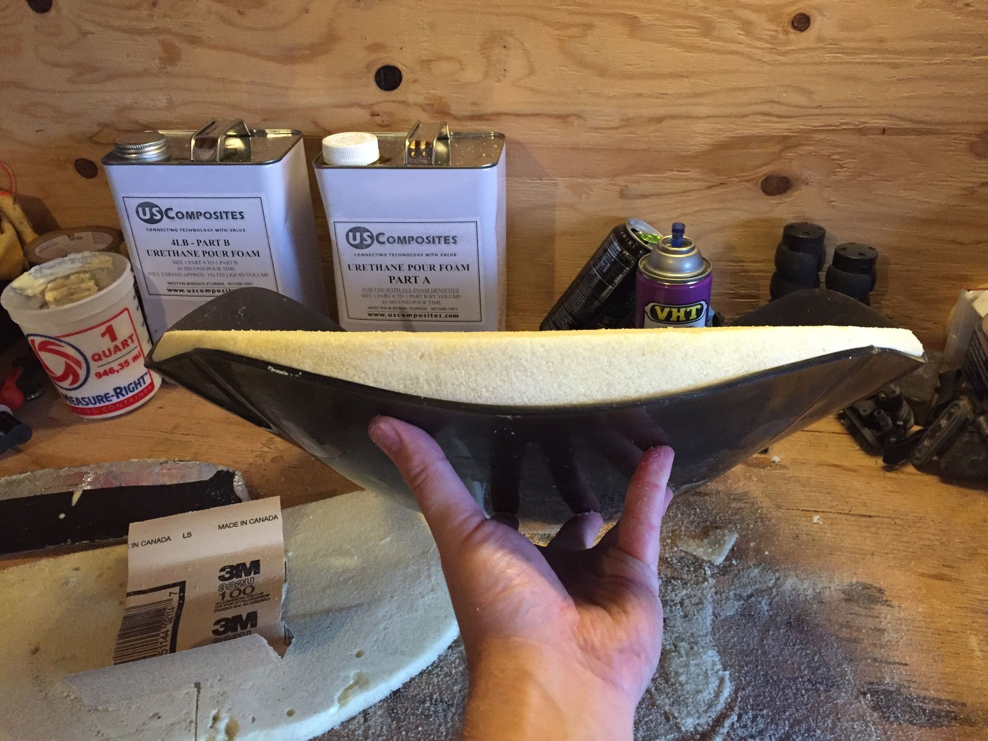

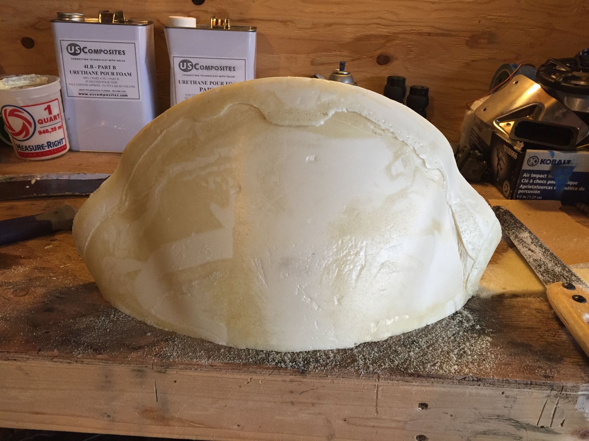

What type of glue did you use to glue the foam to the inside of the fairing, which allowed you to pull it apart later

I used a spay glue ( locktite 100)
More important than the glue though, I covered the entire outer shell with clear packing tape ... After I got the foam how I wanted it , I covered the foam with packing tape as well ... Fiberglass WILL NOT stick to packing tape ... The foam will be pretty much destroyed when you pull it apart but it comes apart fairly easy ... The glue isn't real strong which is why the foam was destroyed , but it also didn't melt the foam was why I used that kind .
Any foam stuck in inner or outer can easily be removed with a splash of acetone
