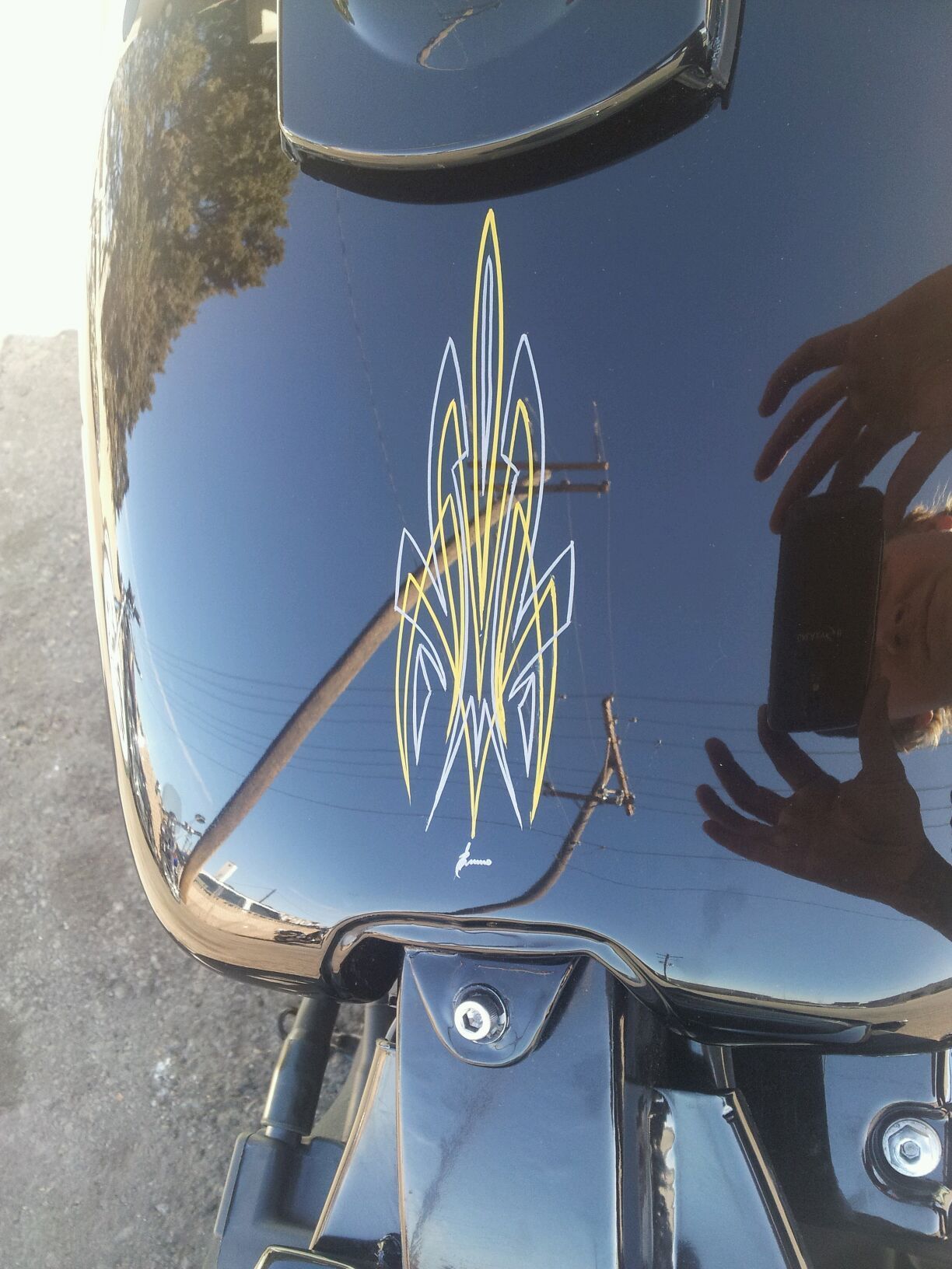

I couldnt find anything without going custom
So i pulled the bib,smothed and painted the tank.I can live w/the gap under the console.

If you really want a different console, you will need to swap the tank. All Dyna tanks interchange and will bolt right up to your frame. I wanted the Super Glide aircraft fuel cap, swapped the tank and console, it works perfectly.
I think iI paid less than 200 for a complete tank and console setup, and no special mods were required.
