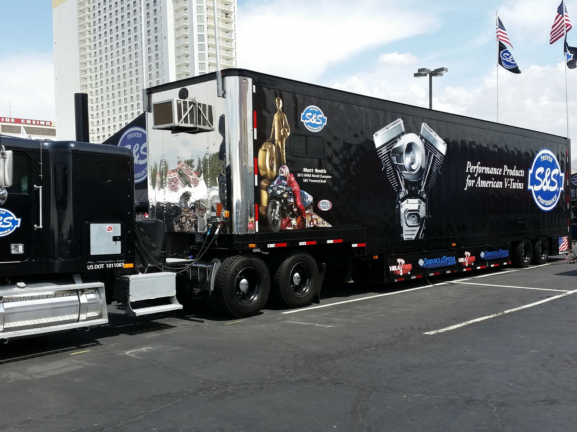

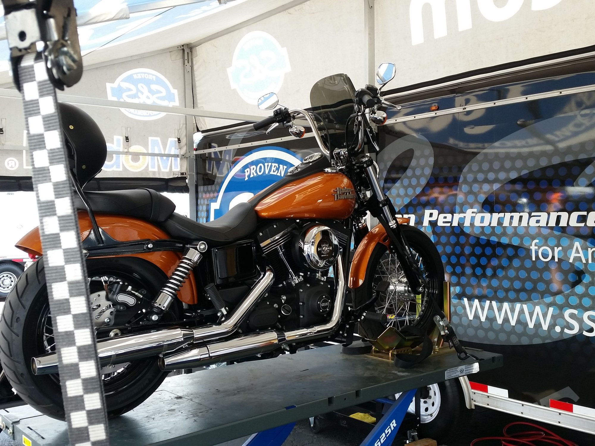

While at the Laughlin Run last week I had visited the S&S trailer booth, got tapered slip-ons, Stealth a/c and the S&S/Vigilante tuner - which they highly recommend since I don't plan on doing any other engine mods. Bike runs amazing, no pops burbels or hick-ups. I find it hard to believe that a tuner isn't a necessity on these bikes but who knows, I haven't ran it without the tuner. I got a great deal on my parts and everything was installed right there for free, they are even shipping my stock parts back at no charge. I couldn't be happier with the results or the S&S customer service I received.
