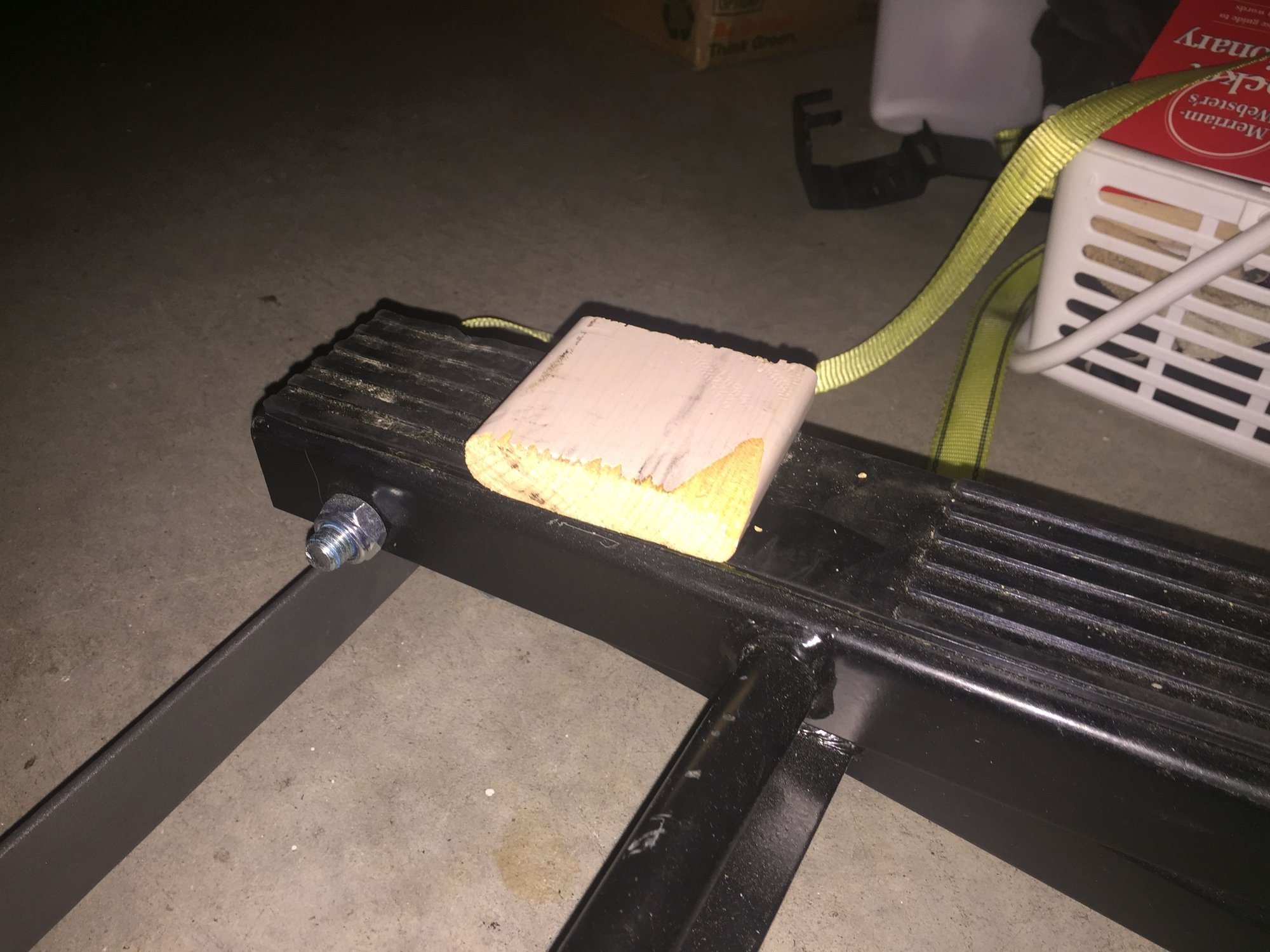

Need to replace my front motor mount and this seems like the one to go with.
I have a scissor style jack, would anyone happen to know if I would be able to put a block on the jack to use to jack the motor up (just the motor) while the bike is on the jiffy stand?
Limited resources here and hate having to go to the hobby shop or taking my bike in for someone else to work on.

Yep, worked perfect for me with harbor freight jack

I think the angle of the bike on the jiffy stand may cause some challenges with using the scissors as your motor brace. But if you can put something under the jiffy to get the bike basically vertical it might work.
I remember I had some problems and ended up using my jack only to get the bike vertical and as a brace, then used the bottle jack from my car with a small piece of wood to raise/lower the engine while aligning the mount.
So to make a short story long, I think it could work without a normal jack but it might be a little problematic

Ill do a mock setup and see how it works; if looks like it may be too risky then I will just call one of the Indy's out here and setup a time that I can have them put it in while I wait. Do not want to have my bike sitting around in someone's shop for 2-3 days for an hour worth of work. Thanks for the input!
