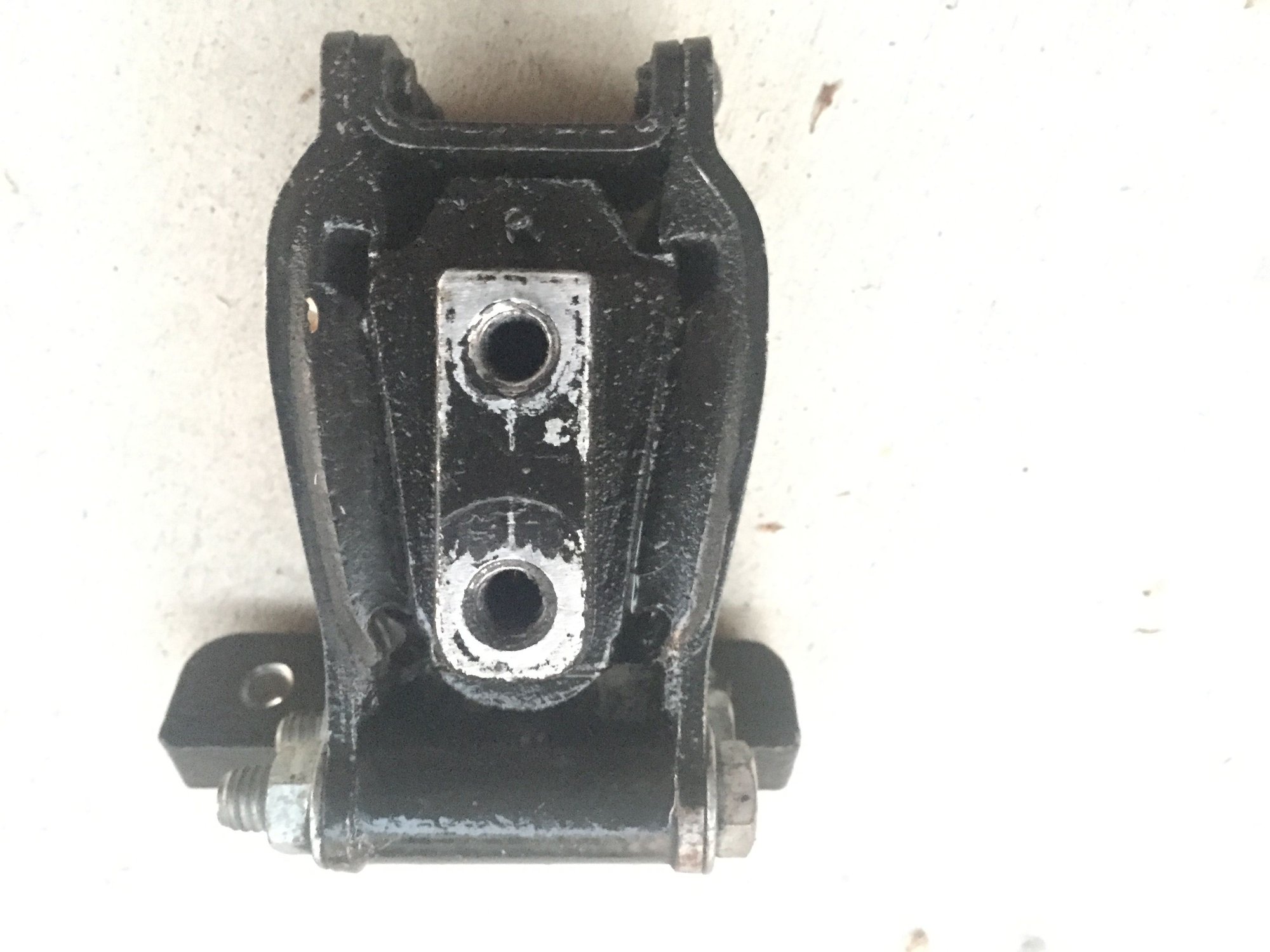

I recently installed mine - super easy if you take off oil filter and put 3/4" piece of wood under the motor on the Seers or HF jack. It keeps motor in place even when you take off mount - couldn't believe how easy it was after that.
My wobbles are cured - main reason why I did it. My GF said it got smoother. Definitely feels better on handlebars, on pegs I think vibration got different. similar to what I got with shimmed OEM mount
