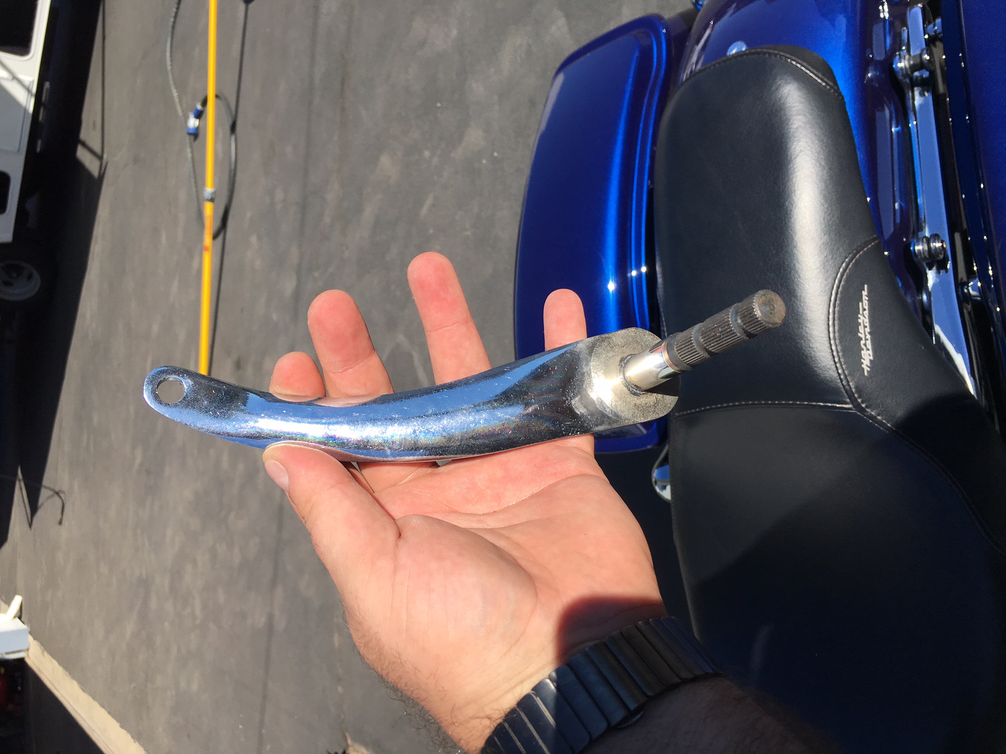

I have not found any part from Harley that would allow you to add a heel shifter to the FLD without some kind of modification. After searching and reading I have finally completed my Heel Shifter MOD on my 2015 FLD. I have attached all the items you need to purchase that i managed to find on eBay. The only part you are not required to purchase is the FLD shifter lever but I did so I can always go back to the stock config in the future. The reason you need the extended shifter instead of 2 standard size ones is because of the shaft not being centered with the floorboard. I tried 2 standard size ones and my size 12 foot had a big problem fitting. take a look at the pics and I'll be happy to help. I hope this gives you a new project!!

TIgerMike87 - Did you require a new linkage rod? I don't know why I'd need one but your's doesn't look like it's stock in the pic. Also, it appears that the stock toe lever would still work with the extended heel lever, but the two wouldn't match in appearance. Is that why you replaced both? Great post.
