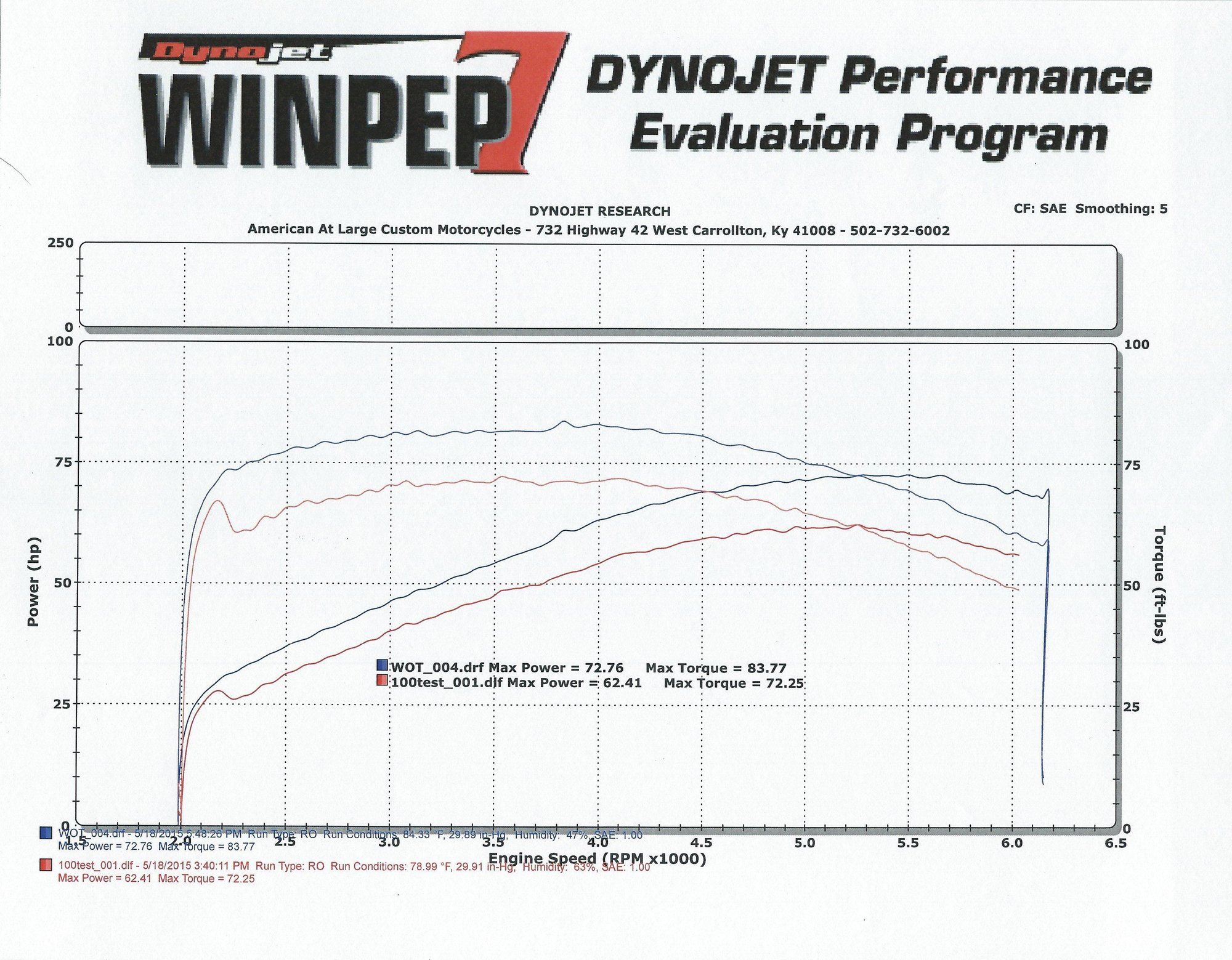

Here is a before and after a Power Vision dyno tune. Base is V&H Straight Shots and an AN air cleaner. About a 16% increase across the board just with a tuner and some dyno time.
