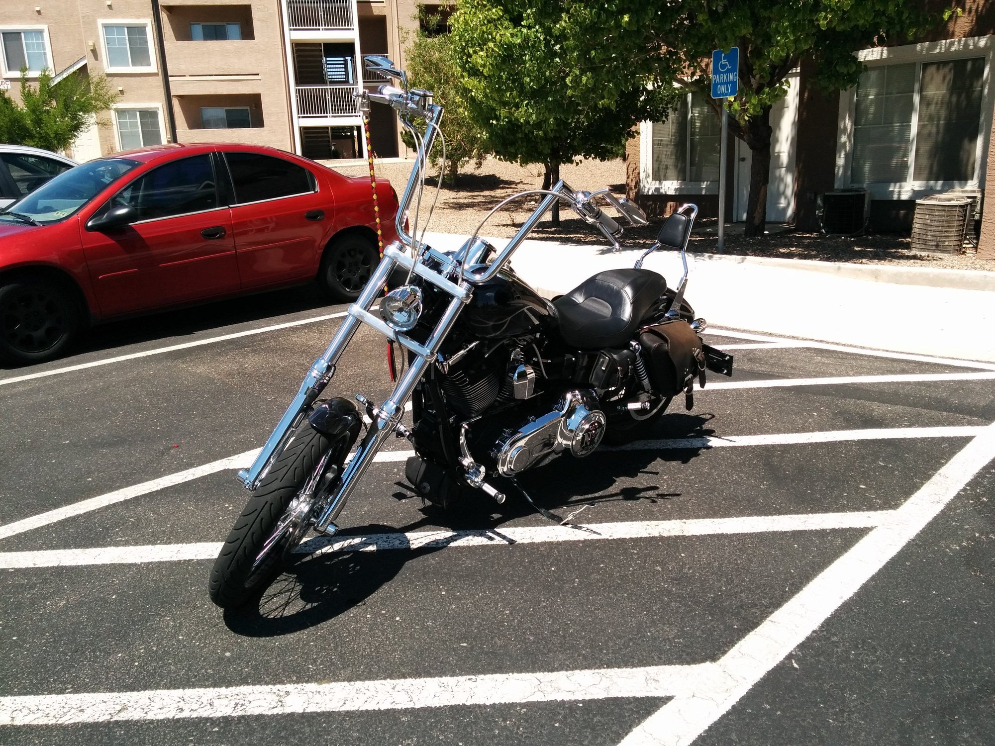

I am now running LA Chopper 16" Twin Peaks bars. Really nice quality and super easy to wire internally.

Wiring was long enough for the 16" bars pictured. As far as cables and brakeline goes, here's my setup:
16" LA Choppers Twin Peaks handlbars
1.5" chrome risers
Barnett +8" SS throttle/idle cables
Barnett +6" SS clutch cable
Barnett 49" SS brake line (OEM length)
