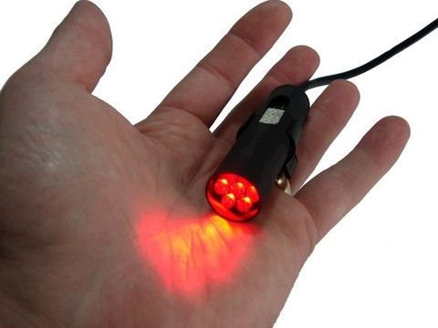

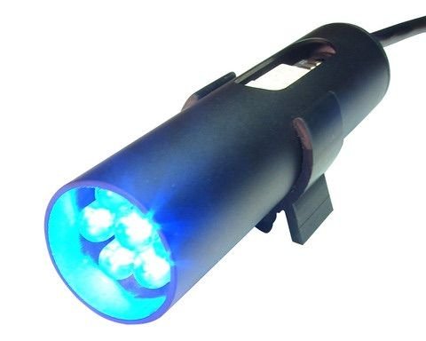

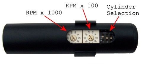

Ok guys so I want to get a bit more help to optimize my shifts, so I just got the Raptor Shift Light.
Two questions:
I have buffalo bars that are 1.5" thick, so what clamp can I use to mount the light?
Ground & power I get, but what's best for RPM signal? Can I just get it all from under the dash wires?

I used a wire at the coil for signal. The wire going to the speedo is a data line, not just tach signal.
I made a bracket to mount to my risers, not sure what you could do on your bars that would be clean. I was originally going to mount it on the front side of the dash but I felt that was too low, out of my line of sight. Maybe figure out a way to tuck it up in your fairing? I wired in a connector right off the shift light too so I can unplug it and put it in my pocket in the rain or when washing the bike.
