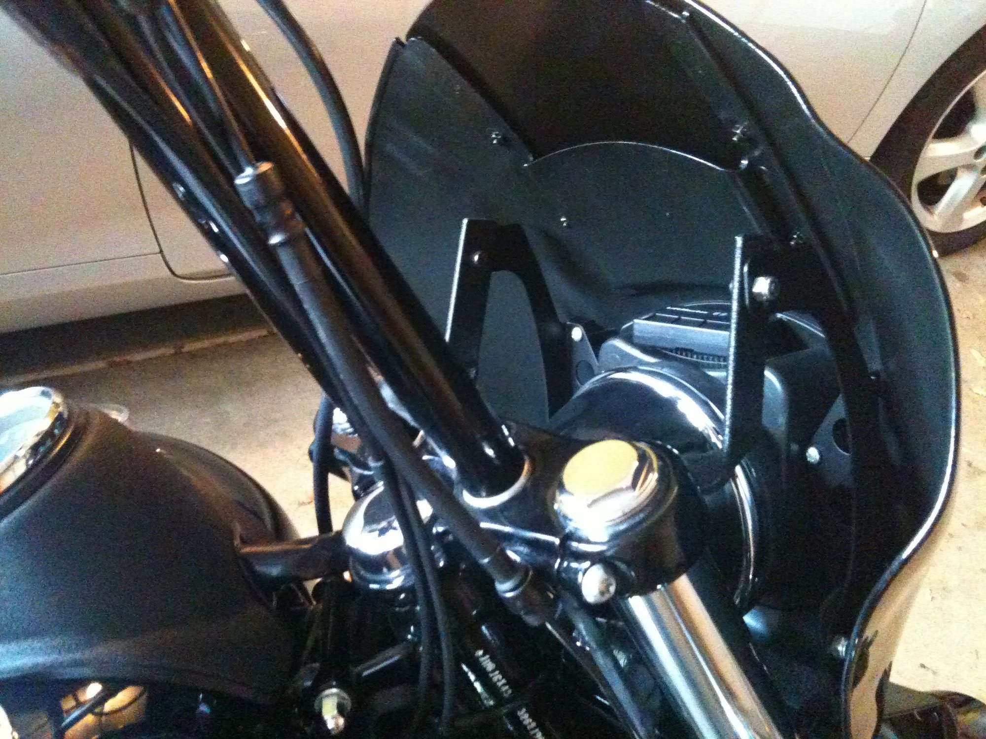

when I had my ź fairing attached it was done with flat stock using the riser bolts and headlight bolt. I can't find a picture showing the lower attachment.
Wow! That is much thicker steel than I was considering running. Great to know there is enough thread to add that thickness. This should be an easy weekend project now. Bending the flat to fit and junking the stock bracket all together might be a good route. Thanks for the pictures.
