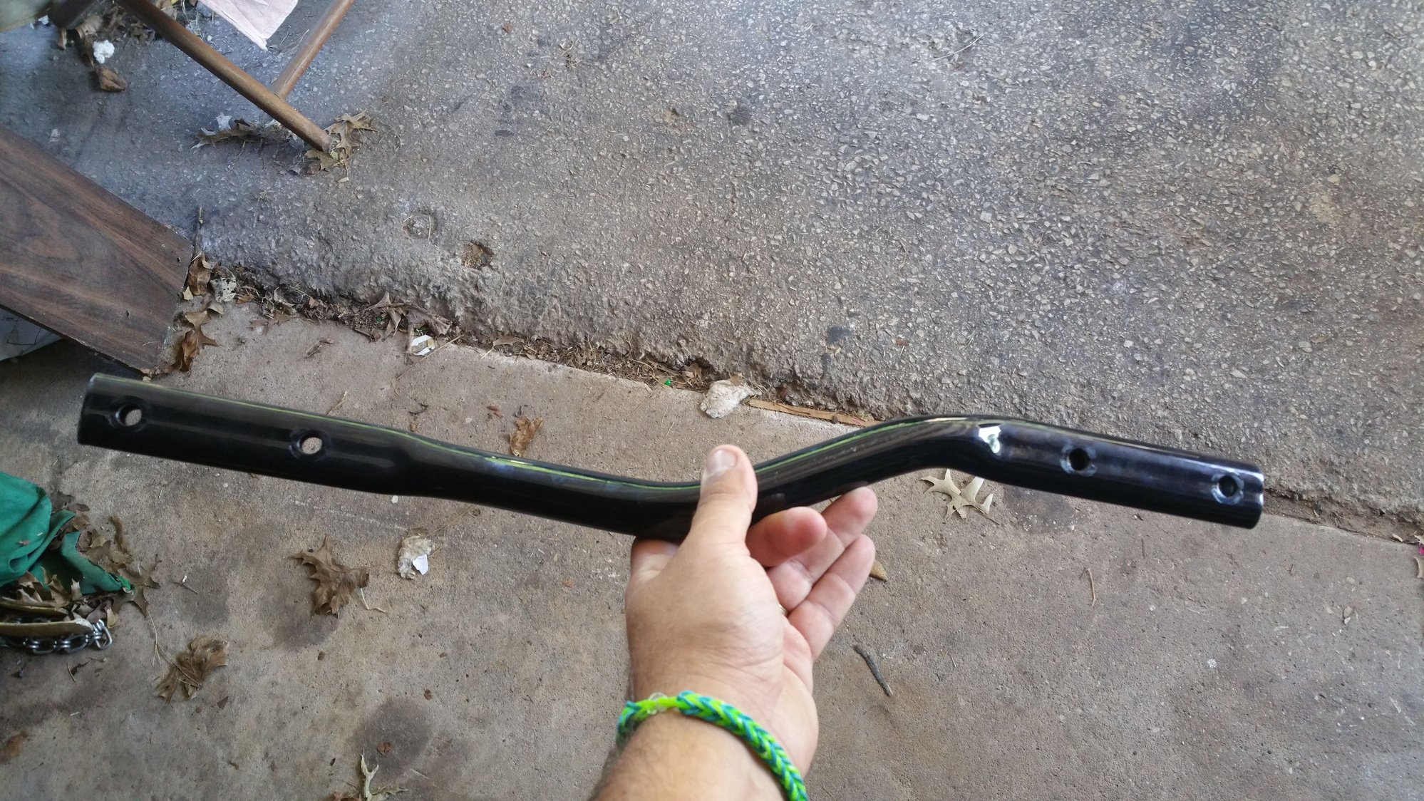

This is the bracket im talking about. The new slip ons bolt pattern is to small for the bracket.

Can you post a picture of the back(mounting) side of the slip ons? You may have slip ons for a fat bob or wideglide.

I think they came off of a wideglide the more research im doing on them

A pic of the muffler mount would help, but they should come off until you figure it out. I would put the stockers back on, with the bracket, before you leave some shiny parts on the road.
