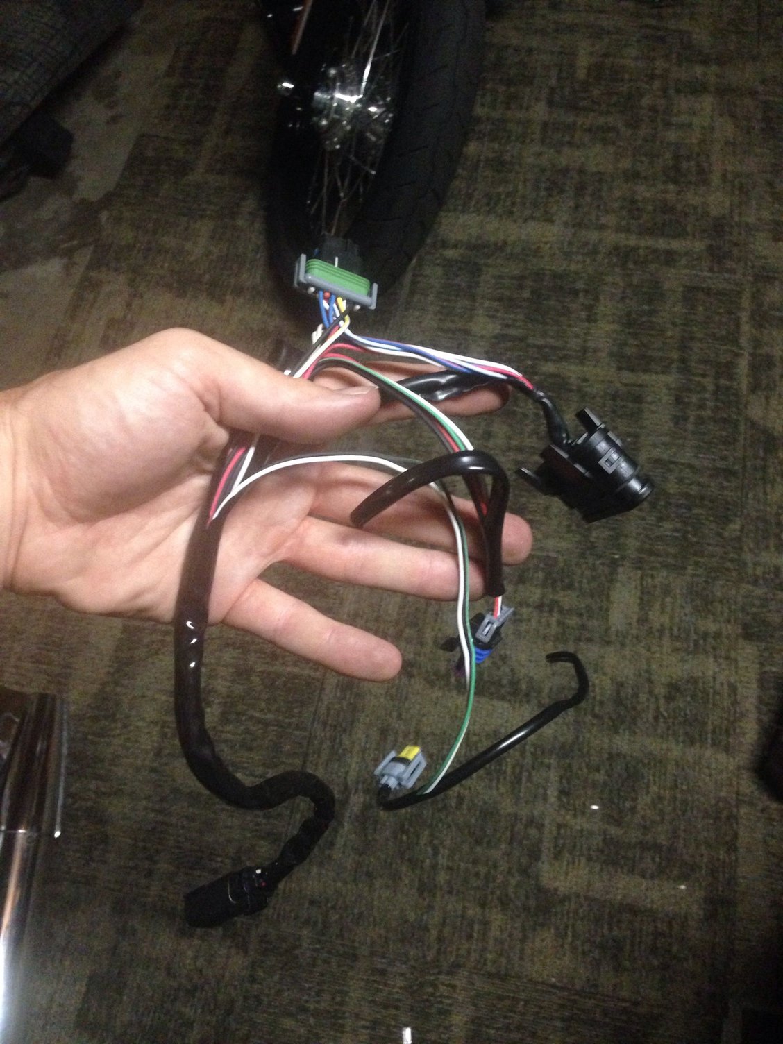

Ok so I had another thread on a auto meter tach.
Didn't work with canbus....
So I'm relocating my stock tach to the handle bars
I have used an accutronix 1 1/4 bar clamp and 3 3/8 gauge mount
First step is going in the neck and disconnecting your harness that goes to gauge, ignition, fuel pump and dummy lights
So far I have extended my fuel pump and ignition section of harness
Have to finish the gauge section and dummy lights before harness is complete
Here are a few pics. I have extended 2.5 feet of cable. Way long but I want to hide the harness clip in the neck like stock

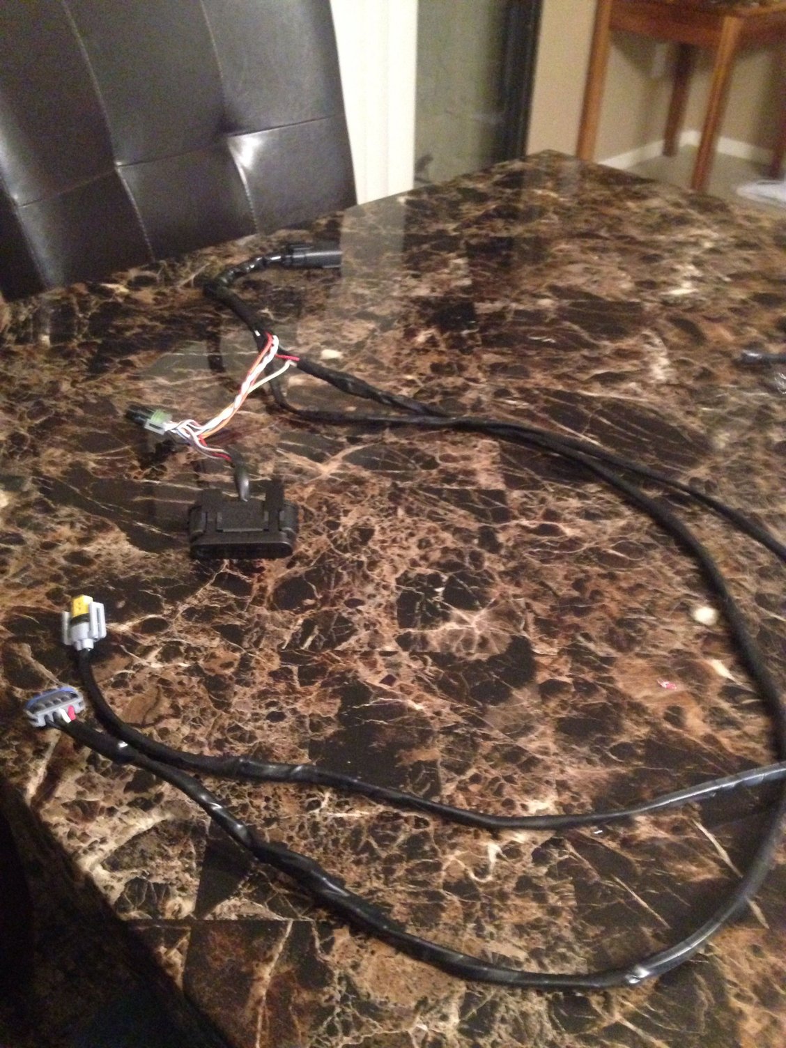

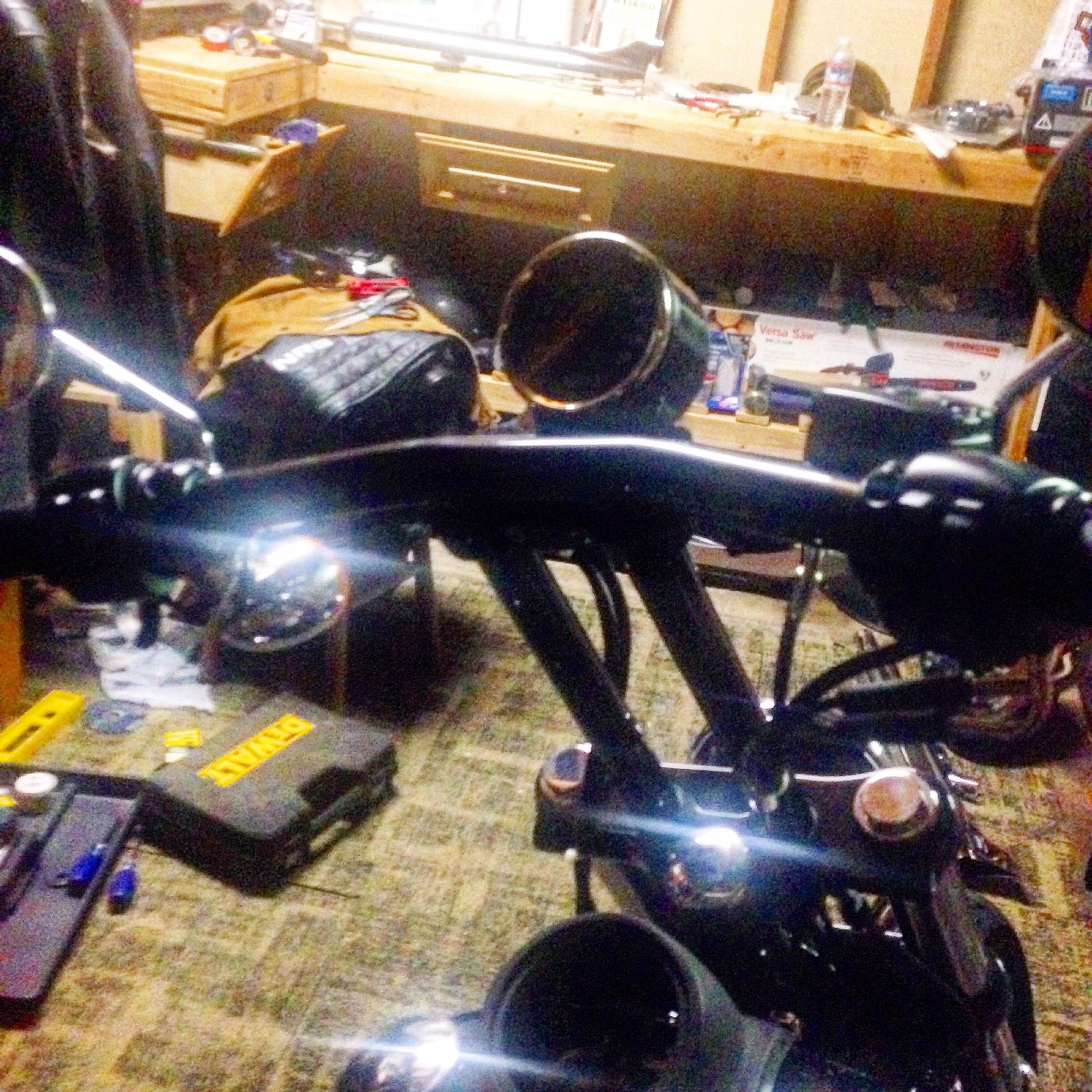

Ok so first pic is of stock harness stock length
Then with sections extended with 16ga wire. Soldered and heat shrink

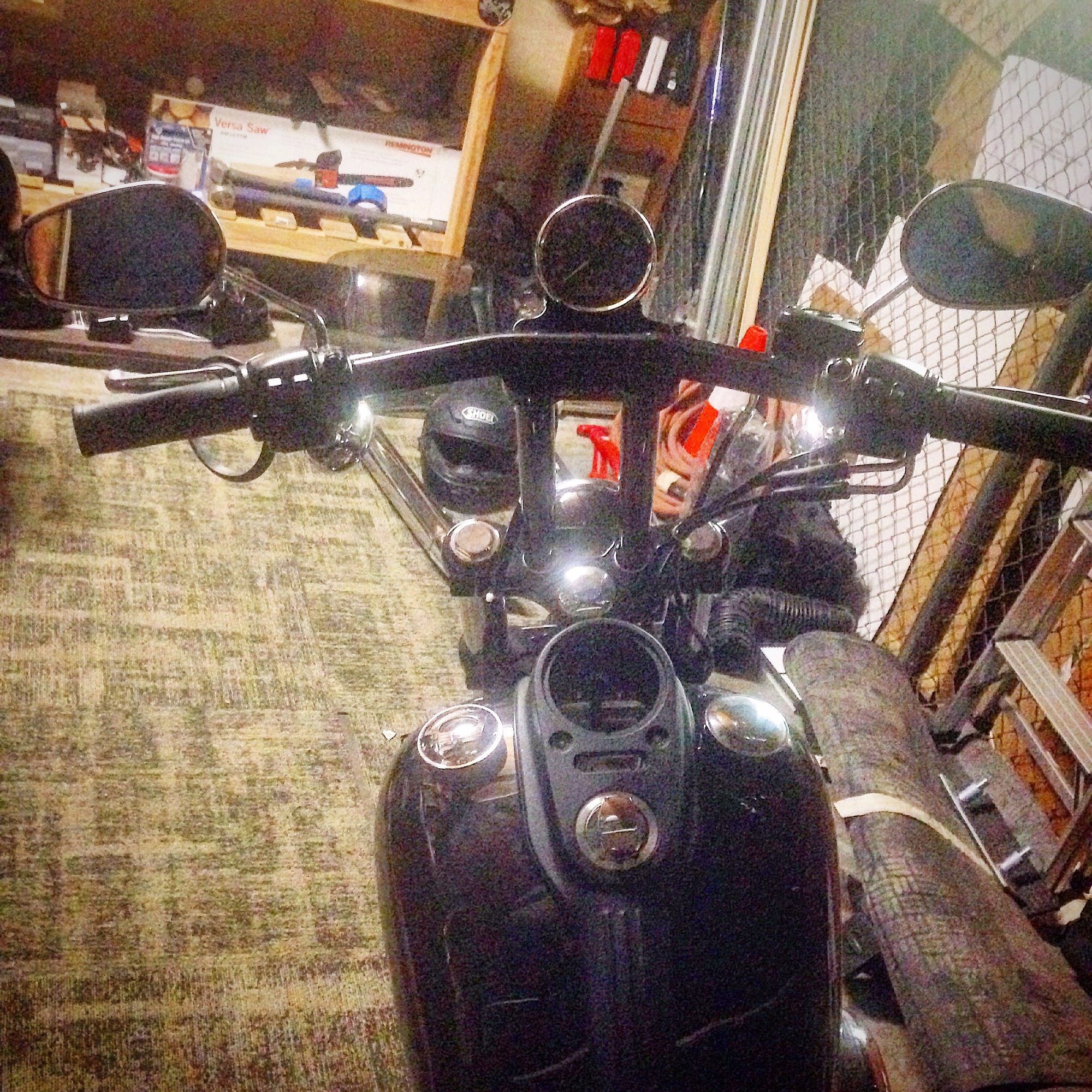

Other pics of mounted speedo/tach to get my positioning correct

Ok. That took to long. 2 days at night. About 4-5 hours total. I ran out of solder so that added a lot of time finding a 24 hour store that had solder
So I'm going to blank the old gauge hole. As of now everything works. All connections heat shrink and solder
Really was not hard but still a little bit of a pain towards the end when I was tired
Was it worth it.... Hell ya. I always wanted handlebar tach on my last Dyna. Now I just need a fairing like all the other cool kids at school

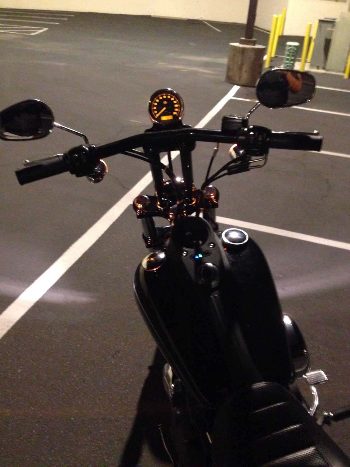

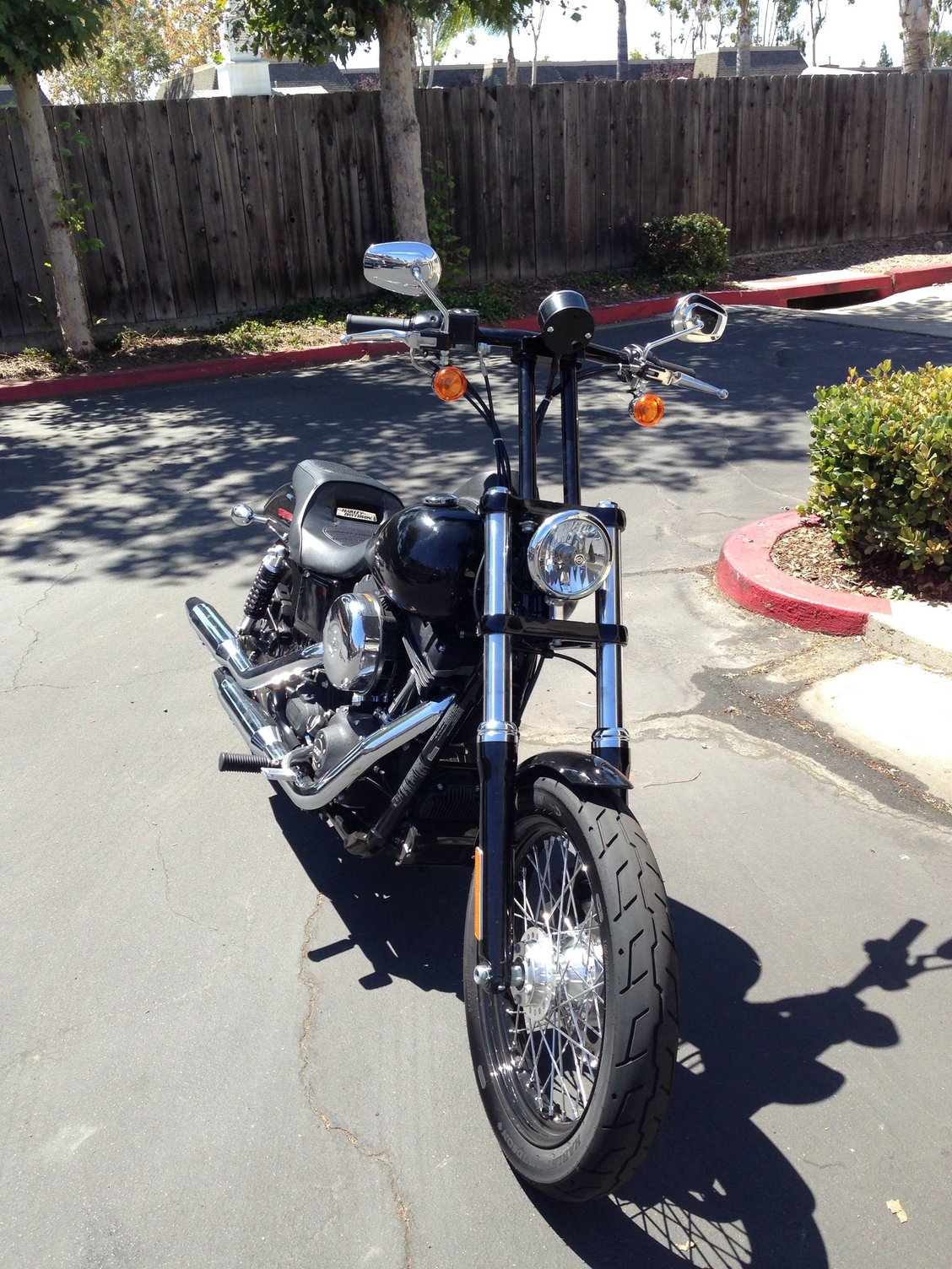

Added some pics on above post of finished install. No problems with can bus to just re wire the harness so it's longer. I made it way to long. But it's all good

Is it blocking your field of vision or do you look right over the top of it.

Not in my way at all. It's great having a speedo/tach in eye sight. Looking down all the time I didn't really like
You know, I was thinking a cup style holder in the dash. Something I could hold my phone in that's not on the bars
