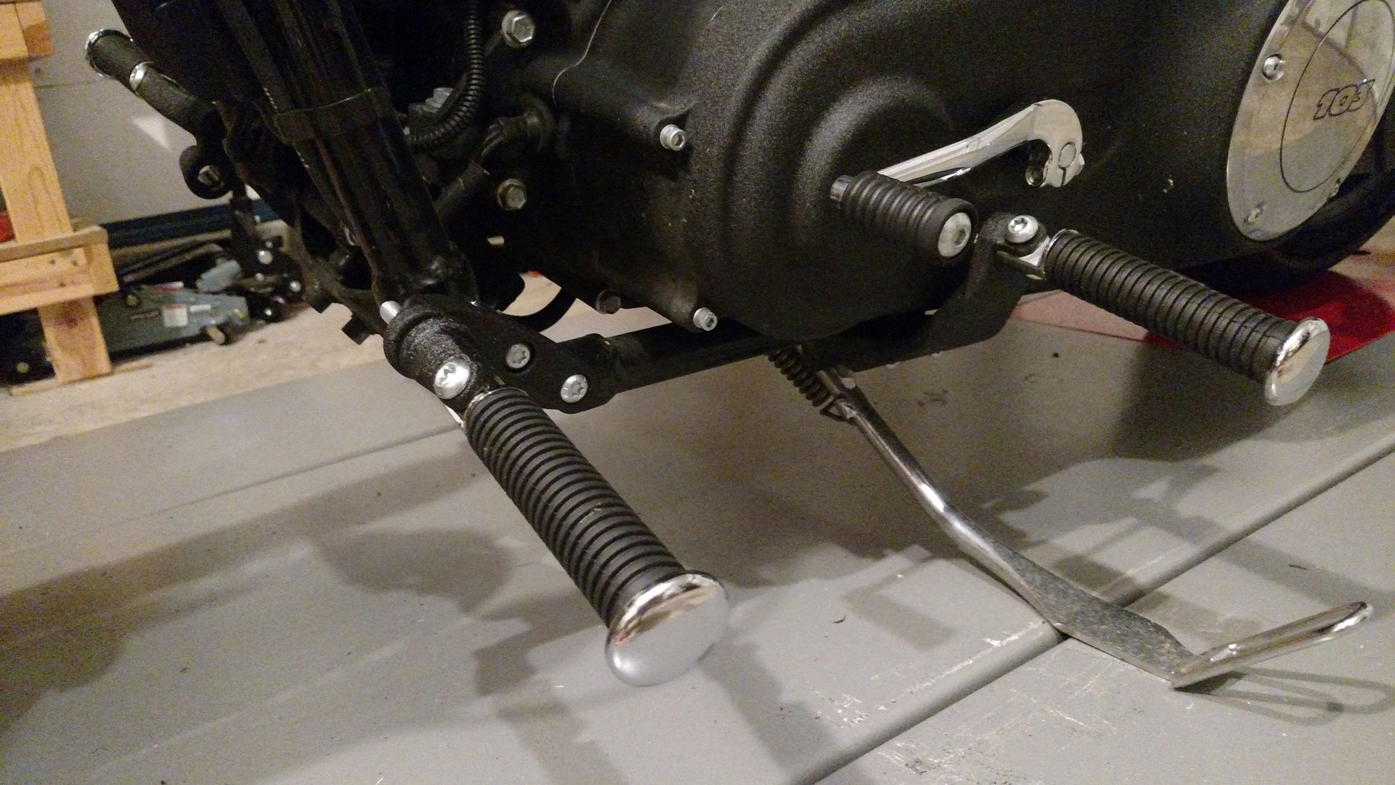

Thanks for all the replies. I guess I should have been a little more clear. Here is s picture of my current set up using the DK customs mount. I basically just want the pegs from the forward controls, no brake or shifter pedals. If that makes sense.

Haha, I know. I just don't like the look of the DK customs highway peg mount. Not their mount specifically. I just don't like how far out they stick and the right side is hard to get comfortable with my air cleaner cover in the way. I'm thinking just using peg mounts, like off a fat bob would be better. A more clean and low profile look.
Here's what I have on there now.
http://www.dkcustomproducts.com/Stea...DK-SHP-BLK.htm

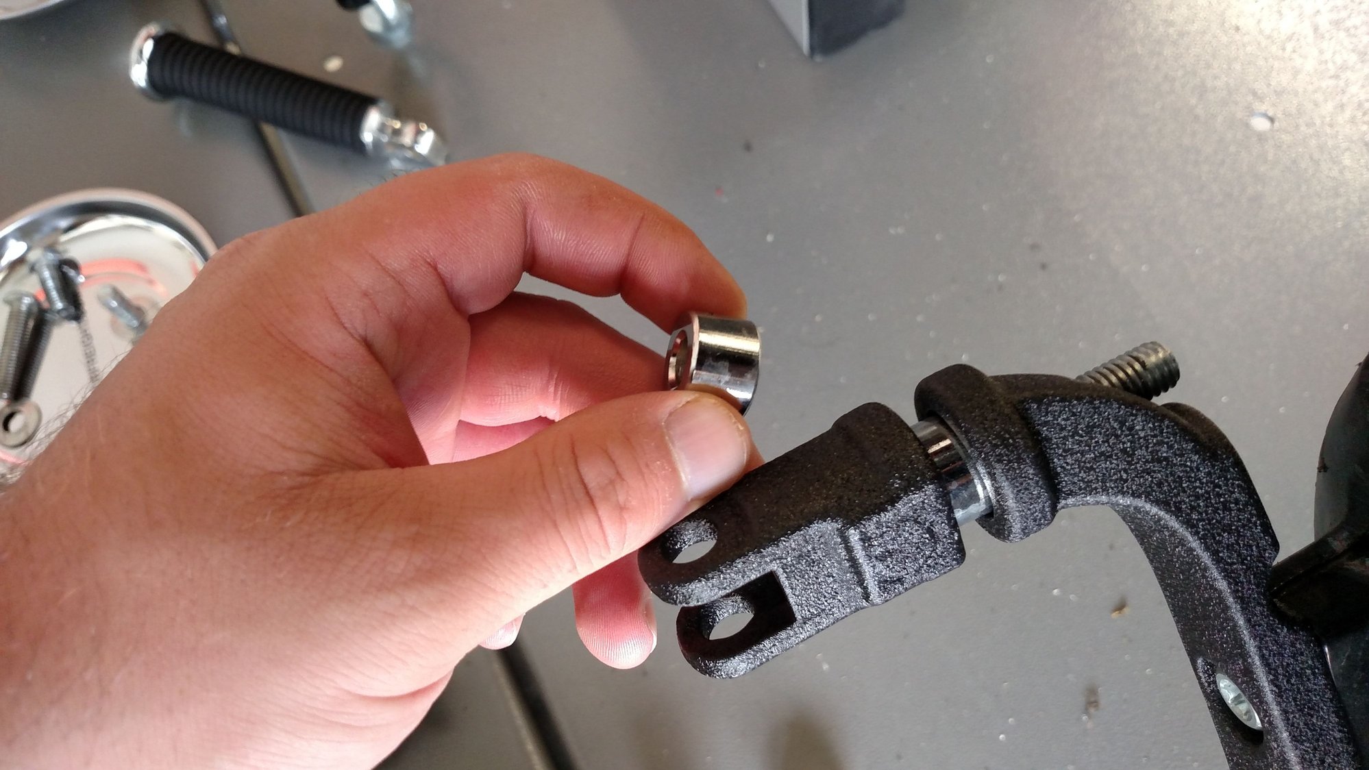

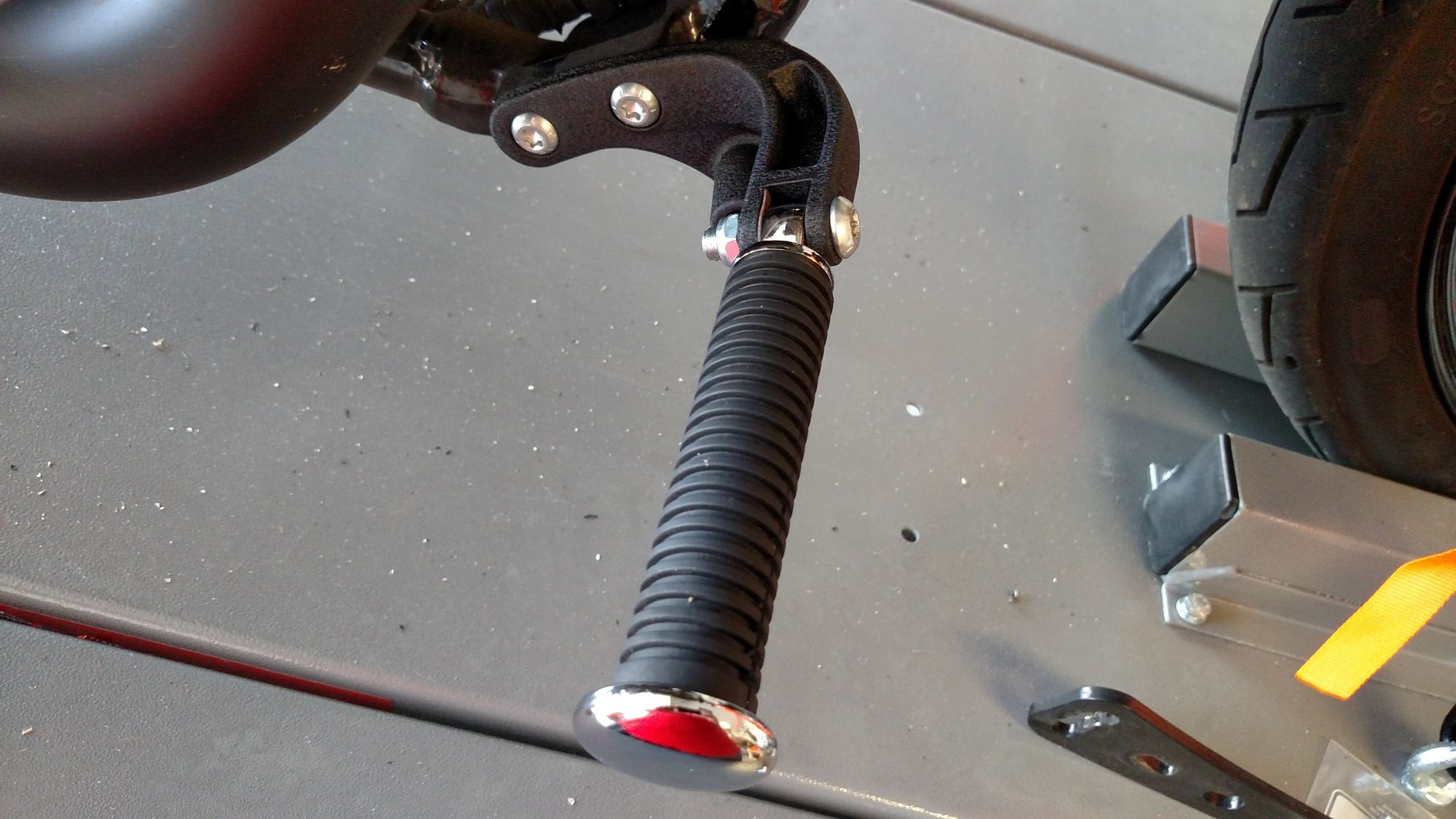

Well, I got it done. I've only done about 55 miles with them on but am very happy with them so far. I feel like its a very natural postion. My legs can actually relax with my feet on these pegs. On the left side peg I had to add a 1/4 inch spacer to fill the gap where the shifter lever should be. The right peg hits the header on my pro pipe when folded all the way up. Only downside, just have to be careful.
http://partsfinder.onlinemicrofiche....AND%20FOOTPEGS
Here are some pics.
