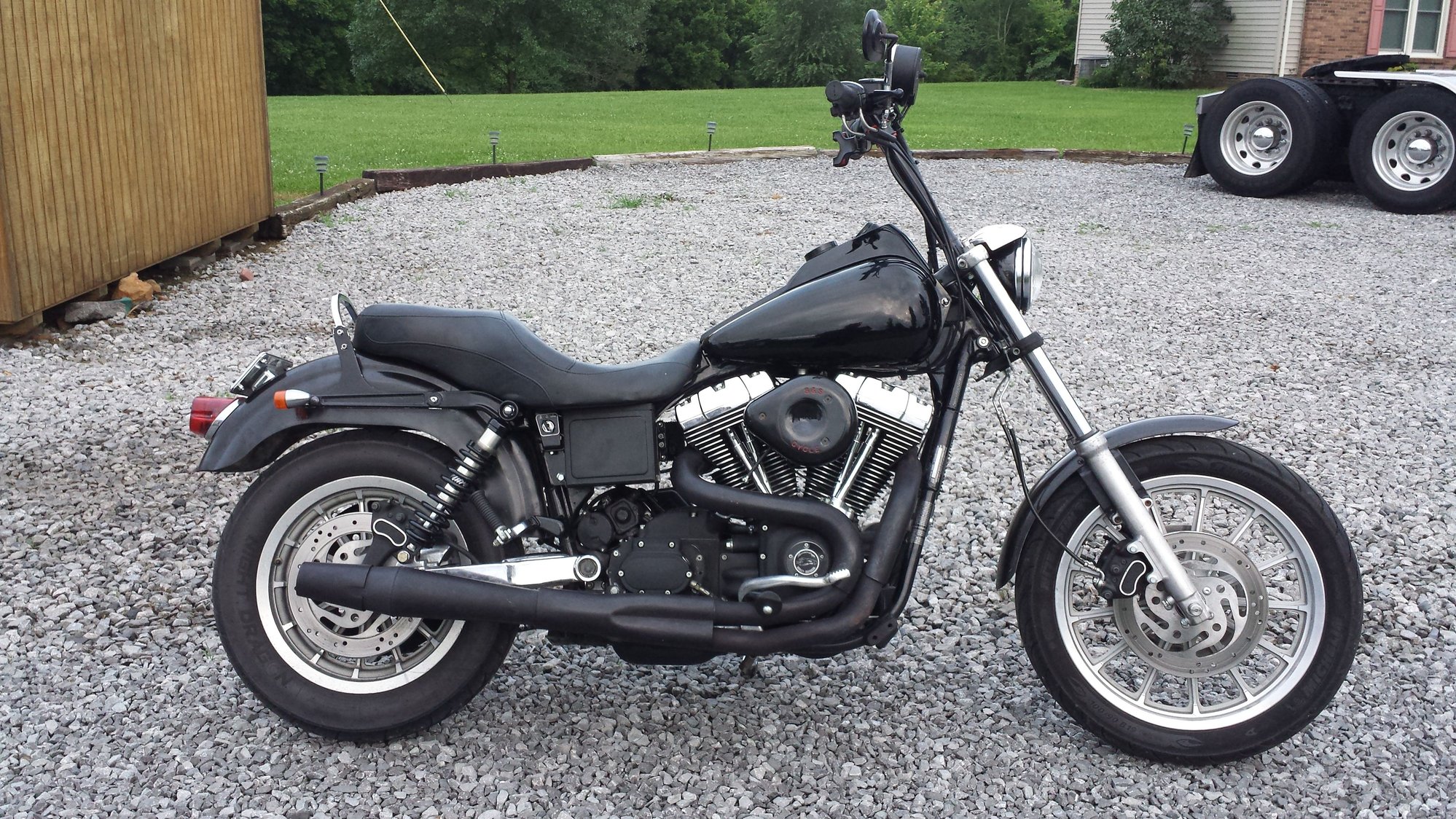

It has been my experience that 2 into 1 pipes make more low end torque than any 2-2 pipe. Each pipe helps scavenge the exhaust out of the other. I also don't like the equal length head pipes. That is why I went from a pipe with equal length runners to a RB racing LSR.
http://rbracing-rsr.com/
I like this pipe much better than the previous one.
