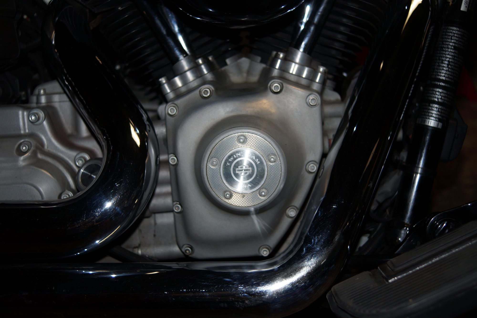

Almost looks like I can leave my exhaust alone.<br/>Getting itchy fingers, Still waiting for lifters.

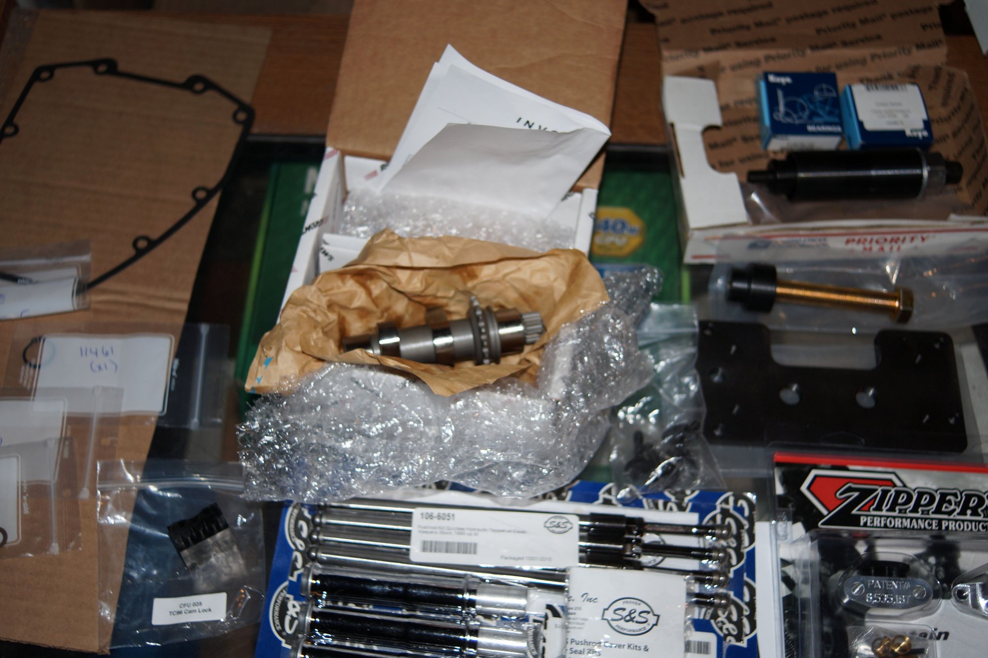

Happy Birthday to me!<br/>piece by piece coming together.

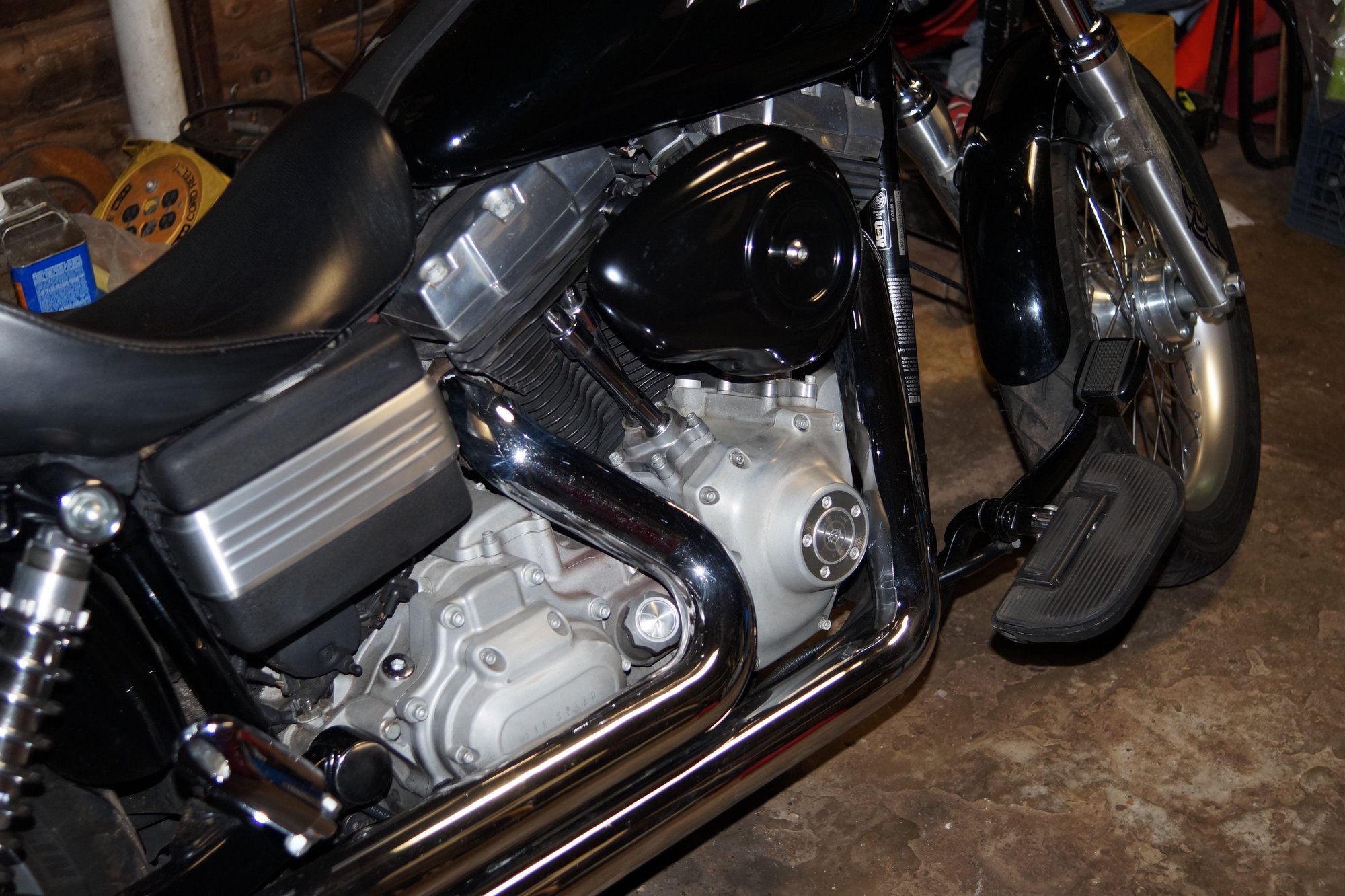

Convenient exhaust.

Looks like you're all set Stilup! This is actually one of the most rewarding mods to do on your bike, because the payback is sweet
Might as well get the heads ported and 107 that bad boy while yer' at it

CAMSHAFTS ASSEMBLY
Part Number
#8 1 pc O-Ring (Cam support plate) 11293
#9 2 Pcs O-Ring 11301
#14 1 Pc Cam Cover Gasket 252244-99A
Part Number
#33 2 Pcs Lifter Cover Gasket 18635-99B
Zippers dual piston cam tensioners with Axtell Bypass Valve # 425-103
S+S Quickee pushrod kit. 106-6051
Andrews 48H Chain Drive Camshaft 216348
Cam Bearings E-Bay KoYo full rollers B-168;PB;L125
Cam Bearing E-Bay removal and installation tools
Cam Locking tool E-Bay
S+S hydraulic tappets 33-5350
Permatex Ultra Slick Assembly Lube

You can get away with only removing the exhaust pipe for the front cylinder (bottom pipe). I was able to install my cams this way with Short Shots. Looks like your pipes take same path.
