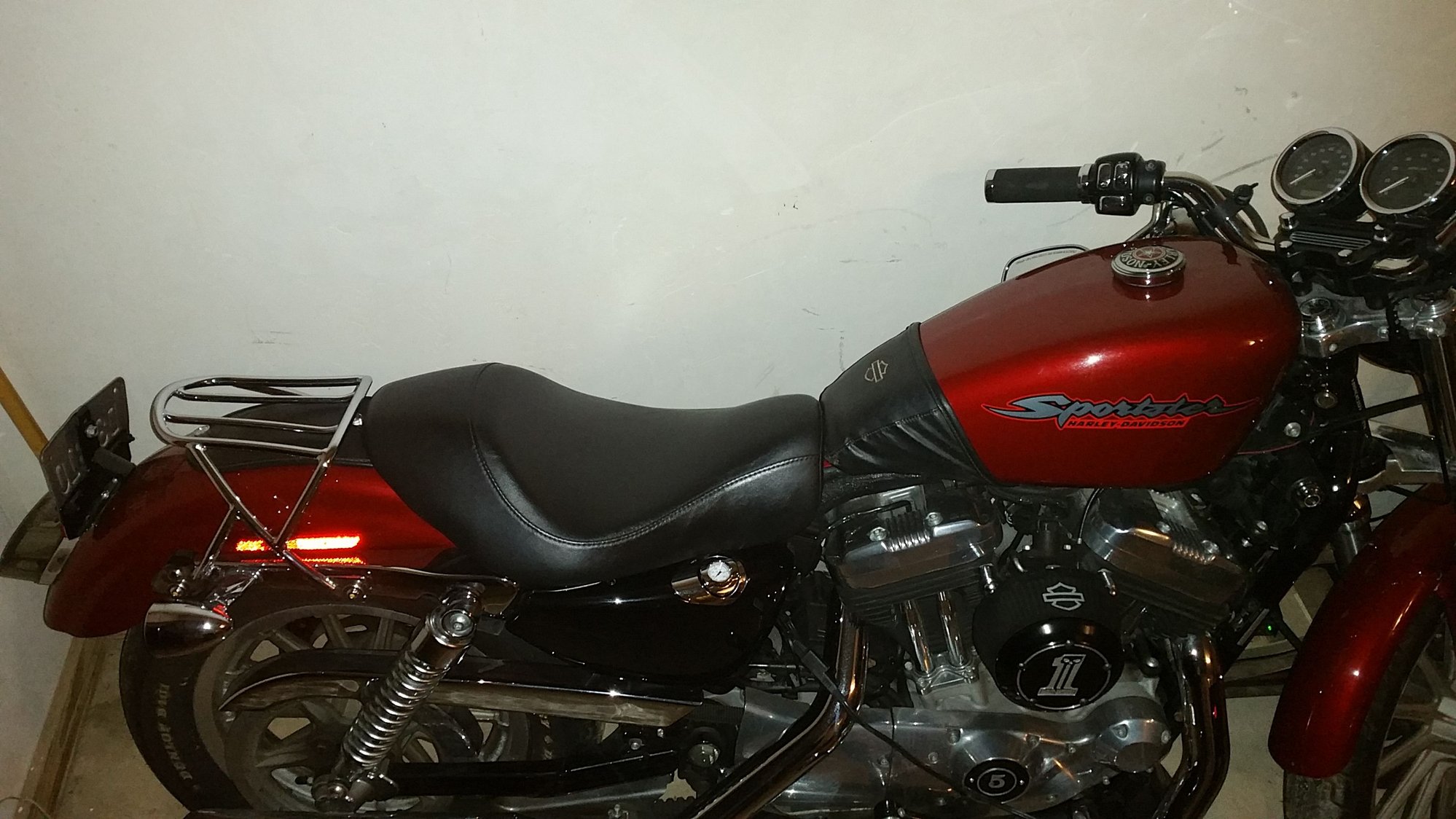

Originally Posted by lemmeouttathiscage
Excuse me Cvaria,
May I ask what that is on your Tank? I would love to have one for my bike. Thanks in advance !
B. Rasor
looks like a tank bra to me, they're wonderful at scratching up your paint and thats about it.
Old Nov 15, 2015 | 05:16 PM
cvaria's Avatar
cvaria
Posts: 12,367
Likes: 2,215
From: Tallahassee, Florida
Im gonna say no, that's not true. What you did with yours is your own business, the hd ones have lining where the leather meets the paint to PREVENT paint scratching. Have had one on my sportster for years. NO SCRATCHES. Kept my jeans from nashing the tank.
There's always "that guy". Why be that "that guy"?
I dont like to be "that guy" but I think they truly do scratch. While yes it wont be serious scratching there will be some swirl marks and possible rub marks that when the bras are removed will need to be polished out if you want perfect paint. I'm pretty nit picky about paint and stuff being on my paint as an amateur auto detailer. I see a tank bra and other fender bras, etc and I know they have a fleece backing to prevent scratching but that doesn't matter when you ride and dust and road grime gets trapped between the bra and paint... any little movement will make swirl parts, because you're basically dragging micro sized rocks across your clear coat. Which you may not care about swirl marks and be perfectly happy with how your paint looks with and after having a bra on it, but I wouldn't be happy and I'd get to work with a polisher. From what I see with the pics of your bikes, they have a small extent of swirls over the tanks anyways so a bra may not make it any worse, and by all means if you're happy with them now go for it. But I can tell you any detailer or somebody who really cares about their paint wouldn't be happy with swirl marked paint. Just look next time you're around some cars at a stop light and most of them will have some extent of swirl marks, which people are OK with having. I was just giving the guys a heads up that they will scratch.
Old Nov 15, 2015 | 09:00 PM
cvaria's Avatar
cvaria
Posts: 12,367
Likes: 2,215
Thumbs down
Just stop. while both are dirty, there are no scratches on either bike other than around the gas cap on the sporty from me repeatedly wiping off the gas spray/spills. what you are doing is talking out of school.
respectfully give it a rest and stop being 'that guy' and ruining a productive thread with your ocd opinion
