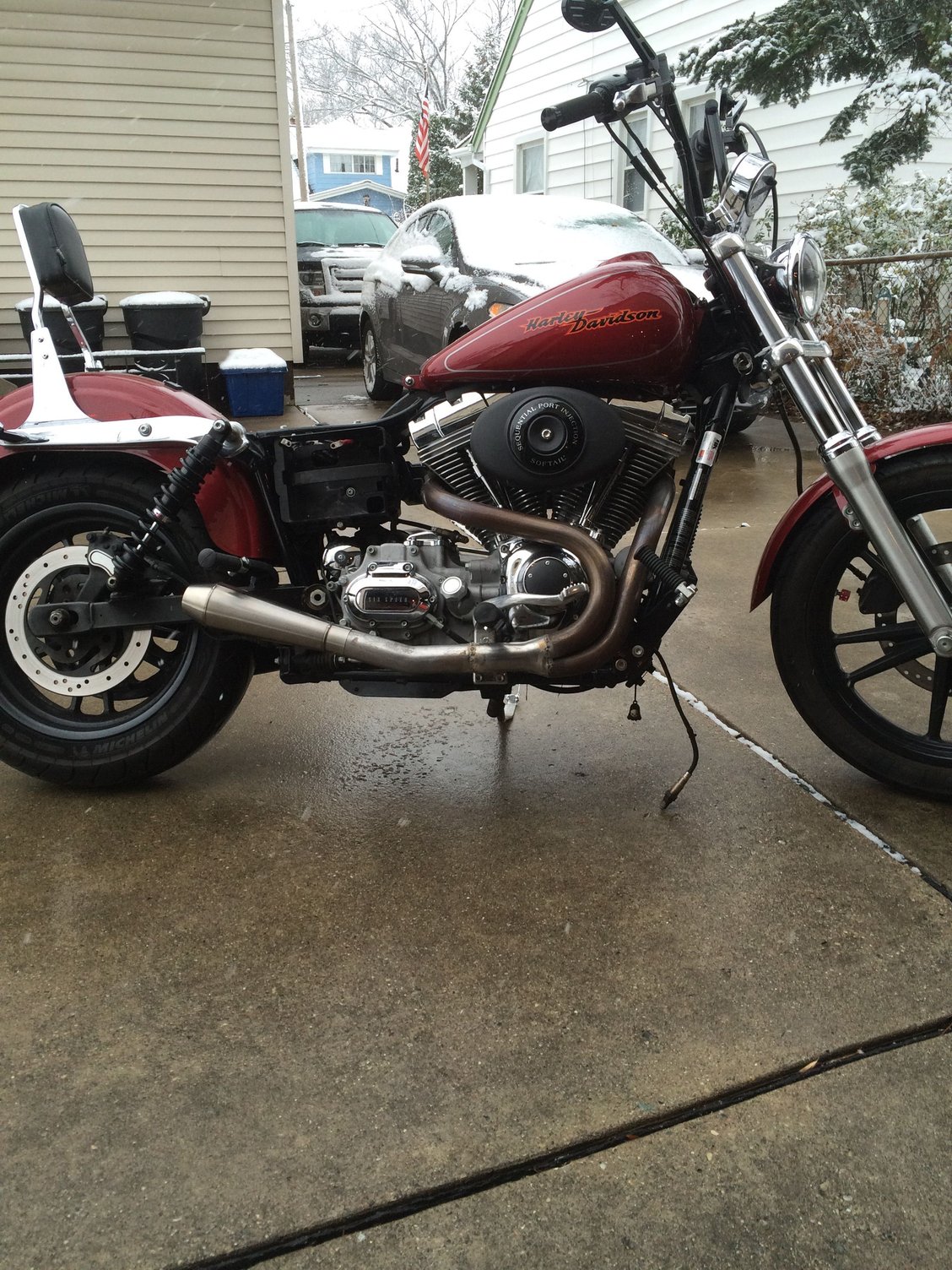

Old Dec 7, 2015 | 10:42 AM
BIGDOGOH's Avatar
BIGDOGOH
Joined: Nov 2015
Posts: 36
From: central ohio
I also have Progressive 444 I am very happy with them great upgrade to stock.
Attached Thumbnails 2006 FXDCI Super Glide Custom shocks suggestions.-img_2816.jpg   2006 FXDCI Super Glide Custom shocks suggestions.-img_2822.jpg
