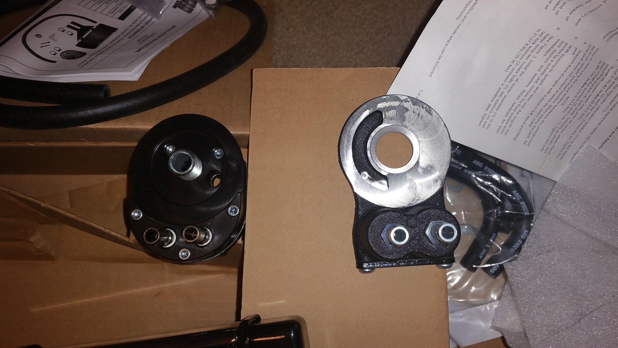

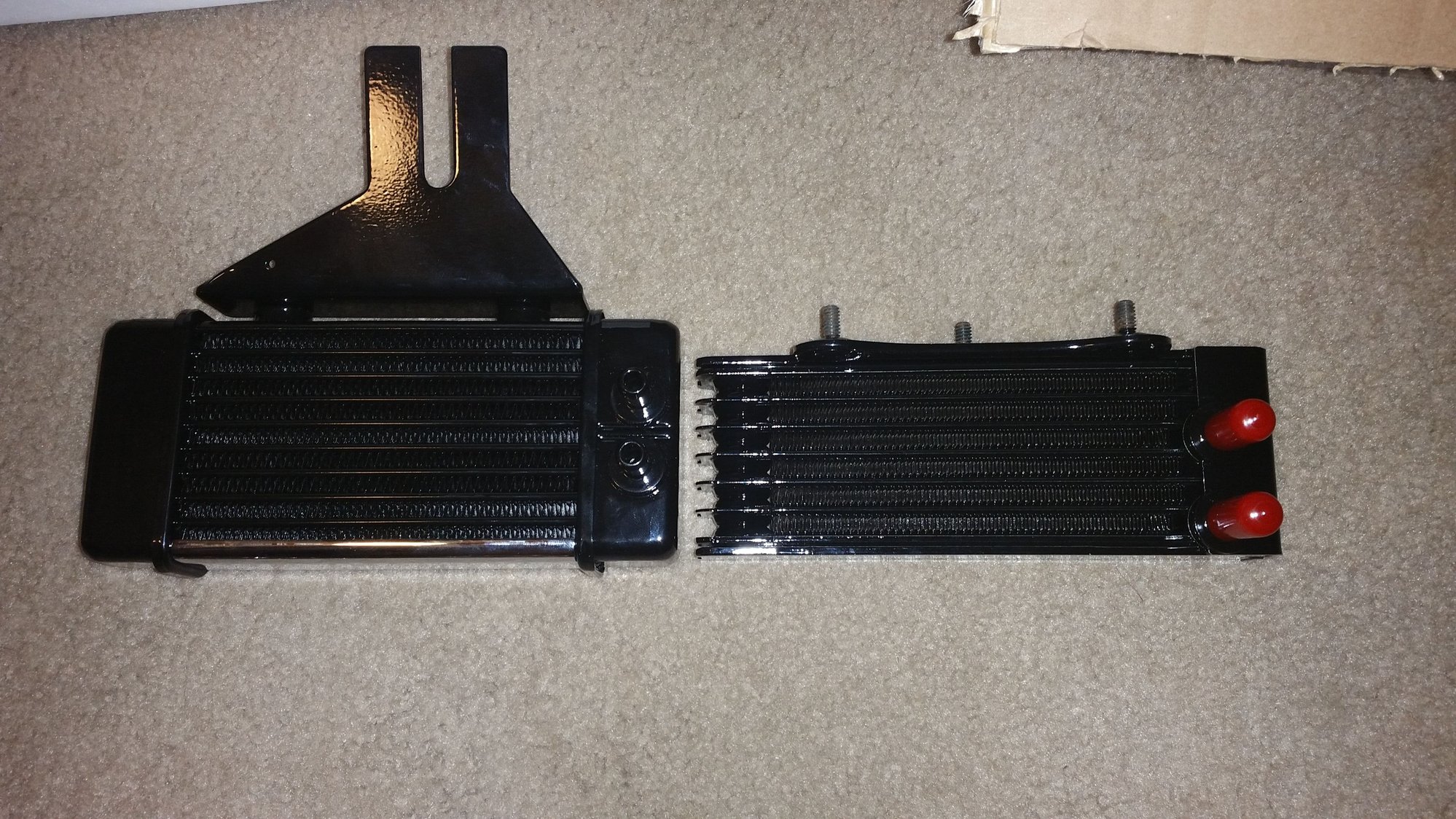

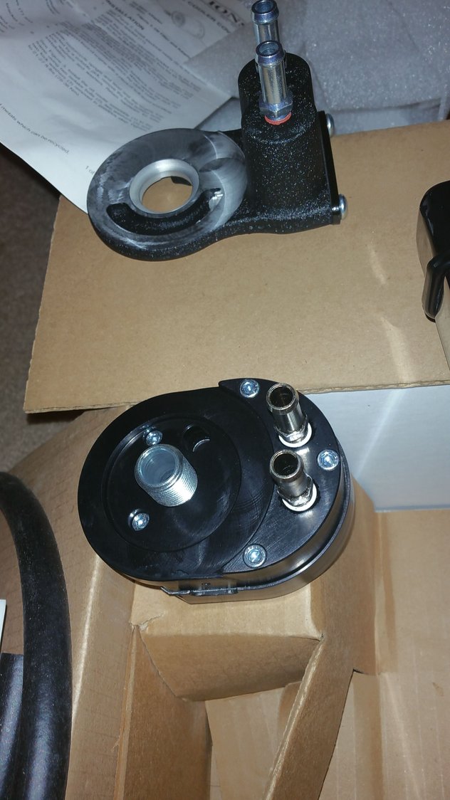

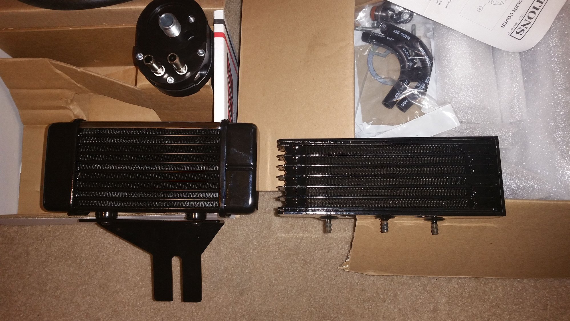

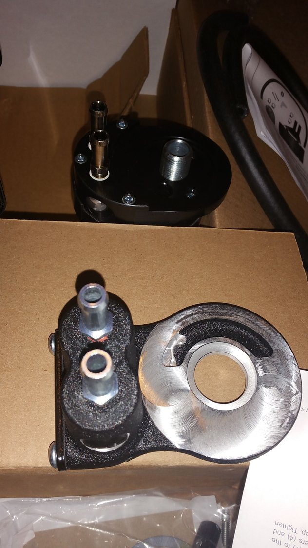

Just taking the opportunity to post photos of both units while they are in the same place.
